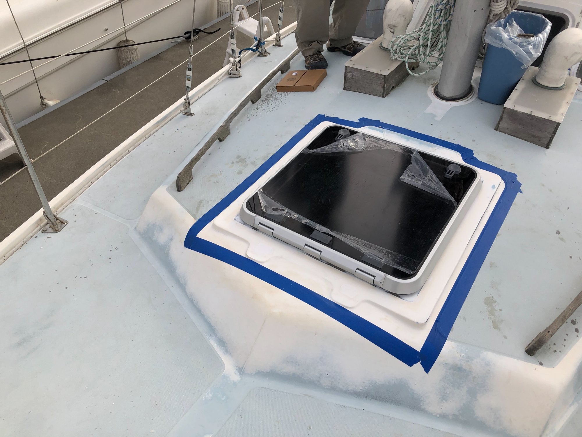

It is an old thread @JK_Boston_Catalina310 but an interesting fix. Having just installed a Lewmar hatch on my boat last week... I will keep the Butyl idea for possible future leaks. I did take the hinges off and there was the same foam gasket under the hinge on a new hatch.
We used butyl to seal the hatch to the deck. So far after the rain from the weekend storm. No reported leaks.
That is the butyl tape Bed-It Butyl Tape box at my foot. Love that stuff.

23,640
I could not through bolt in all of the holes. SO I through bolted in 4 of the slots along the hinges and 2 bolts on the opposite side. All others were screwed into the wood deck (plywood in my case). Counter sinked the glass, and put a cone of Butyl on each screw before I screwed it in. I also laid a thick layers of butyl all the way around the flange. So far no leaks reported during the first night of rain.
