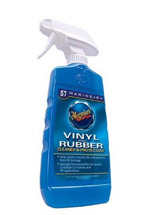

Solved the problem temporarily by quickly wiping down the problem areas with acetone :eek: :eek: :eek: and then immediately wiping down with Meguiars Vinyl and Rubber Cleaner and Protectant. I'm sure Armorall would do the same thing.
Used to do this at the end of the year when the dinghy was cleaned up and coated with protectant. Not a permanent fix, but quick and easy.
