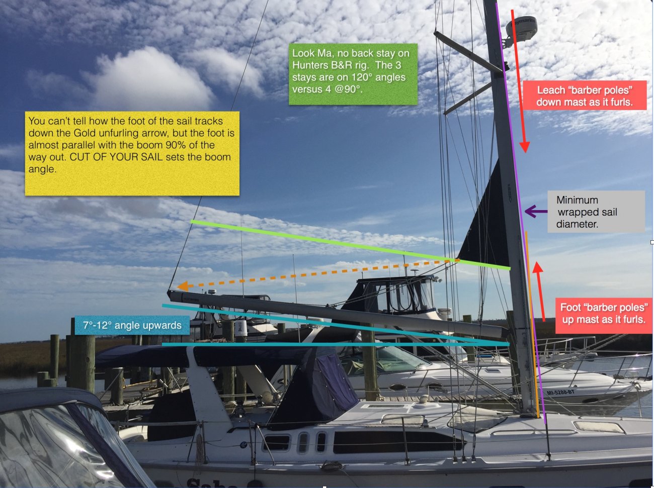

The foot of the sail should be cut so it’s about about 85 degrees to the luff
:plus::plus::plus:
It is the cut of your sail that makes the difference.
I did this picture to show my Sail was cut about 86° angle and had to lift the boom ≈ 4°.
Also on that picture, I drew a purple line from mast top and an orange line from deck to show prebend.
The prebend compensates for the headsail pull.
Jim...
PS: Correction by @DrJudyB in her post below for my H430.

@JamesG161
I think there's an error in the method you used to estimate the foot angle on your mainsail. Perhaps you didn't compensate for foot round. but there could be a different explanation. If you try it again with the sail all the way out, Ill bet you a beer that the boom angle is around 85-87 degrees.
:beer:
I win a lot of virtual beers via bets on sailboatowners.com. :biggrin:
The angle of the boom (and the tack angle on the sail) forms an 86 degree angle on your H430. Take a look at the sailplan drawing in the owners' manual.
https://www.marlow-hunter.com/wp-content/export/Owners-Manuals/430 Owners Manual Complete .pdf
We built a ton of mainsails for in-mast furling, to fit rigs from Selden, Zspar, Charleston Spar, etc. I can assure you that not a single one had a tack angle that was even close to 80 degrees.
Mine boom angle is set at about 7° as shown in the picture, but I responded with that picture for many to use.
So you will win that beer. Hic hic hic...:beer:
But I did that to show why prebend in my ZSPARS mast does NOT foul a new main.
My annual problem is "mud daubers" deciding my furling is a nice home. As a matter of fact we got them "broken" up on Saturday sail. Pain in butt, but water flushing them doesn't work on them.
___
You were POINT on about the Sail Cut!!!!!
Just thought my pictogram might help with why the boom is raised up.
Also there has been an argument about prebend. I still have an inch space when furled in my mast with prebend.
Jim...

3) Release Boom Lift... do you mean Topping Lift?
I meant Boom lift line on my boat. I set mine as shown in the picture, always there.
I really never use mine, but the Previous Owner used it to act like a hoist and lower the deck inflatable dinghy in the water.;)
If you call it a "topping lift" then I am ok with that term.
Once you set your angle, like I do, and do steps 1 and 2 then the Boom "floats" and you can't force the foot of the sail to wrap incorrectly.
My boom vang holds the boom down.
Jim...
