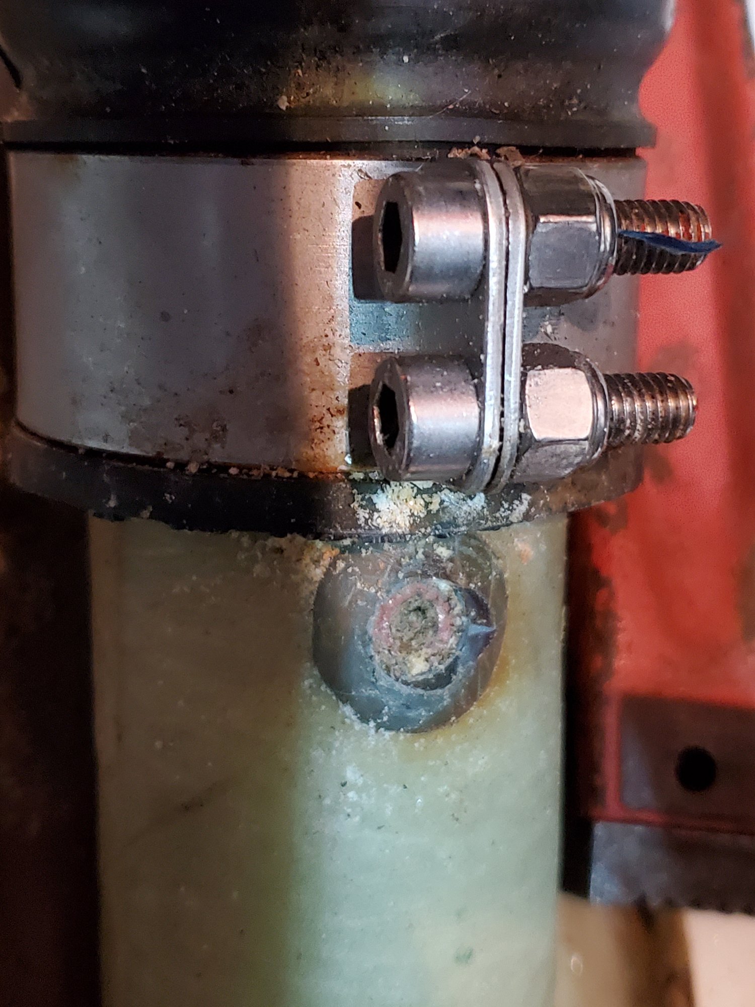

Hi All,
I think this might be a fairly common problem. Today the bronze threaded hose barb venting my stern tube popped off. Lucky for me the boat is on the hard and I discovered during some other maintenance.
How difficult is it to get the rest of the fitting out of the stern tube? Drill it out, other methods? I assume I can leave the prop shaft in place. The fitting is also quite close to the Volvo mechanical seal. Assuming I can just loosen the stainless clamp and slide forward an inch or so. See pics
Have others replaced the threaded hose barb with bronze or plastic and if so how are you securing this in place - with epoxy or fiberglass. I don't think I want this to fall off again.

You should be able to remove the broken piece of nipple from the shaft log with a screw extractor. Buy a set so you can
fit the best size extractor to facilitate removal. Extractor sets are available at Home Depot, Lowes, Harbor Freight, Amazon, etc.

Also, it is not the same size; therefore, you will have to tap the hole to the size of the nipple and build up an epoxy fillet
around the new nipple. I purchased one and was not satisfied with the quality; therefore, I didn't use it.
Another option is to wrap the stern tube with a piece of roving tape about 2" wide and glass a few wraps of the roving to
build up the thickness of the tube. Then buy a 316 SS nipple of adequate thickness and size that you desire (doesn't have to
be 1/8"), drill & tap, and install. This would allow you to either remove and inspect on haul out or replace as the cost of the
SS nipple is negligible.

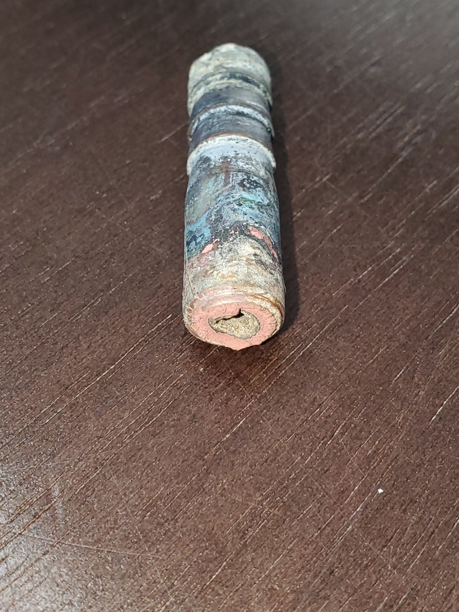

I don't think it's a good idea to wiggle it, because you make weaken the thin shaft log, disturb the epoxy fillet around the nipple, or break off the nipple. Then you are looking at a haul out to repair. On scheduled haulouts, simply cut the rubber hose at the top of the nipple and unscrew the nipple to inspect. Clean it out and inspect, if it appears to be in good shape, put some Teflon plumbers tape and a bit of 4200 the threads and reinstall. An advisory from Beneteau from 2012 recommends annual inspection.
I have read that in a few cases, the nipple broke off while the boat was unattended , causing the interior of the boat to flood.

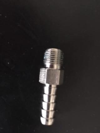

You should be able to cut hose atop the nipple several times over a few years as you are only losing approximately 1" of hose when you inspect the nipple. When you do eventually replace the hose, purchase it longer than necessary to allow for future inspections. There are no lugs on the nipple for a wrench to engage, so use vise grip pliers or channel lock (water pump) pliers to remove. Simply reattach the remaining hose with two hose clamps and that's it. Blue, with the vintage of your 331, I would definitely remove and inspect while you are on the hard and have a plan formulated for replacement as yours is overdue for replacement. I have attached a photo of 316 SS nipple that I purchased from Mc Master Carr. It is 1/8 NPT x 1/4" hose. You would have to retap the hole in the shaft log and build up the epoxy fillet to accommodate the new nipple. Round off the lugs to enable you to remove it in the future without breaking the epoxy fillet. If you decide on this option, it would be advisable to build up the FRP shaft log with roving tape & epoxy to make the entire assembly stronger, before retapping. Just some ideas here, instead of paying $200 for the OEM part from Europe.

Bought mine from amazon 25 of them for 30.00
Should last for a few years!
Again, really chafes me that Beneteau USA will not have the OEM fittings manufactured and make them available to owners at
a reasonable cost.

BigEasy,
Is that a picture of the OEM fitting? The threads are mush smaller and don't looked tapered. It does look like a simple part to make.

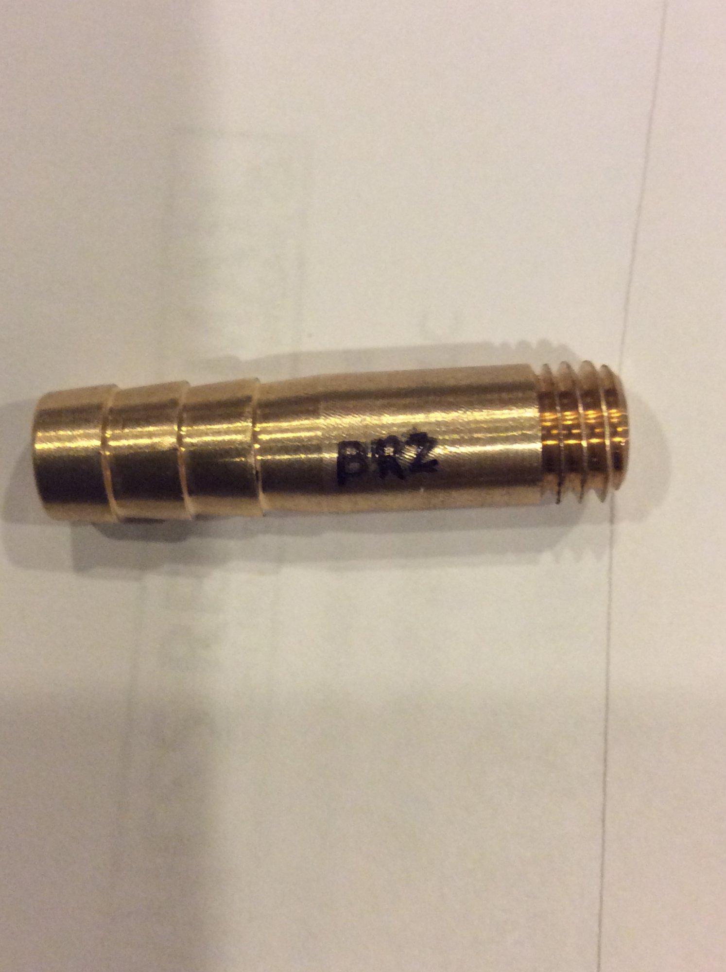

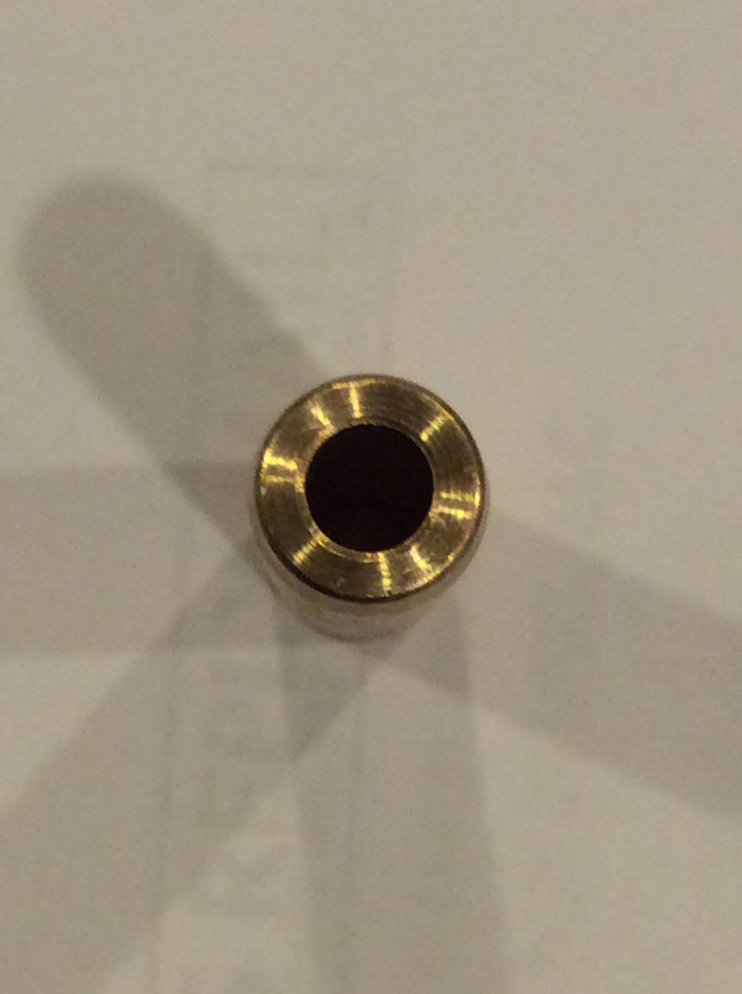

BigEasy,
Bob,
The photos in post #3, show the bronze OEM Beneteau nipple. Agree,
Shouldn’t be too difficult for a machinist to fabricate.
