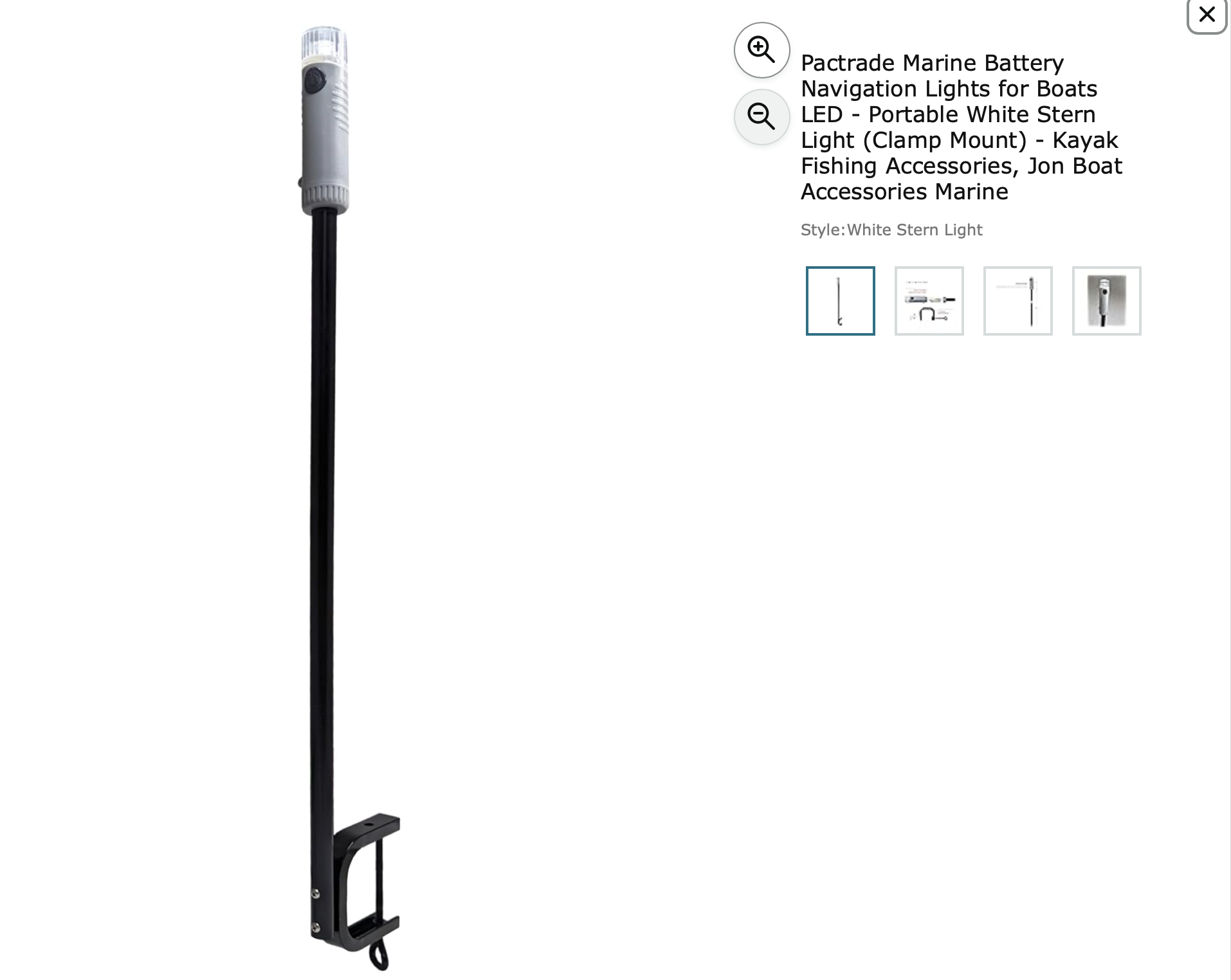

Until you fix your Stern light use this...
or just a light on a stick.!!!!
