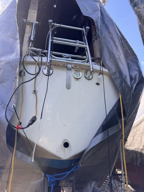

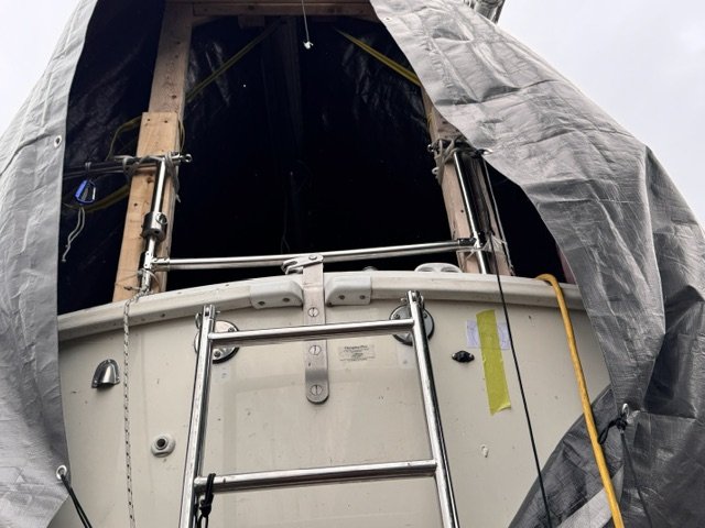

We are trying to make the stern top panel more user friendly when boarding the swim ladder, our stern light is right where we can step
so we were thinking of replacing it for a transom mounted one.
now the question, does it have to be centered of can it be mounted about a foot to the starboard position?
I cut out the template for it and put it where we think would be best (green tape)
What do you think?
in the center there is the backstay chain plate, so I do not want to weaken that area

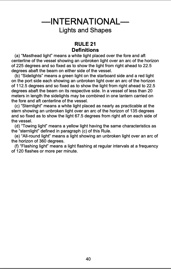

The CG has a statement about this.
(c) “Sternlight” means a white light placed as nearly as practicable at the​
stern showing an unbroken light over an arc of the horizon of 135 degrees​
and so fixed as to show the light 67.5 degrees from right aft on each side of​
the vessel.​
Found at this site Rules20-31.pdf

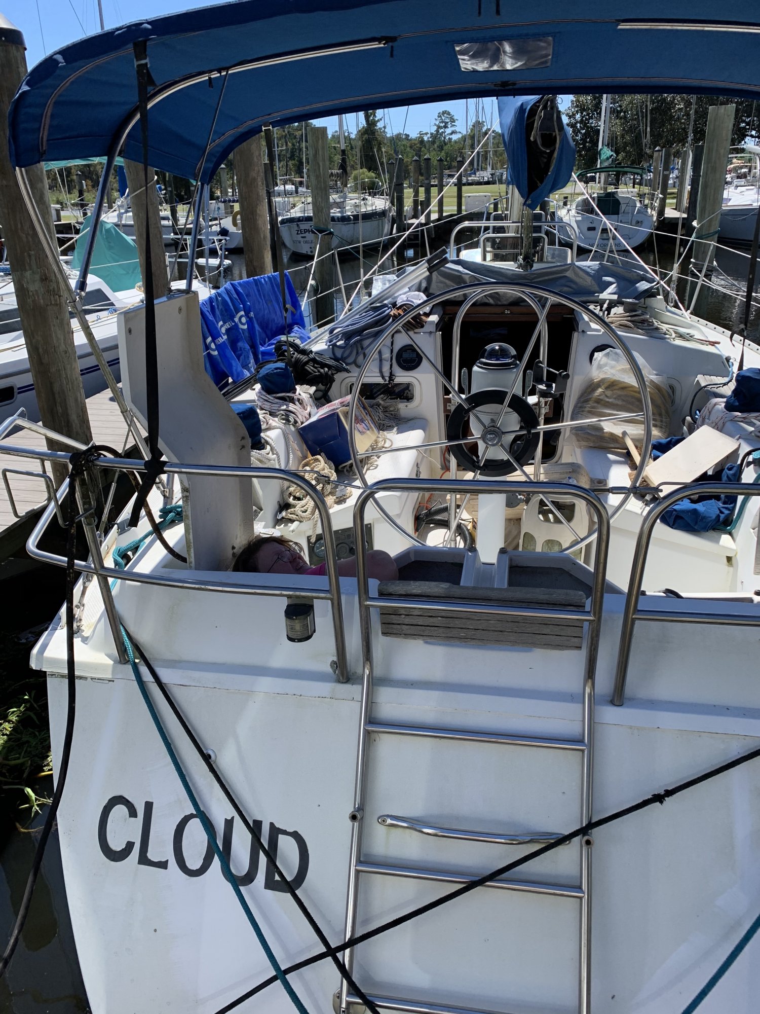

My H-34 has it on the stern stanchion just to port of the swimladder opening.. you could put it on a bracket on your starboard stanchion just above the tape line. The regulation states that the stern light throw an unbroken arc of 135 degrees, white light, dead astern. The swimladder would interrupt the arc of light if the light were to be mounted on the transom. Straught up from the "D" in "CLOUD" you can see the light mounted simply on a small tab welded to the horizontal rail. The wire is run through the tubing

Ok, so would under the backstay’s chainplate be too low? Or would the ladder be in the way?
dLj
Mar 23, 2017
5,255
You'd have to see but it looks like it could work. It does look a little low.
I don't think I'd want it there - but that's because I think I'd possibly hit it somehow with either a foot, or something else as I use my ladder for a lot of things. But you know how you use your boat.

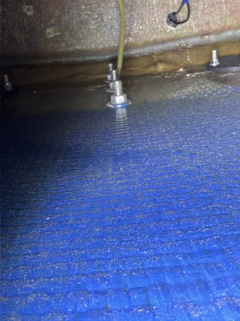

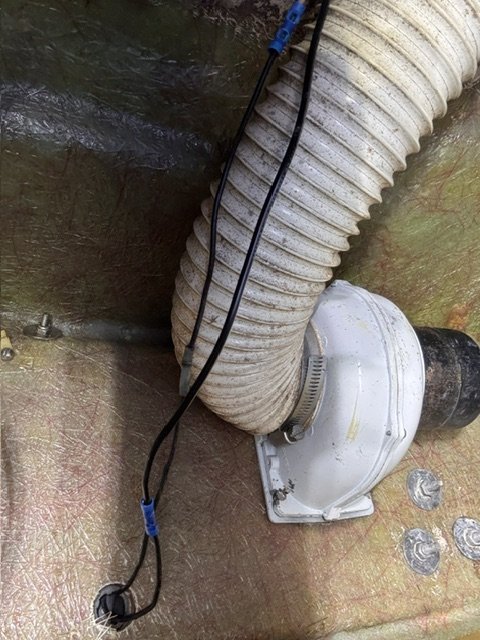

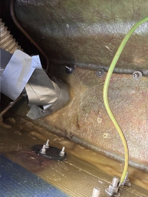

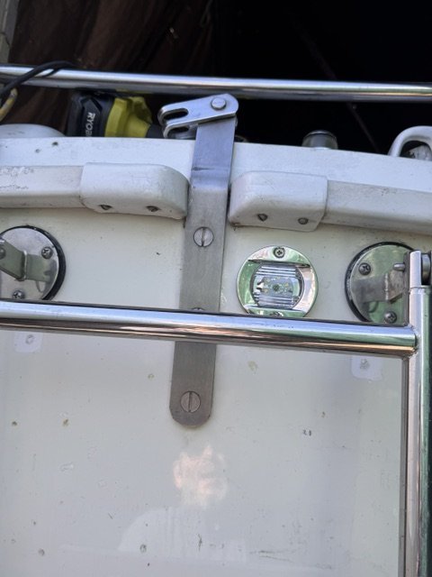

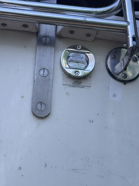

Ok, so quick update, I looked inside the stern lazarette and found there is no backing plates for the backstay’s chainplate, so it will be installed a bit to the right of the chainplate above the top rung of the swim ladder
I checked thoroughly inside and no obstruction at all, easy for the wiring as well.
Also found my blower motor
The blue picture shows 3 inline bolts, those are what hold my chainplate.
That might be concerning on a cheaper boat, but Peason was known to build solid boats so perhaps the whole transom has a lot of layers of glass.
(On our boat the center lay-up of the transom where the back stay tang is attached is measurably heaver than the outer sections in order to carry the load.) When the bolts are out for checking that SS plate for cracking, measure the thickness of the transom holes. If the layup is about a half inch or more, that's a good sign.
And it's always best to add a backing plate for stuff you later install, just to be sure. I use G10 plate for that purpose, set in epoxy mush.
