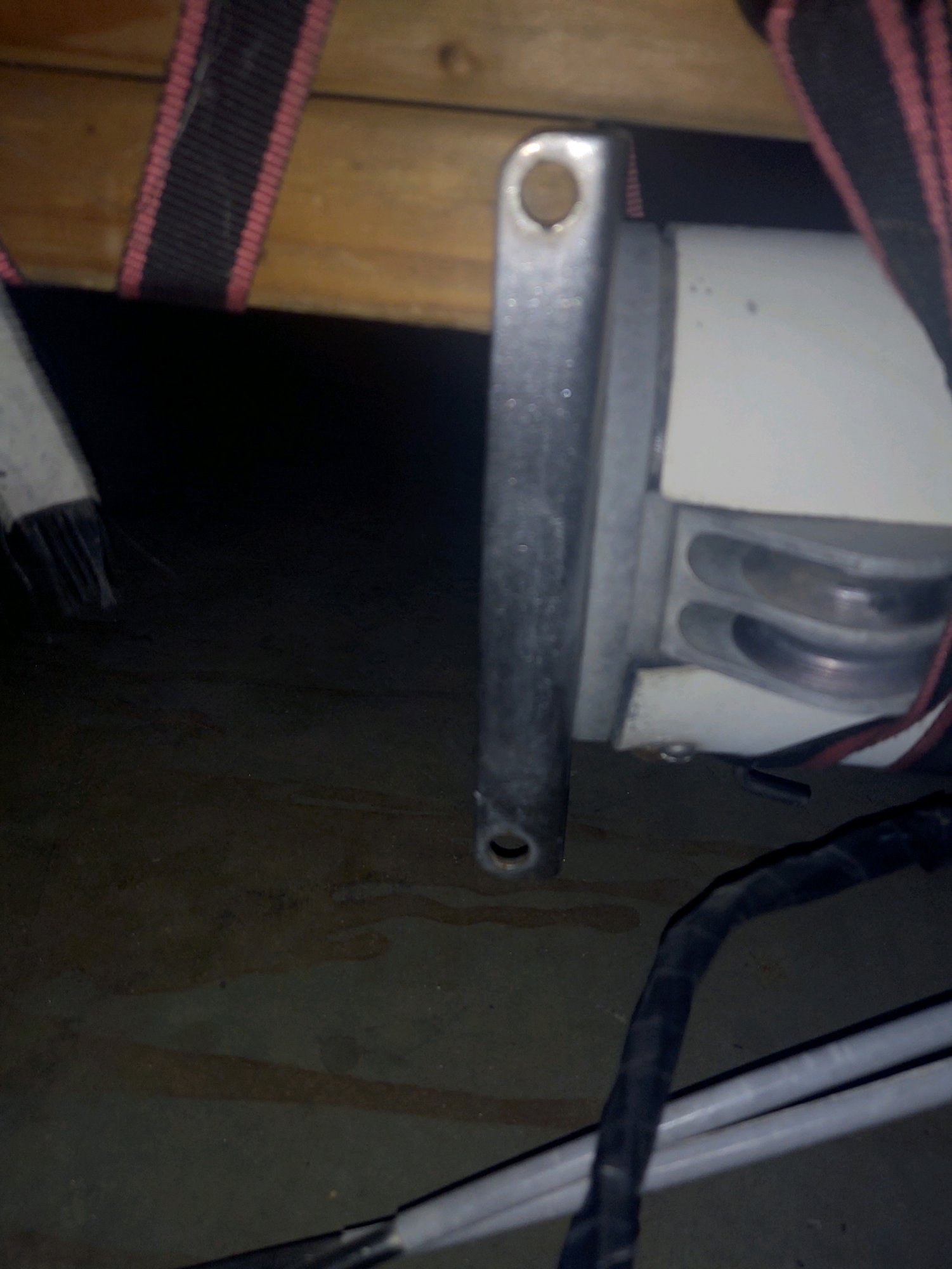

This the the bracket at mast base, I don't know how tall the Aft Crotch needs to be yet to get the back holes on mast base to align with back holes on deck base piece. Would like to know if there is someone who has done this with a 25.5? Any help would be appreciated.
Thanks, Rocky

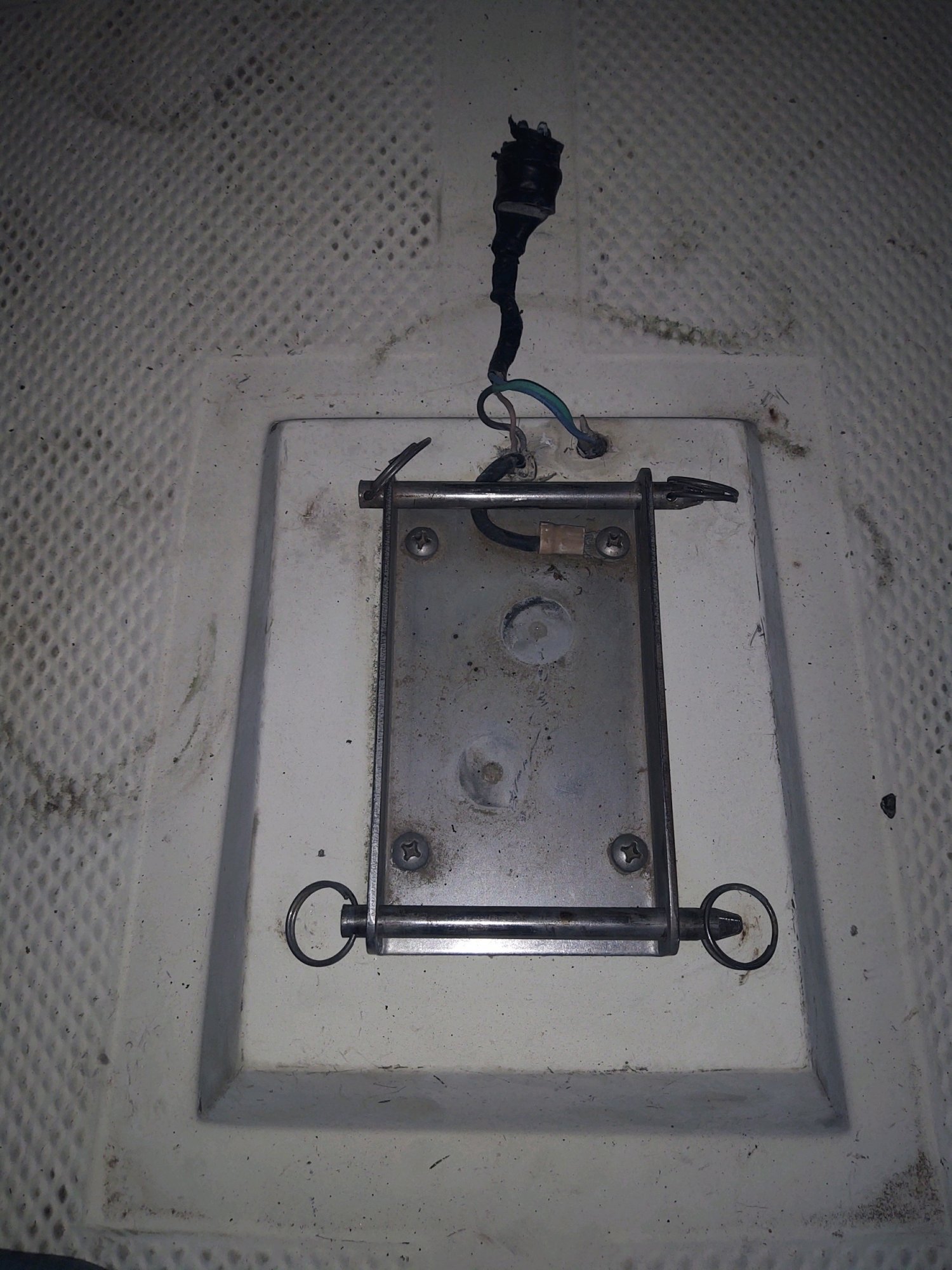

Can you snap a pic of the base on the deck?
Here is the picture of the deck mount, however I had it backwards the mast bracket fits on the outside of the deck mounted bracket !

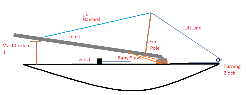

I think your plan will work. You will need to devise a "gin" pole and a way to keep the mast from swaying side-to-side while raising (or lowering). The side-sway is usually controlled using "baby stays" which are temporary lines from someplace on the toe rail to a point about halfway between the deck and the spreaders. I have used ratchet straps for this purpose with very good results on a Balboa 26.
For the gin pole... you need a way to put the pole about 6" from the mast foot and then secure the base of the gin pole to the mast. I have see people cut a "Y" out of 1" boards and screw it to a 2"x4" and then using eye straps, tied the "Y" in place so it won't slip during a lift.
You then tie the jib halyard to the top of the gin pole. A lifting line then goes from the top of the gin pole to a strong block near the bow. Then lead this back to the cockpit winch.

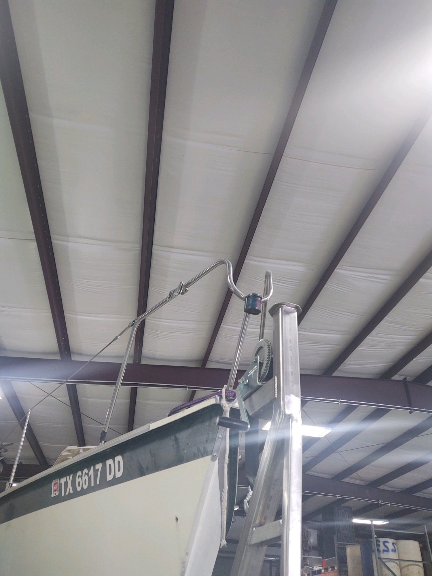

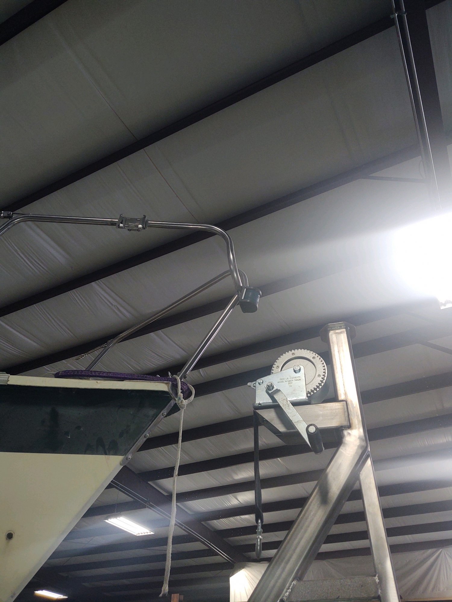

Much thanks and I have watched some videos of this but seemed that the base brackets were a lot different, but am in process of building an aluminum Mast Crotch with a roller for ease of moving mast towards the stern to get the aft pin holes lined up and pin in the bracket for pivot point, was also planning on using trailer winch to pull mast up as it is really close to bow. Your thoughts on that approach as I will be stepping and lowering mast just before launch at ramp. Thank you for the response
