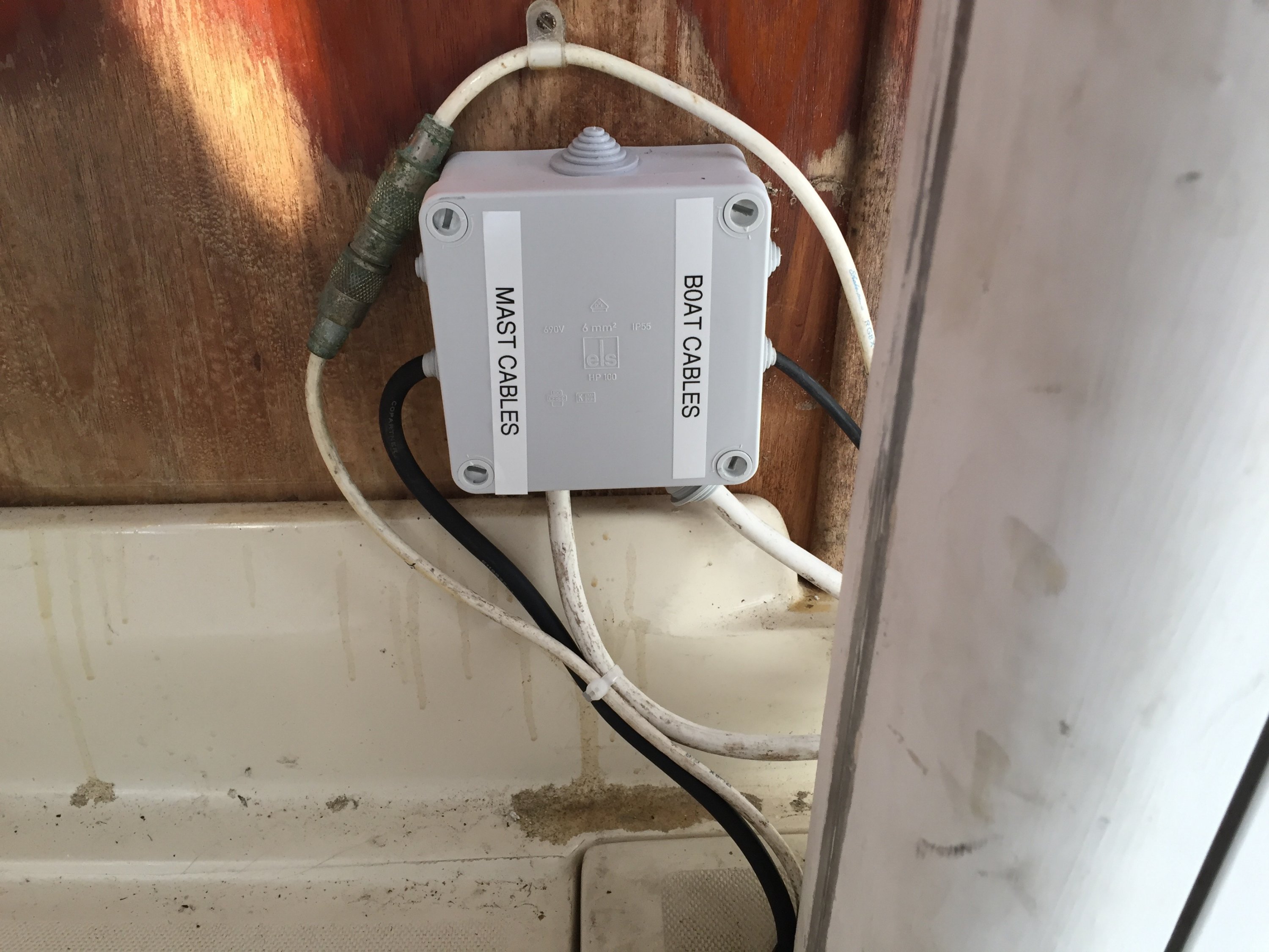

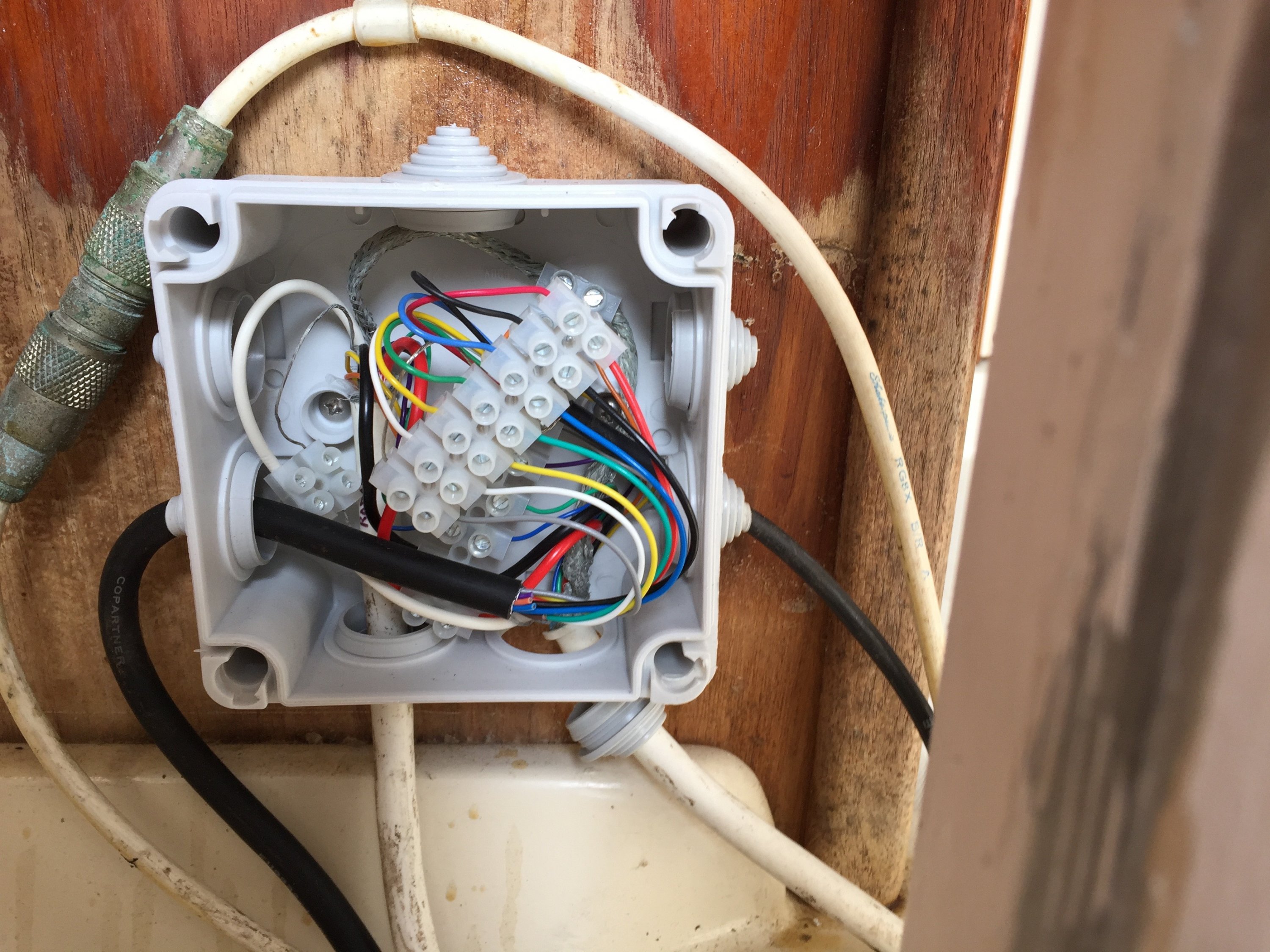

My 1980 Oday 28 will need to have the mast stepped each Fall and then the boat & mast will need to be transported to a yard storage. Can anyone provide feedback on quick connects at the mast for lighting, and Raymarine radar dome? Pics would be helpful. Also how you tiedown/support the mast for transit and storage? Lastly any winterizing trips. I live near Boston so I can't screw that up or I'll be bumming come spring.

Looks like you solved the wiring A-OK!
