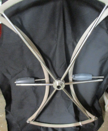

There is a solution, it's not cheap but it works. I installed one this year and it makes the cockpit a much more comfortable place to be on anchor and in a slip.

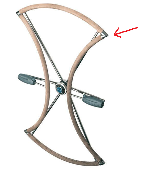

I remember when I first saw those. I thought it was a smart adaptation but the sharp corner looks like it could be dangerous if you fell against it.
