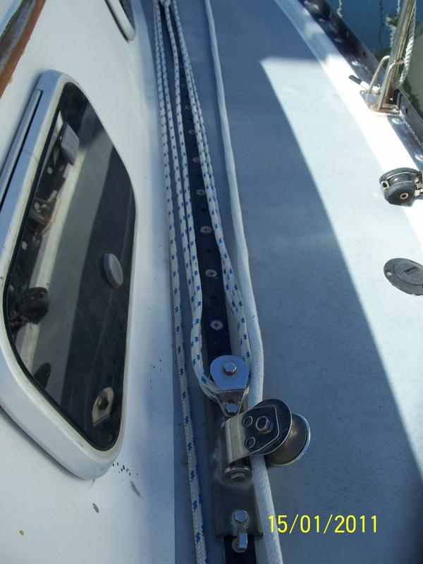

Found Blaise Pictures of his Genoa Tracks, can I continue these forward and have a decent sheeting point for Staysail? or will It have to be up on the cabin top?

Your choice is to either install the track and design the sail for it....or acquire the sail and design the track location based on the sail. But actually, if you decide what sheeting angle you want..that will determine track location... and so..I would ask the sailmaker what the optimum sheeting angle for the staysail will be. You can also consider rigging up a barberhauler for the staysail and put the track wherever you want.
Hmm.. just dawned on me that you may be able to use the staysail's existing athwartship track support... as long as your clew angle is correct (you can design that into the sail). with a single side to side track you can adjust the sheeting angle to your hearts desire....no need for a barberhauler.
