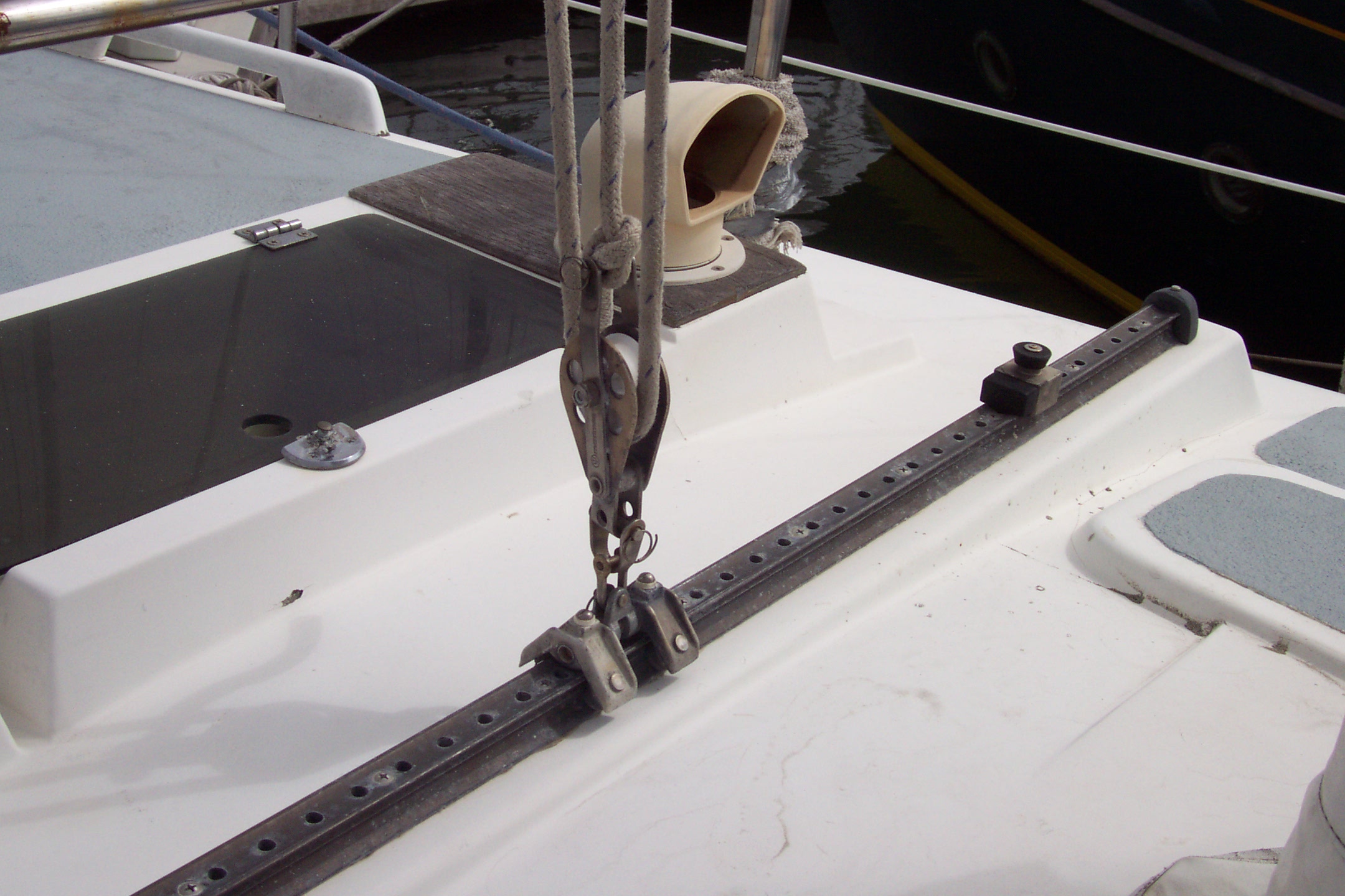

2 As long as you are attending to the car I would make an improvement over what is shown in the attached picture and provide for remote adjustment of the car position. This would greatly facilitate getting a good shape into that sail.

You could certainly use that traveller but you wouldn't use the cam cleats that are on the traveller - you would route the traveller lines back to cleats on the cabin top at the front of the cockpit.
Personally, I don't use my main traveller very much so I likely wouldn't adjust the staysail traveller hardly at all. I generally leave the staysail traveller car amidship unless I am going downwind for extended periods. YMMV
Yes, I can see the point. If you did not have the car at all, why spring $600 when for initial experience with the staysail, you could just rig it at the center.
