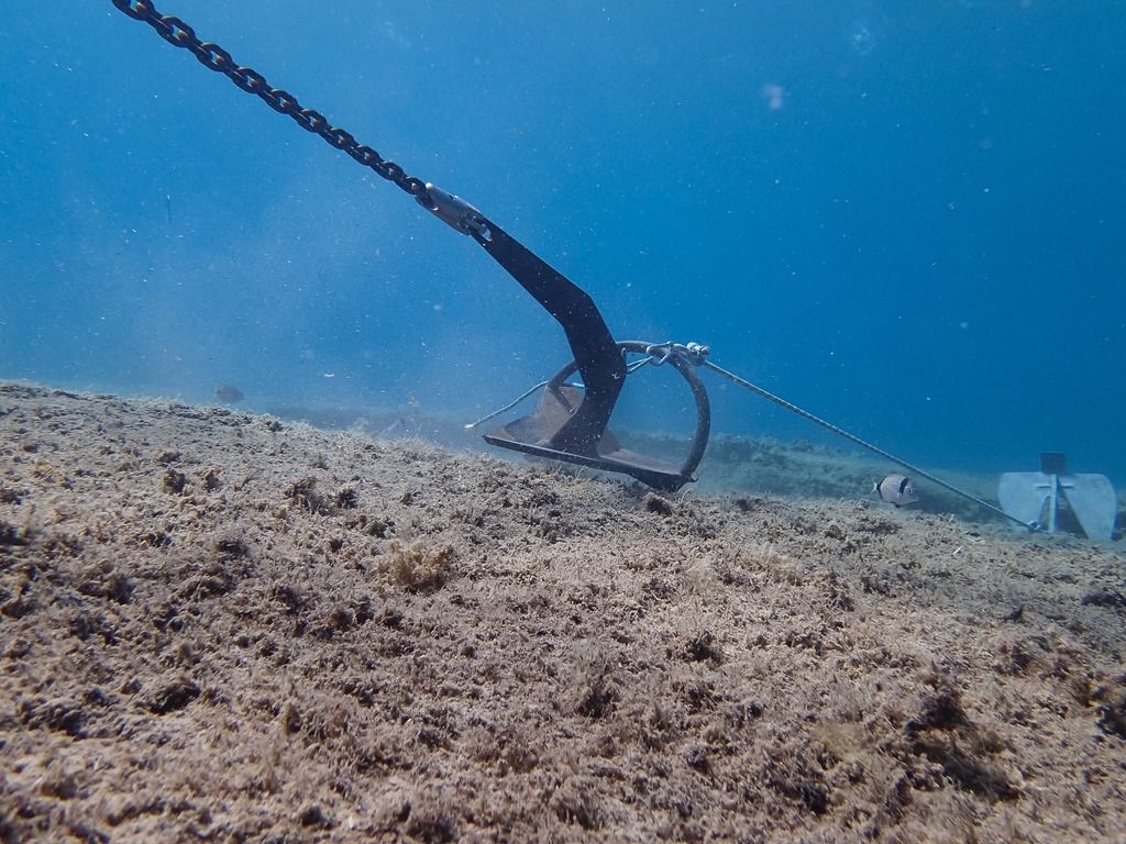

Mar 26, 2011
3,836
Corsair F-24 MK I Deale, MD
I think this image of lack of caternary really sums it up best. This was just 25 knots with a very poor execution of a tandem anchor set up. The Rocna anchor (essentially acting as a Kellet) is lifted right off the bottom and the all chain rode is drum tight..
Yup, everything wrong:
1. Secondary rode too short.
2. Secondary rode not chain.
3. Secondary rode attached to tripping eye (the Rocna has a tandem eye farther down the shank). That it is over the roll-bar with some clips is just funny.
4. Not enough scope. When anchors are hooking, even a little up-lift can make then skate off. It's not like a buried anchor, where the soil provides some down force.
Didn't really do anything right, and yet it worked. This is the sort of "success" that convinces people that they know how to anchor, because they didn't drag. This also help perpetuate misinformation.
