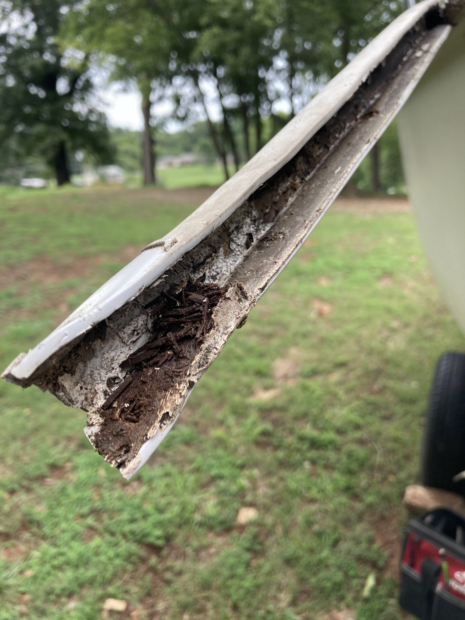

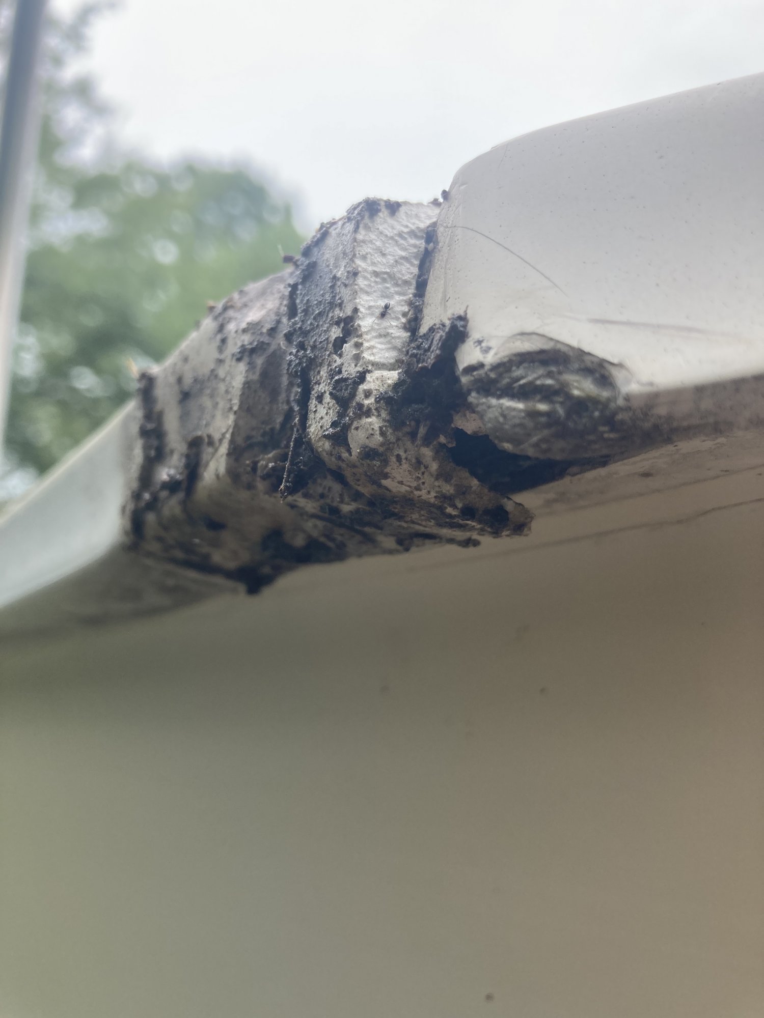

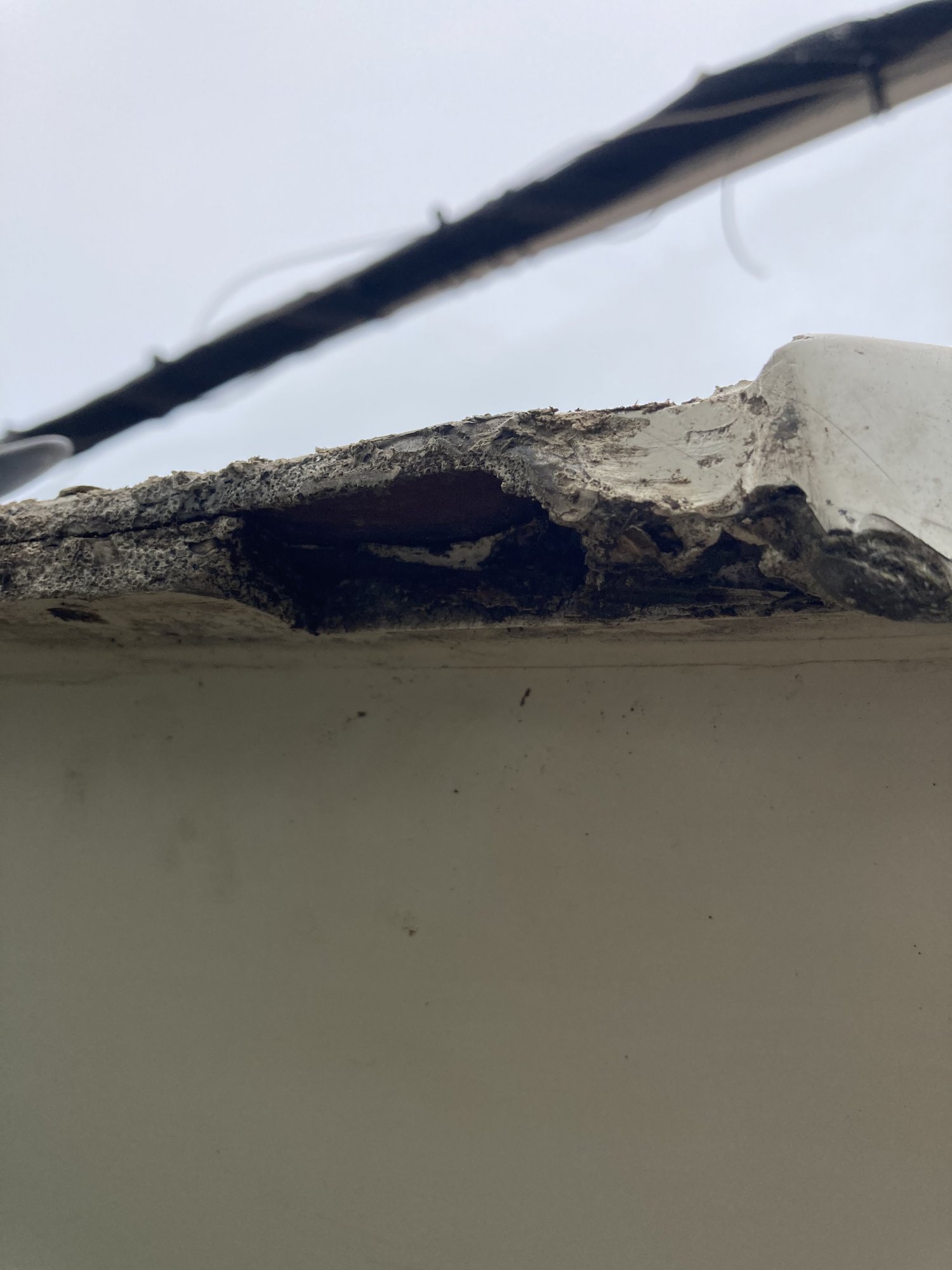

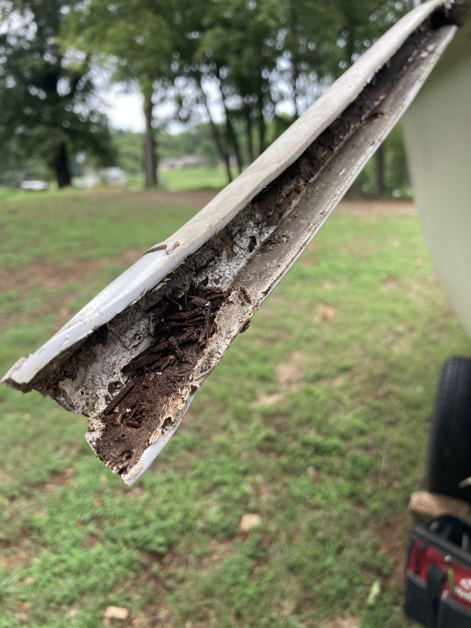

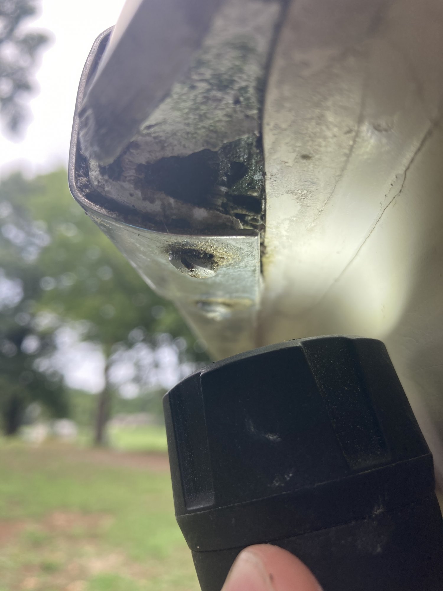

I think I answered my own question. I believe there might be a difference in design between mine (1986) and your boat. On the aft side of the boat, there’s a metal clamp that sits above the rubrail. A small wooden piece sits inside this clamp which the clamp is screwed into, and also the rubrail is riveted into this wood. For my boat, this piece rotted out and my question originally was how you replaced it.
I’ve already removed the rubrail to inspect my hull/deck joint and replace this rotted wood piece. See pictures below.

Generally the rub rail is a two piece sometimes with an end cap. The base of the rub rail is attached at the hull to deck joint. Then the cover or second piece is secured to the base. I have seen a cap on the end as standard with some manufacturers. I am curious what the other side looks like as it appears there was previous damage
Can you post a photo

Sure! Next time I head to the boat I’ll snap a photo and post it (within the next week). The small rotted wood end cap that was previously mentioned in my post has been replaced with PVC board cut to match the dent from the previous damage, siliconed into place, and re-drilled/secured with a stainless steel nut/bolt similar in size to the rusted rivet that previously secured it. The other side (starboard) appears to be in good shape without visible damage, I.e the dent in the fiberglass.
The repair was made last July and has since treated me well and overall I’m happy with it.

The impressive part is that the previous owner managed to find a pop rivet that's not aluminum

I’m unsure whether the rivet is factory or not. The previous owner who I communicate with on a somewhat regular basis still, mentioned he was oblivious that the damage existed. The rivet had more than surface rust though.
