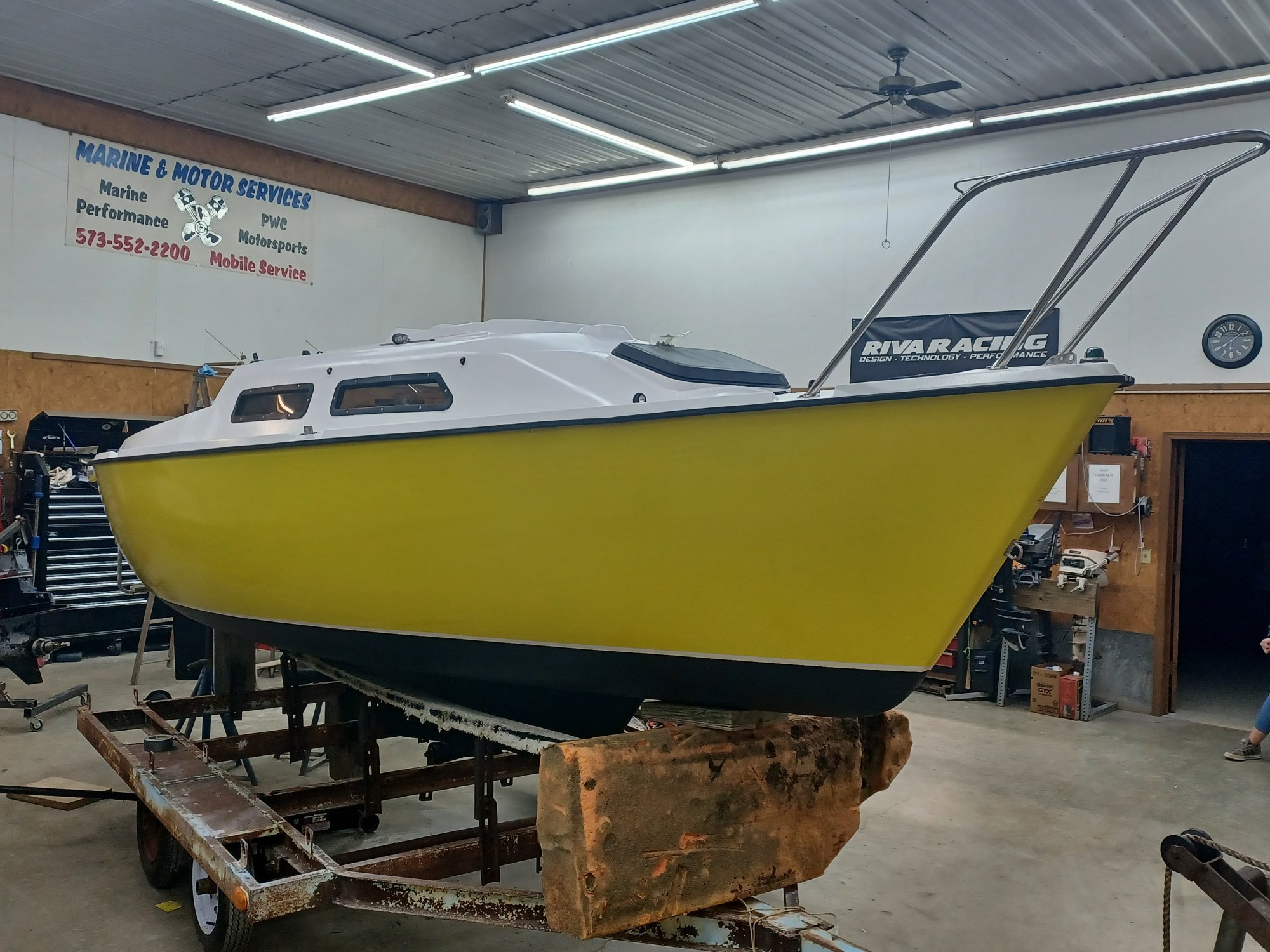

Starwind 19 project boat
Aug 10, 2020
612
Catalina, Hunter C25 3559 Rocky Mount

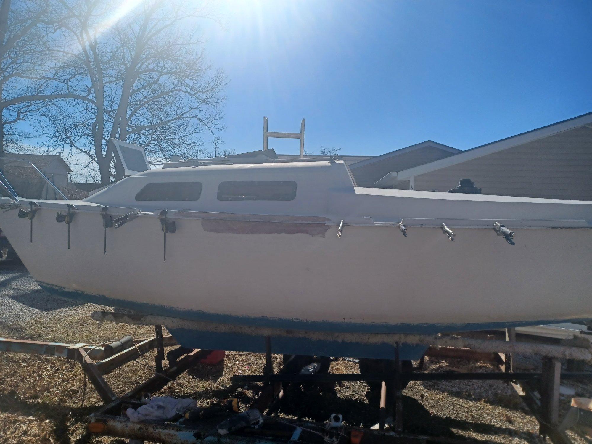

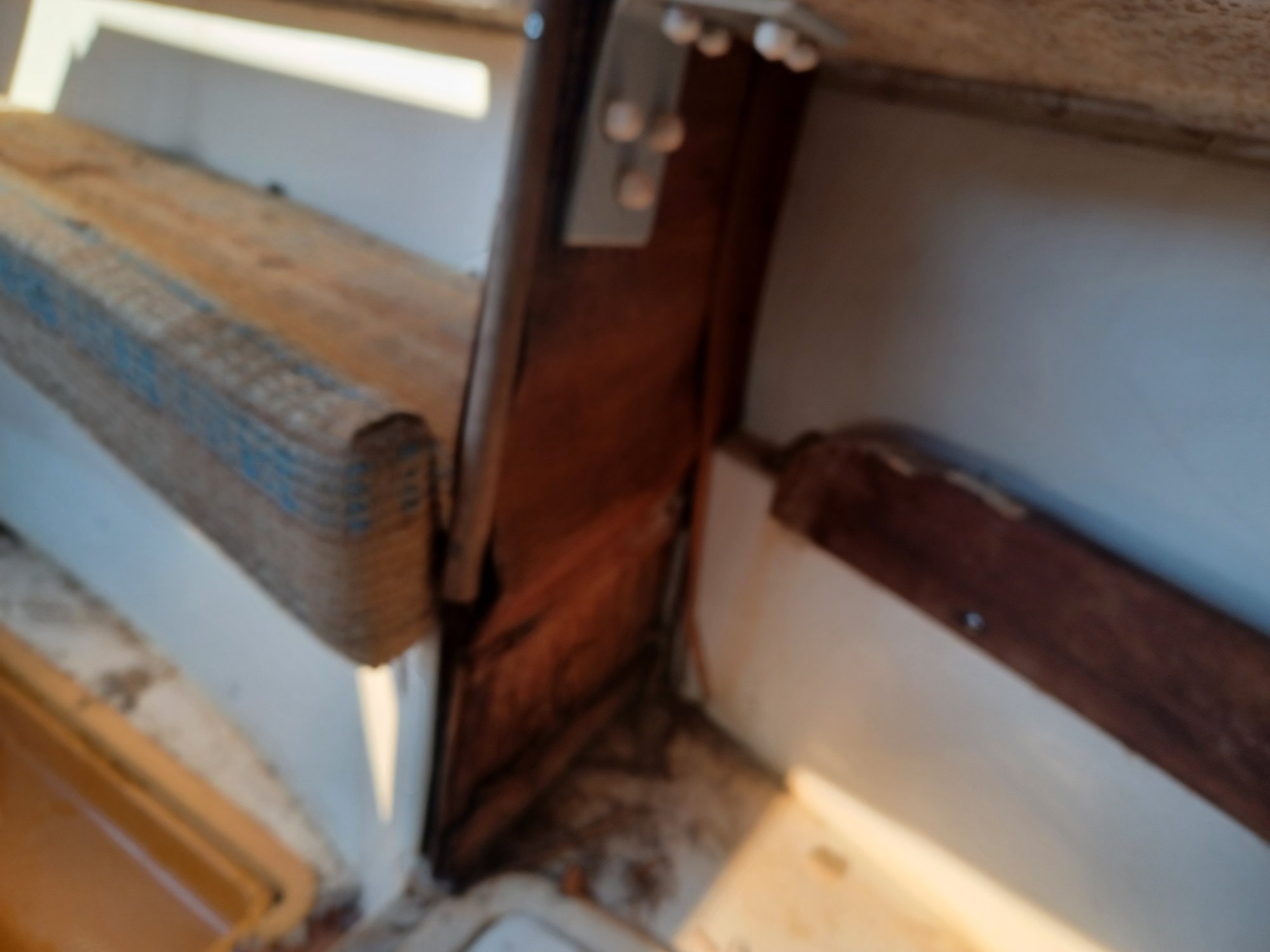

Cleaned up, new bulkheads, Port side hull joint repaired and sealed up

Love the color. I grew up on a schooner named Sunflower, painted yellow. The people at the boatyard where she was built, called her 'the floating school bus.'
I hope you turn a great profit on your flip. Show everyone how wrong they are to say it can't be done.

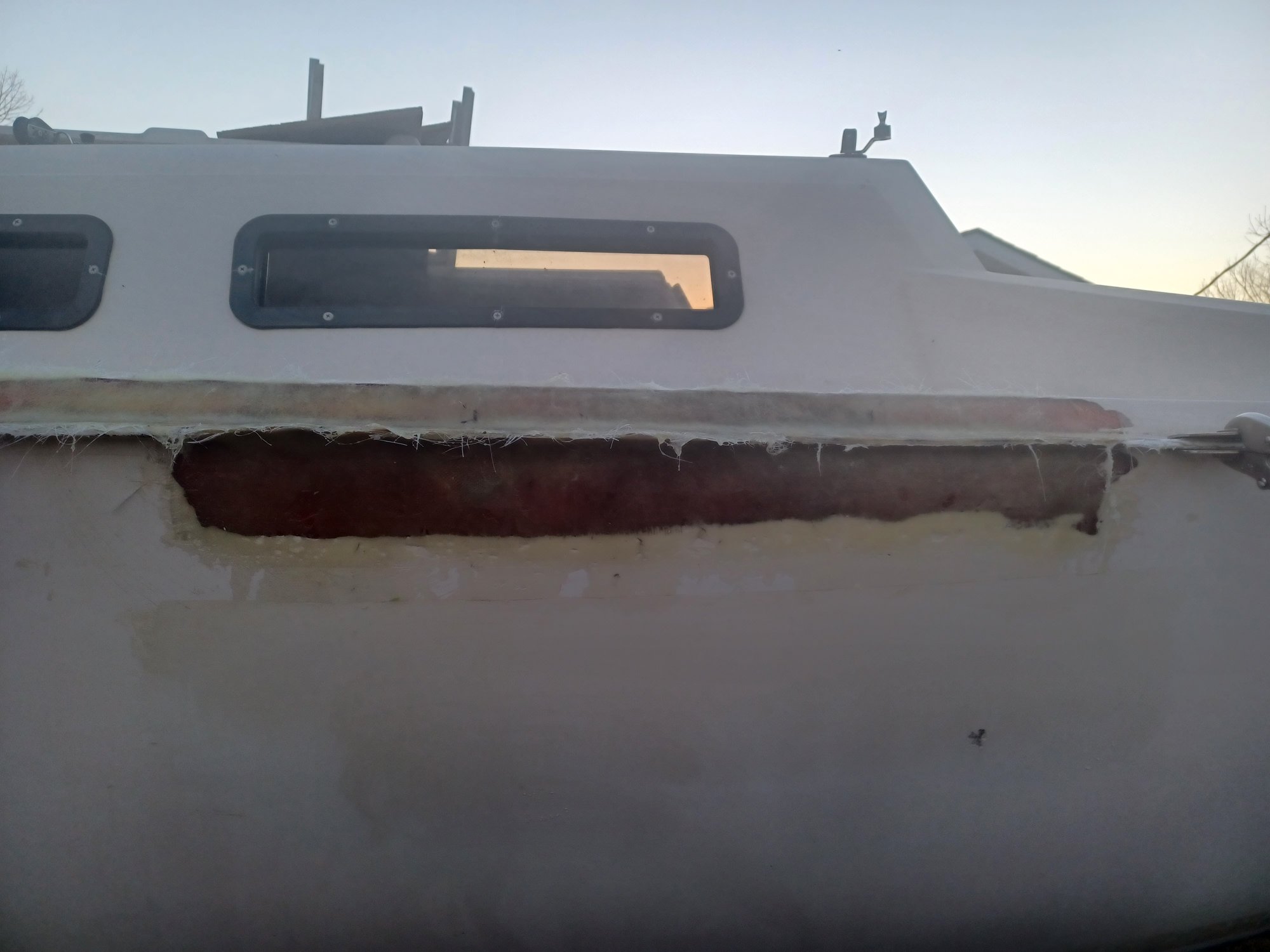

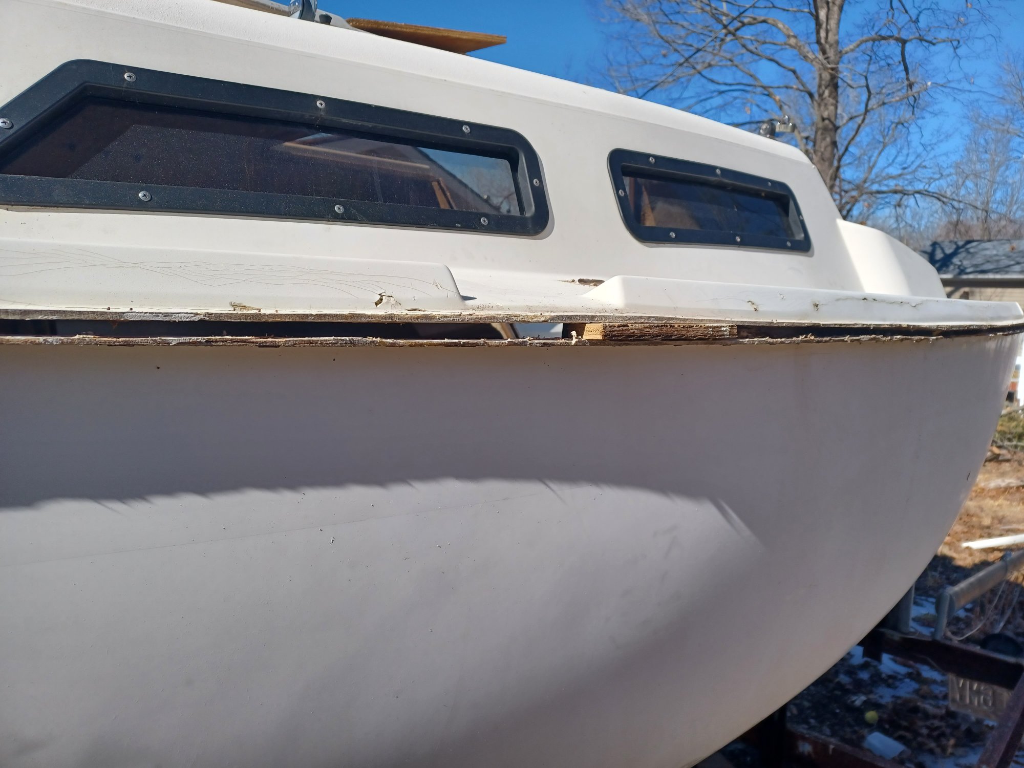

Loto,
Awesome pictures and very informative. Your boat turned out amazing and it serves as an inspiration for my boat. I recently purchased a 1986 Starwind 19 as my first sailboat and I'm loving it so far. The boat for her age is in great condition with one exception, and that's the wood trimming that lines the exterior of the boat where it meets deck level. I can visually see that this area is rotten on the aft port side, and have yet to investigate further but suspect this entire piece will need replacing.
I saw in your pictures that you removed this wood segment. Could I ask for more details on how you replaced it? Did you use treated wood or a synthetic replacement? Overall how much fiberglassing was involved, and what was the rational behind removing that chunk of fiberglass below the aft port window?
Any information for a total newbie is greatly appreciated. Thank you.
-Michael
Aug 10, 2020
612
Loto,
-Michael
Can you post a picture and show me what you are talking about? I'm not following your description well
