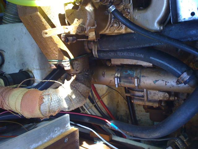

Indentified multiple upgrades and possible repairs on my 1980 CAT 30. Starting engine has gotten more difficult, exhaust leak, water has potentially fowled the glow plugs, engine is running hot. Based on my research I am diving into plenty of items. I plan to remove the cabinet over the engine to do a complete inspection. Expect to find the lift muffler inlet coupling has failed. Plan to unwrap exhaust riser piping to determine if replacement is required along with the new version hump hose. Plan to take the 2" heat exchanger apart and determine if it should be replaced with the 3" heat exchanger. I also plan to perform the Project: Glow Plugs which will include a starter solenoid. Of course with all that complete, the glow plugs, thermostat, antifreeze and oil will all be changed as well.

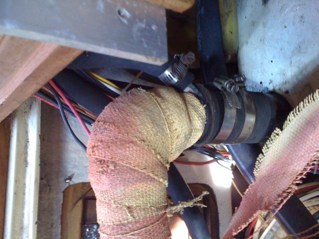

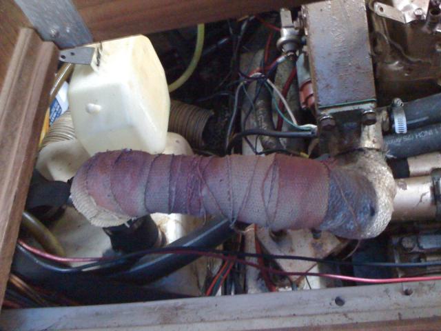

I pulled the exhaust piping, heat exchanger and did a general inspection. After removing the exhaust piping insulation, and multiple layers of rust, I found the piping to be in surprising good condition. I took the heat exchanger end cap off for a closer inspection. Once again, to my surprise, there was no build up in the tubes and the pencil anode still had some size to it.
So here is the current plan. I am scheduling a mechanic to come on board and give me some recommendations. After all, I have done all the hard part. I still plan to rebuild the exhaust piping and replace the heat exchanger with a 3". Is it worth trying to use high temperature hose instead of hard pipe for the exhaust piping? Some of the links for this work recommend going to SS threaded pipe. What about dissimilar metals causing electrolysis between SS and malable iron?

Don't do the hose. They make it with solid pipe for a good reason on ALL diesel engines I've ever seen. Ya gotta leave the flange with a pipe, then hose and then the nipple, so you have two susceptible joints and four hose clamps. Bad idea.
Yes, there are different materials folks have used for the pipes. Your boat, your choice. I used muffler pipe paste in the riser and the flange threads, which should provide some isolation and is good to avoid blow by past the threads.
