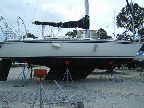

hey all, Ive been working on restoring this 40' hunter legend for about a year now. Its a beautiful boat. It took on water. I stole it from the \
previous owner for $9k. he had the entire cabin professionally steam cleaned, and dismantled the cabin. I have rewired, plumbed, and reassembled the cabin. When i bought her, i was told that the engine was pickled, run, and pickled again, and it "should run, but no guarantees". I think i misunderstood.I recently contacted the previous owner and this is what he said:

Yes, $9k. It did have issues. but it is a solid boat. it took on a couple feet of water (not sunk). it doesnt even have a salvage title! it is CG documented too. and it has new sails + a really decent used set, brand ss new rigging, new electronics that didnt even get close to water--radar, gps, autopilot, wind/speed/depth--all recent raymarine models, new canvas, etc. the electronics and sails and harken furler and custom arch are worth more than $9k. she even had new upholstery that didnt even get wet, except the queen berth mattress which is missing.
The guy got paid off by the insurance company and bought himself a new one. he intended to reassemble it but never got to it. and owed $5k in storage. I guess he just didnt care. I mean, it was a project that a lot of people wouldnt be consider undertaking. but it is truly a solid boat. the latest survey (before the incident) said it was "bristol and top of her class".
I have some pics here: http://brandonjackie.shutterfly.com/2483
The exterior shots are my boat. some of the interior shots are what she is "supposed to look like". I have since finished the interior.
