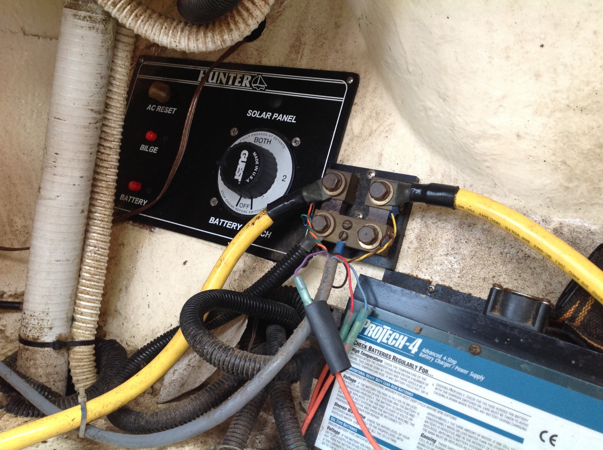

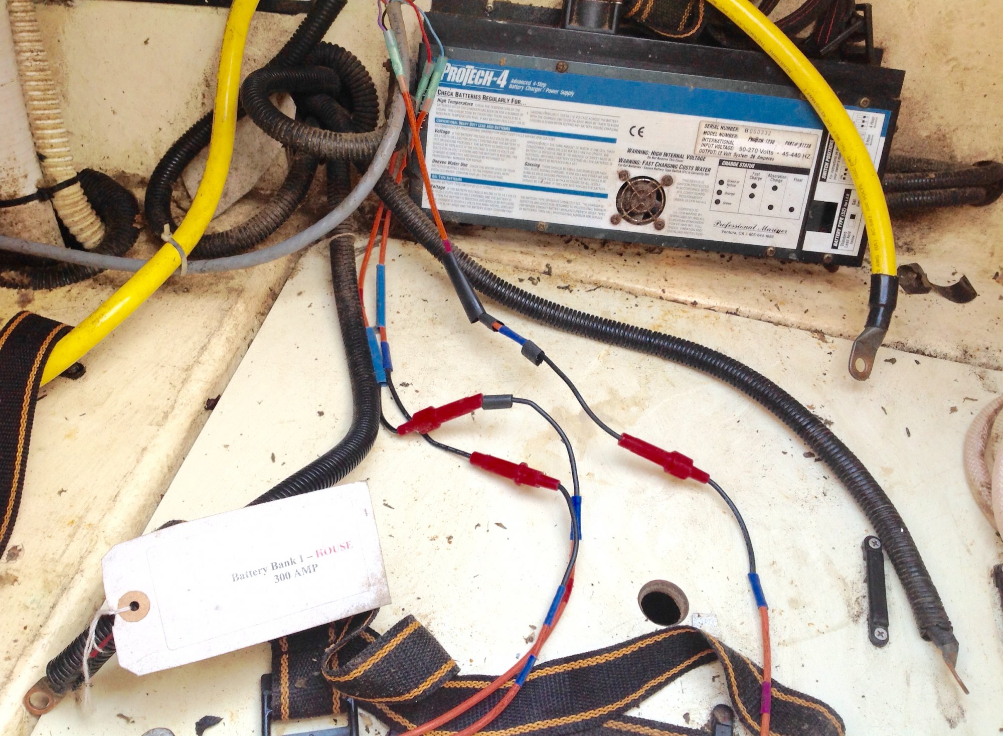

Here are pictures of my 1-2-Both Switch, Charger and wires that lead to my Link 20 Monitor, without the batteries in the way.
My plan is to add a third battery or 2 higher Amp Hour batteries to get to the 300 + Amp HouseBank and a single Reserve Bank Battery (wired right this time!). Add the ACR controller and a portable solar panel to keep it all topped off. And start using the refrigerator occasionally.
I think there are to many connections in the Link 20 monitor wiring, so I plan to cut them and make 1 connection in each. The monitor works as it should but it seems like to many cuts in the wiring to me.
So where would you mount the ACR in the compartment and where are the wires attached to for the solar panel and ACR is the question?
Those appear to be connections to the required in-line fuses. Doesn't appear to need ANY remedial work.

Mount the ACR wherever convenient.
I think it’s already been said but if not, you should mount a positive bus bar near your house bank.
All charging sources, the house bank positive and one side of the ACR should attached to this bus bar. Wire the house side of your battery switch to this bus bar as well. The other side of the ACR to you other battery bank.

Before you make any modifications to the battery monitor wiring, you should study the manual to see what is involved. I have a Xantrex LinkPro and I can see some similarities. What you seem to be showing is some kind of shunt (I don't recognize it) and the bundle of small diameter wires from the batt monitor. The shunt is like a negative buss bar, but it has the specific purpose of recording the negative current that goes back to your battery bank for monitoring.
The shunt has the large diameter battery cables connected to it. The negative side of battery loads will be on one side of the shunt, and the ground cable to the system ground should be on the other side of the shunt.
From the monitor, you will have 3 positive leads to the batteries, all with a fuse. One lead is the power supply (doesn't really matter which battery it goes to, all it does is supply power to the monitor). The other 2 positive leads go to each of both battery banks. These are recording voltage, I believe. You will also have a negative lead from the monitor to a negative buss (or directly to the shunt, I suppose). This returns the current from the power supply as you undoubtedly realize that you have to have a positive and negative circuit for powering the monitor. Then there are a twisted pair of leads that have to be fastened correctly to each side of the shunt. This probably has something to do with measuring the current in amps. There may be a few other leads for alarm contacts (which are optional).
Long story short, your monitor and the wiring for it isn't related to other issues that you may be facing, and there doesn't seem to be any need to modify anything related to your monitor. I would study the diagram of negative cables to the shunt, though. It has to be done correctly for the monitor to function properly. But how your shunt is organized doesn't have anything to do with your battery charging woes. Somebody correct me if I have something wrong or am missing something!

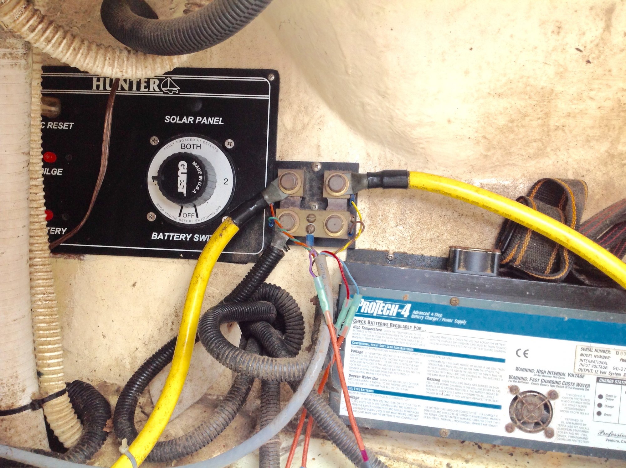

I see the confusion you may be having in the wiring of the ACR, it can be confusing. From your picture, you should be able to mount the ACR under the Battery Selector Switch. Check behind it though to make sure there is nothing mounted under it in the starboard locker, before you start drilling any holes. That's where my engine exhaust piping and macerator line runs. The screws to mount it shouldn't be that long anyway, but check first.
I've added a photo and put in some lines showing what lines you need to add. Your existing Positive Cables to each Bank won't change and neither will the Negative Cables. They still feed the power to the boat as before.
You will need a new Positive Cable for each Bank. Where you mount the ACR will determine their length. A new Negative Ground Wire (should come with the unit), but check on that also. And you can run that to where your Negative Cables are now.
You probably have the same size Alternator I have on my 340, if it's original to the boat in 2000. I believe mine is 80 Amps and it gives a little less than that to the batteries.
Where you buy the ACR will have the proper wiring and fusing requirements, just give them your information.
Keep the "new" Wires to the ACR short but enough play to move and work with.
If I'm wrong with any of this information someone please correct me.
I hope I've made it a little clearer as to placement and wiring for you. The picture is what we both have for our wiring now, except for the engine. And you can add the number of batteries you have to the diagram, wired correctly, easy enough. You would have 1 more House Battery, but still need only 1 New Positive wire from the First Battery in the that Bank, to the ACR.
