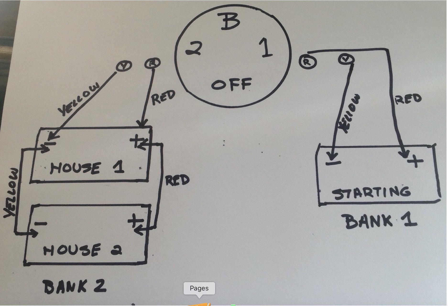

Yes, my Positive and Negative Cables, from the Switch, are directly attached to Battery 1. Then I just used cables from the Battery 1 to connect to Battery 2. Even the diagram I have shows this set up. HOW DID I MISS THIS!
I’ll be redrawing my diagram to show the Negative (Yellow) from the switch going to the Negative of Battery 2, then a cable to Battery 1.
And your both right, I have probably reached the end of life for all the batteries based on this setup.

This is a quick drawing of my wiring diagram. It's how it was wired as this thread began.

I am puzzled. My OEM 1-2-all switch has only positive cables on the terminals. All the grounds go to a buss bar that I installed some time ago when they were removed from a hard-to-inspect bolt on the bell housing.
Probably just a quibble, but I believe that wiring to the paralleled batteries in site diagram is not quite right either. (?)

"This is a quick drawing of my wiring diagram. It's how it was wired as this thread began."
Make a complete diagram. Missing pieces will make for misunderstanding. It is common knowledge that charging two different batteries or battery sets with the same charger at the same time will cause one of the sets to be eventually damaged, if not both. Sometimes sooner sometimes later.

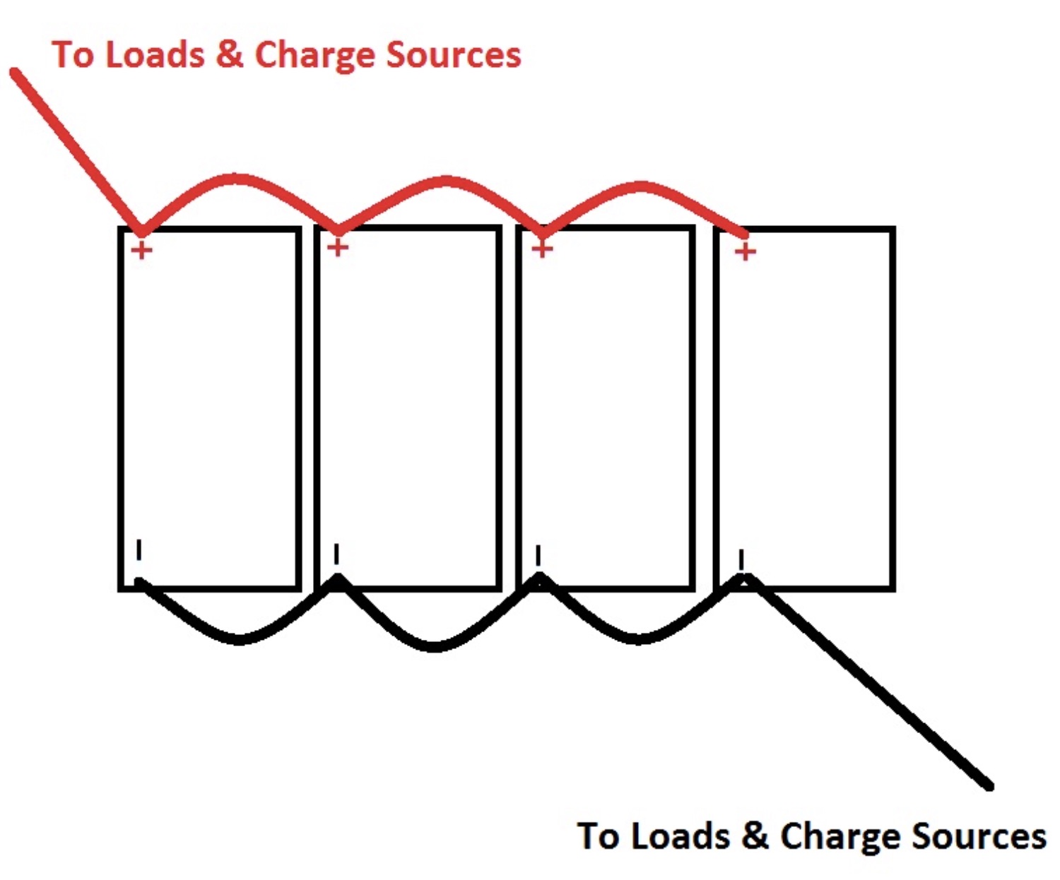

You can agree or disagree with the recommendations about the 1/2/Both switch and its use over the years. I believe that @mainesail and others like @Stu Jackson have tried to help boat owners to understand the disadvantages of the "Tried and true" 1/2/Both switch. I am a believer that their idea is better for your boat and the power systems we use. But as always it is you the boat owners choice.
What cannot be disagreed is the need to have a balance to the charging of your batteries. This is battery science. To do this you need to be sure you wire the batteries to get a balanced charge. This means the charge must run equally through all of the batteries being charged.
Look at how battery connections are indicated in your diagram and how they are recommended to get a balanced charge to your batteries. The devil is in the details.

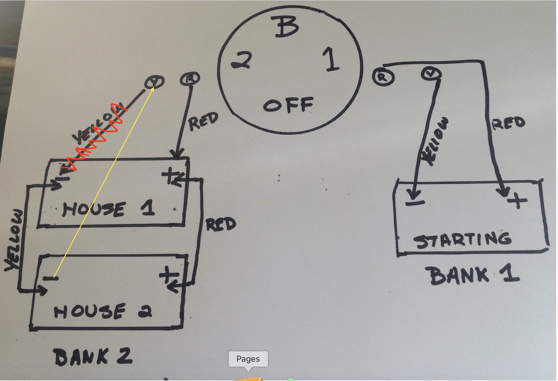

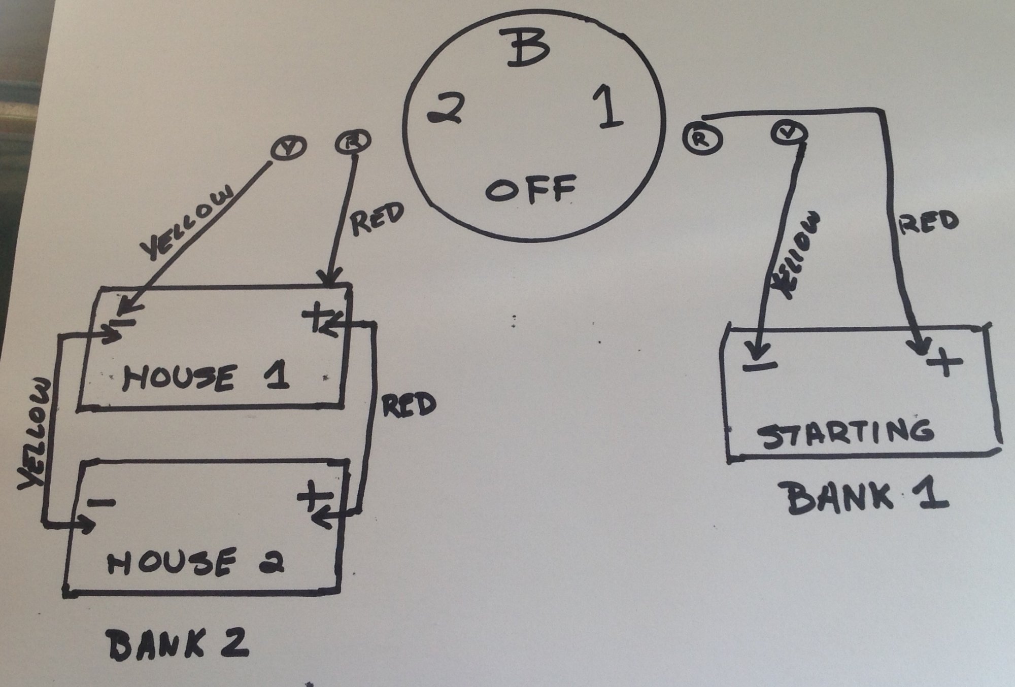

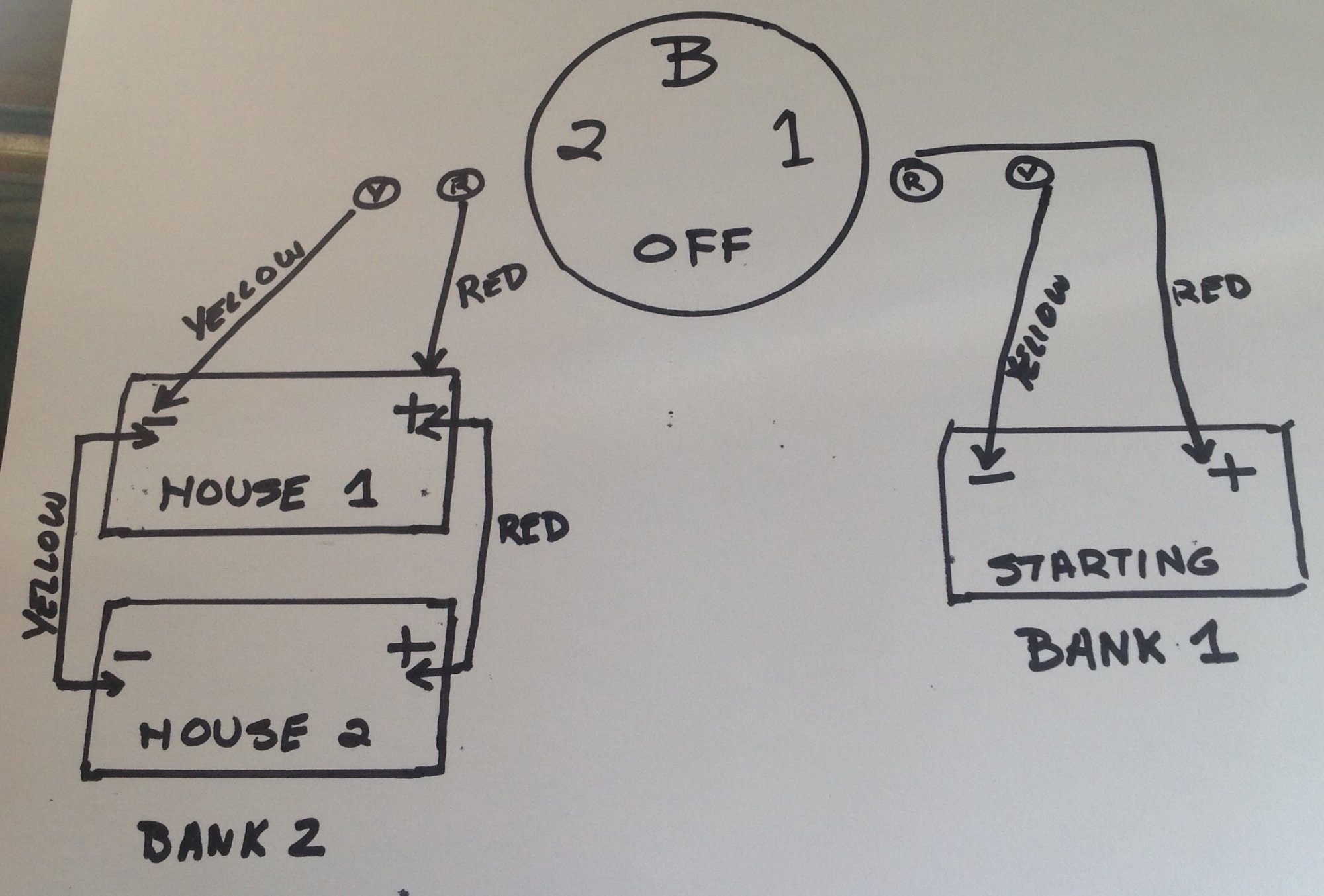

@Nichole340 Battery reported wiring diagram.
MaineSails, wiring diagram.
A simple change to Nichole340's connections... Connect the ground to battery #2 ground to balance out the charge to the bank.

Thanks David, the batteries will have been charged as if a single bank but they are not because they have separate capacities and acceptance so the proof that they have not been charged completely is shown by by the need for further charge on one of the banks.
In the original post, the OP notes the batteries are Dekks Group 24 Deep Cycle. The manner in which the batteries are currently configured into the house bank does not allow for a balanced discharge or charge. In the current configuration Battery 1 in the house bank will be discharged more deeply than battery 2. As a result the charger will charge based on the condition of battery 1.
If the house bank is rewired as in @jssailem's drawing the batteries will be evenly discharged and will be evenly charged.

jssailem, looking at your correction to my diagram makes all the sense in the world. How and why I connected the house batteries as I show is beyond me. I must have been in a hurry or just not paying attention at the time. :banghead:
I have never had this type of issue in past years, somewhere I got my wires crossed. Literally.
That correction will be made in the spring.
