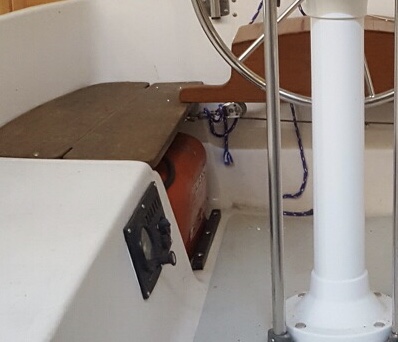

Yes, I have read that aging fuel tanks can be the source of much grief. Didn’t know about fuel polishing, interesting. I’ll look into that. This little boat uses a portable fuel tank tucked neatly in the aft quarter of the cockpit. May prove easy to manage or replace if needed.

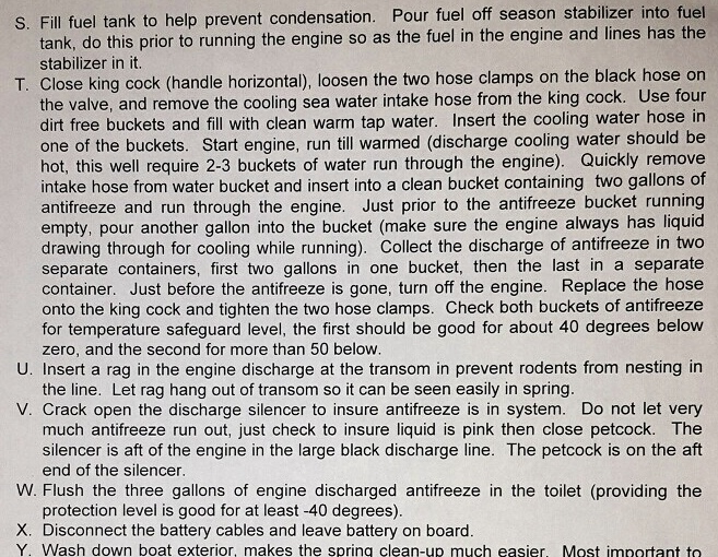

Received a copy of the winterization sequence undertaken by the owner. I’ll upload an excerpt regarding the engine for consideration. This outlines the fall treatment. I wonder about undoing this for spring.

Wow! That’s the sort of PO you want. 3 1/2 years isn’t that long for a properly stored engine. I’d go with JaySweet’s approach and basically start it. If the engine doesn’t crank, stop and get a mechanic. And stop cranking after 10 seconds it doesn’t start - the fuel system probably has to be bled (As mentioned above). I assume the PO in steps A-R replaced the oil, oil filter, and fuel filter. If not, do that since it’s needed with any storage. And spring for a new battery instead of trying to make due with the old one - especially if the date on the battery is five years or more. Any crap in the tank will be caught by the fuel filter. I would just empty the tank into a jerry jug and look in the fill opening. If it looks fairly clean, pour a half tank back in and top off with fresh. Then as you run that down refill from the jerry jug (assuming the engine has been running fine) Have some spare filters on board. If you clog a filter, replace the tank. But there’s a good chance it’s OK because the PO was so fastidious.

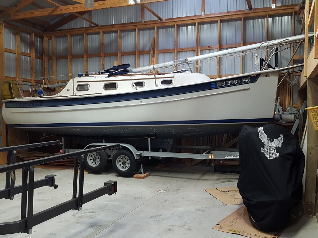

Yeah he’s pretty organized. Good inspiration. Here’s a shot of how the boat has been stored in winter each season since 1998. Note the trailer up on jacks. This is not a story of tragic neglect but how one love got overshadowed by the wife’s pontoon boat.
I’m feeling good about the prospects here.
I agree: given how careful your PO was, I think you'll be just fine without going to all the trouble of draining out all the old fuel. I'll admit I was thinking about hiring a fuel polishing service myself, as my fuel tank is totally inaccessible and 16 years old. But I did absolutely nothing with the fuel, and the engine has worked flawlessly. I do plan to get a cheap endoscope and have a look in the tank soon. As you say, with an external tank, you'd have a much easier time of it if you choose to ditch the old fuel, but why not try the easy way first?

I think you are on a winner there with the boat and the previous owner.
When I read " while it sat stored in his barn in WI "
I imagined rotten rat eaten tarp covering a boat that had been forgotten, thus my advice.

So how did the PO get that boat in that structure in that orientation? It reminds me of a Austin Powers movie.

With regards to the old fuel, not a problem as you have a portable tank. Discard and replenish. If you know someone who has a “Baja filter” you can filter the fuel and reuse.
Had the same thought when I saw the photo. Perhaps he built the barn around the boat!!! Would like to see a video of him extracting it.

He has two flat-bed dollies, one under each set of tires. Allows him to push it sideways.
