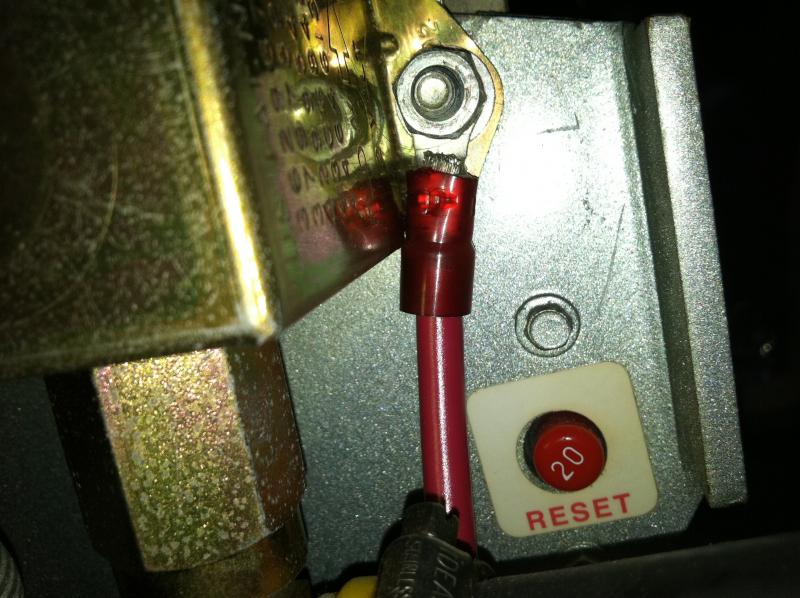

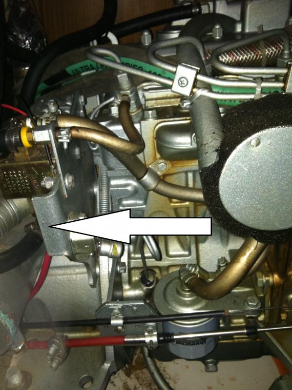

It is secreted away so no one can find it. It's behind the bracket as shown here. Probably have to feel around for it.
Thanks a hugh bunch. Really appreciate the pictures. Thanks for other comments.

Thanks. Found the re set button. Problem turned out to be broken
ignition wire at starter. Had sharp factory bend at connection and
vibration broke it. Thanks for all the help and advice.
