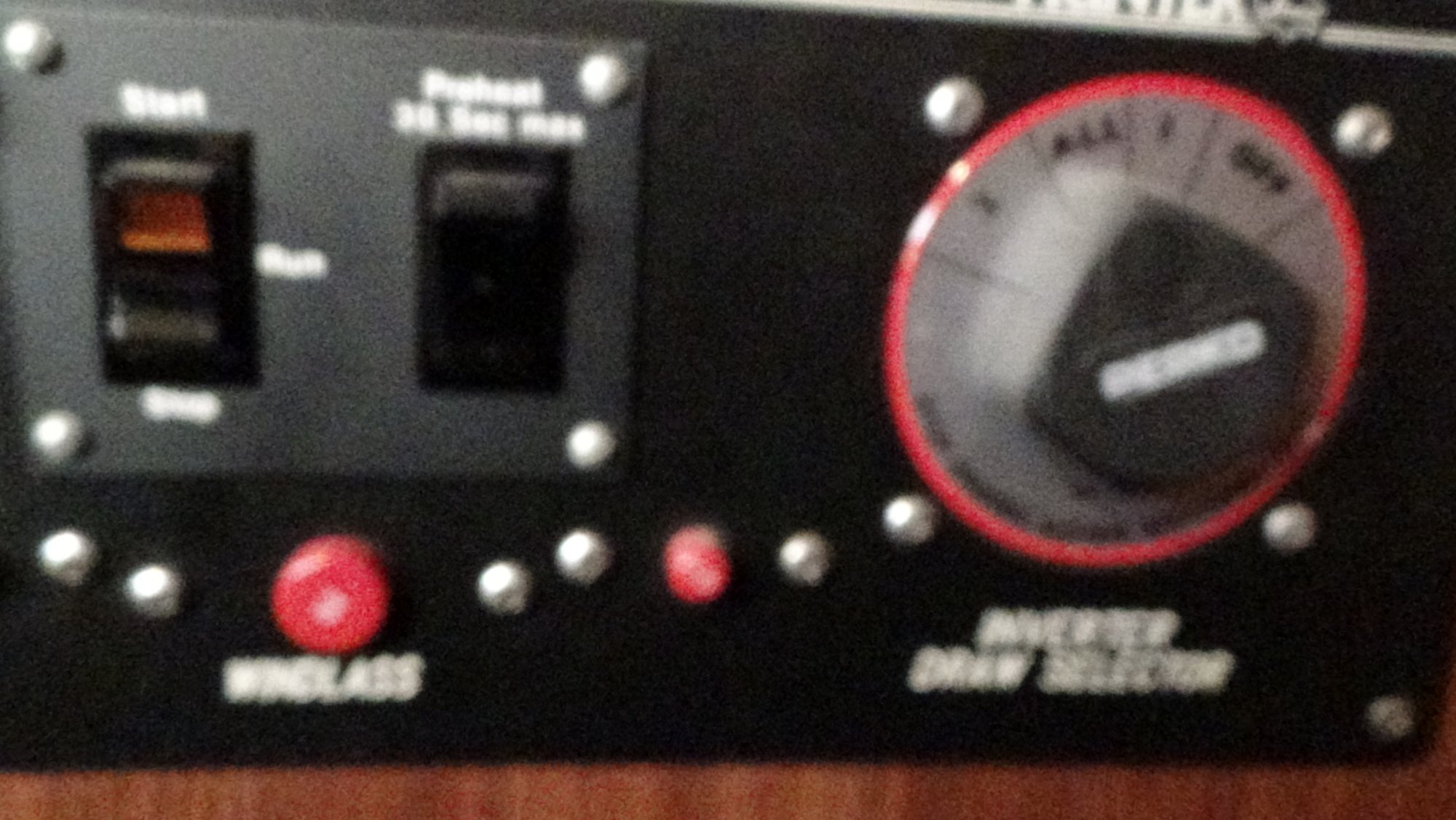

Our 91 P42 has a power panel on the engine bay bulkhead that looks like this:
Sorry for the blurry picture.
Make sure both switches look like ours. Then come back for further instructions. We've never had a starter charging problem. Also, regardless of the house bank state, it should have no affect on the starter battery state.
P.S. The switches between the two Perkos is for the Genset.

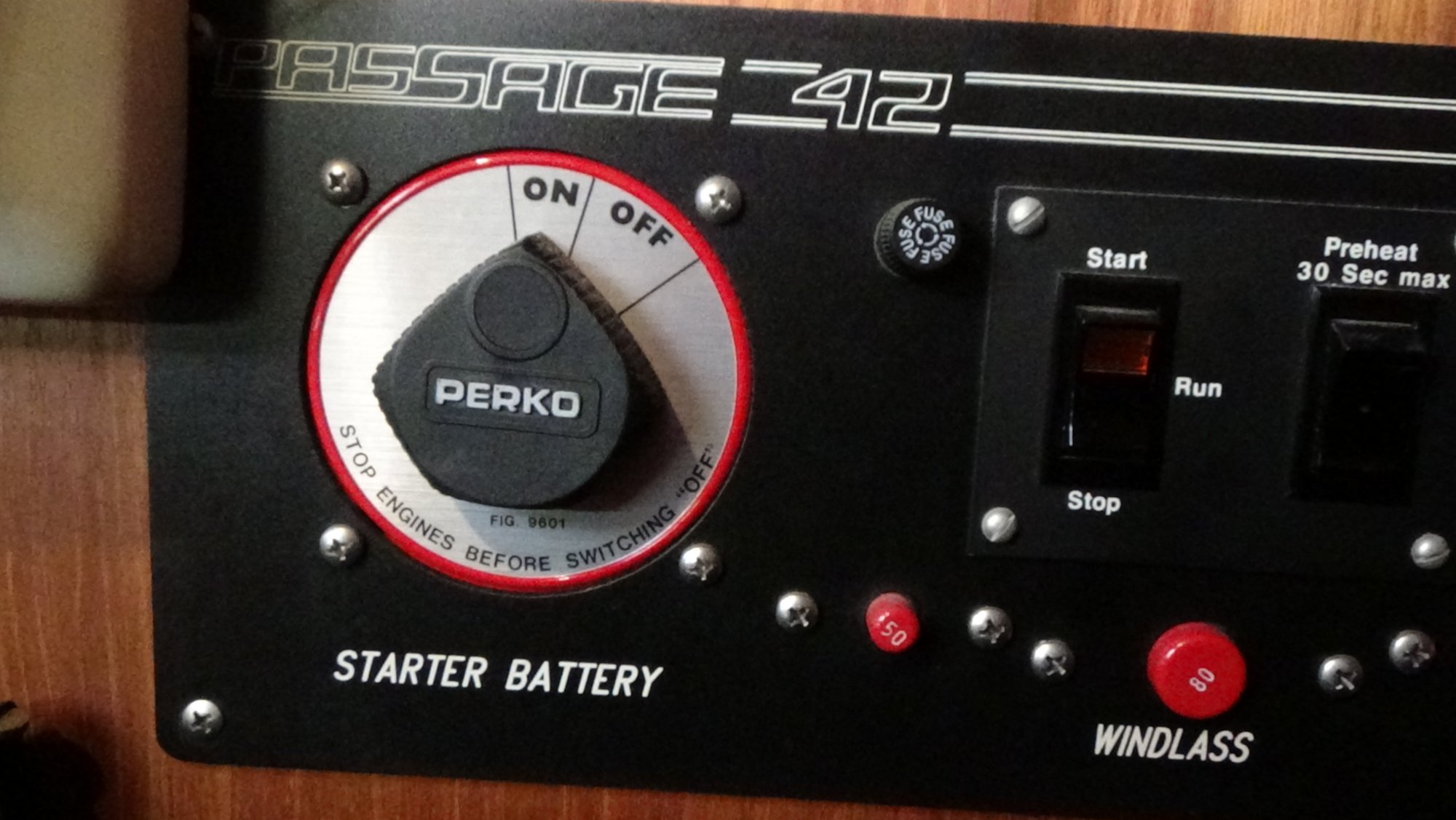

Terry, we don't have those switches but we have newer switches that do the same thing. The inverter draw is on "Both" and the starter is on when we are on board. The start battery is not charged by by the Freedom inverter charger. Only charged by the engine alternator or the generator.

Sorry, I've been busy with the windlass replacement mess. This boat was at the US Sailboat show in Annapolis in October 1996. It is P42 hull 206. This is the way it came from the factory.
