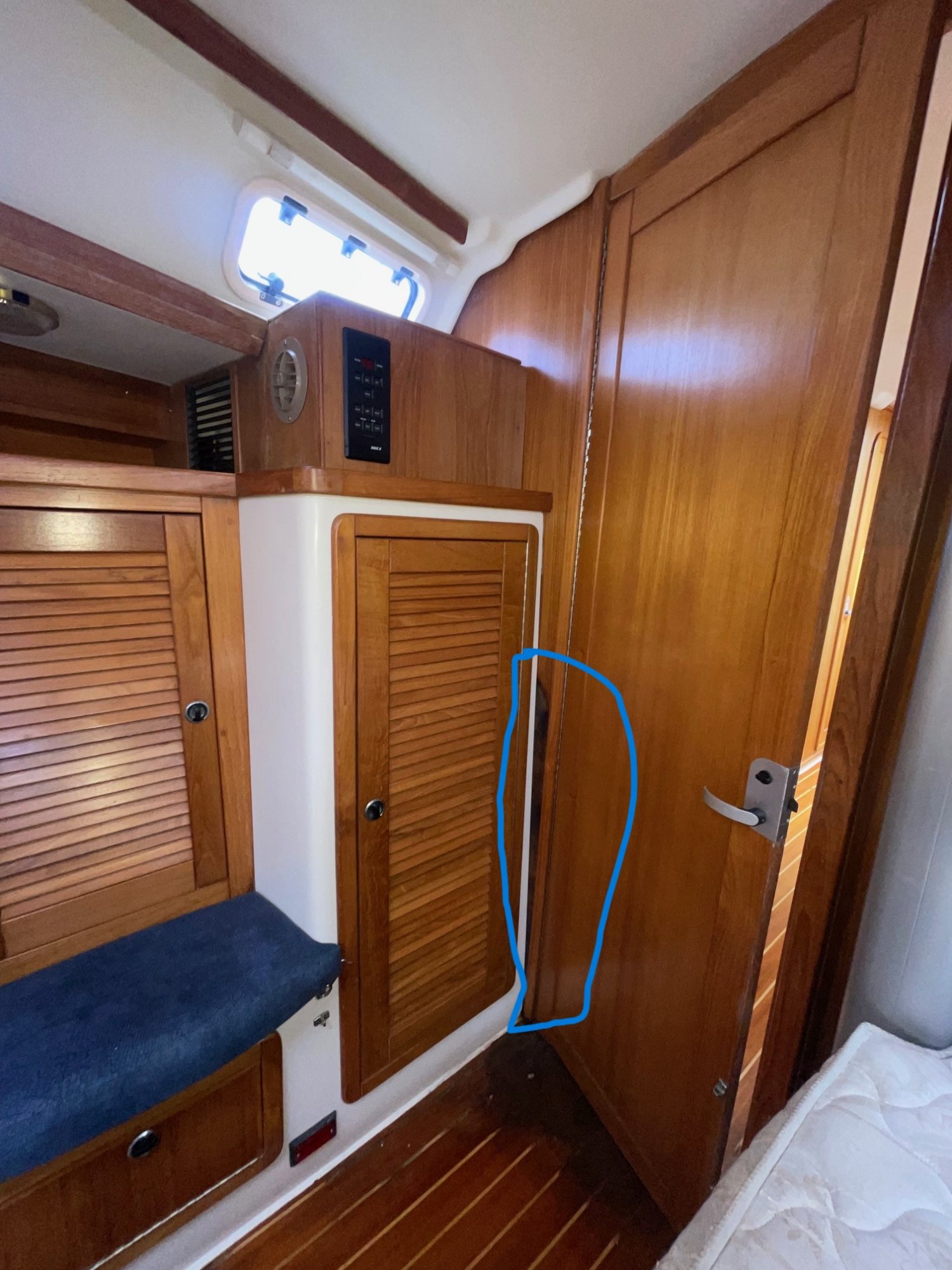

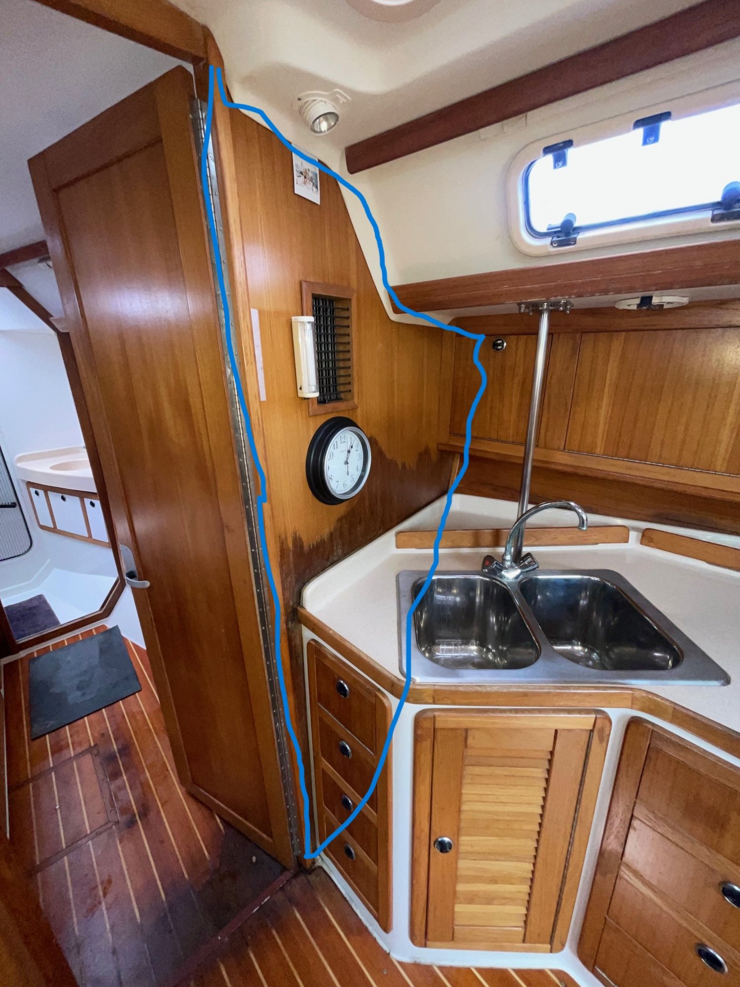

I am contemplating buying a C42 MKII but I would like to know that I will be able to fix the starboard bulk head which has be damaged by water intrusion and rotting on the side in forward cabin. (I will find the source of the leak and repair that before I do this of coarse). Does anyone know or think they know how this is installed and how

I am not sure if the shape of the plywood bulkhead follows the shape of the hull like this first picture or if it follows the shape galley counter.

Probably follows shape of hull to provide adequate support & stiffness.

Before buying, I’d pull out the AC vent grille and do some non-destructive investigating with a borescope behind the wood ’sandwich’ which is how Catalina made these bulkheads. Also, pull the drawers below the sink. I think the galley cabinet is glued and screwed to the bulkhead which complicates removal and if it can be done without damaging it as well.

I think to replace the bulkhead you need to remove the sink cabinet and the locker forward of the bulkhead.
I don't see a mast so I guess there is a compression post there.

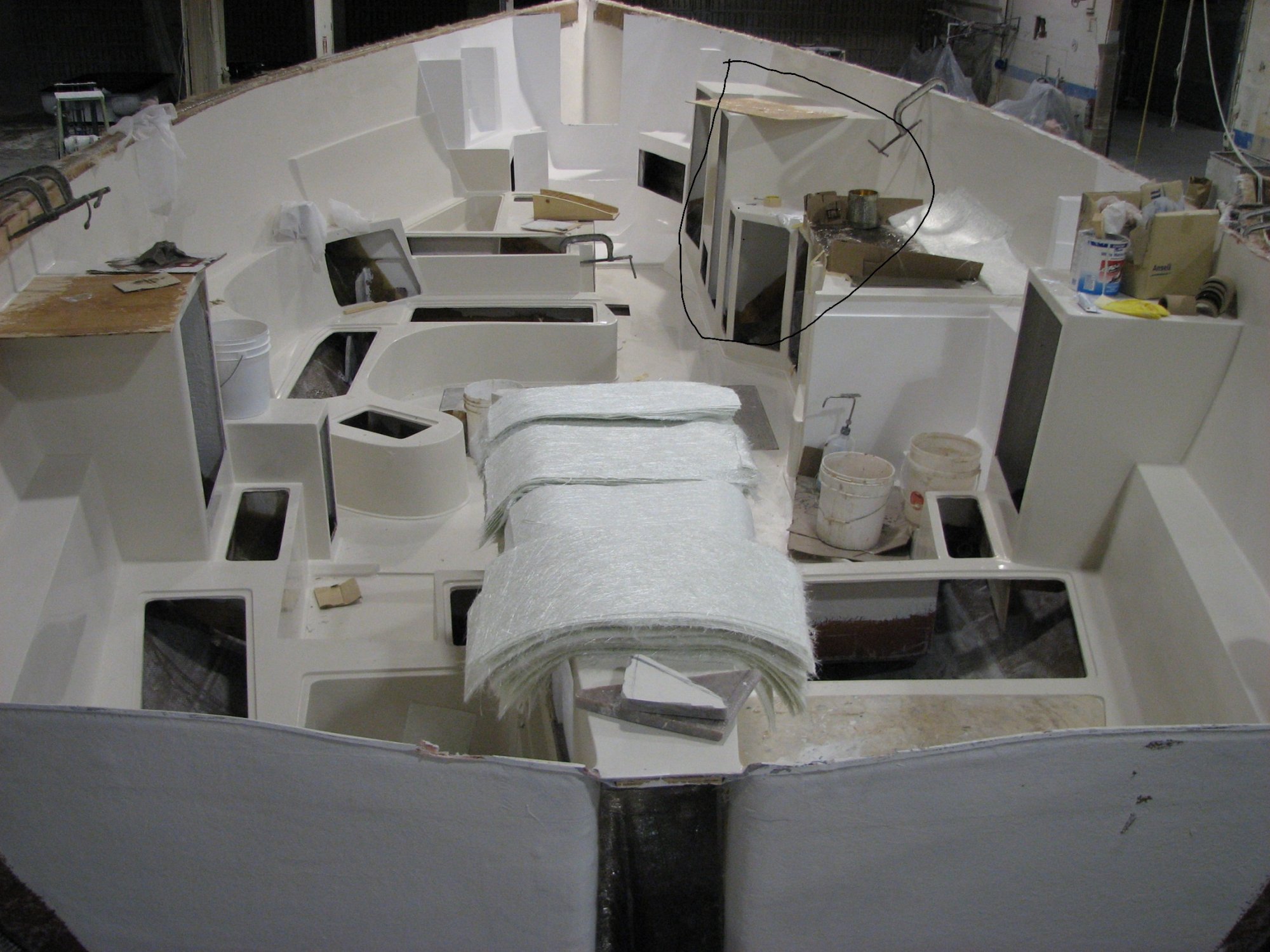

With some research I luckily found what I was looking for! I found a photo of a C42 hull liner at the factory. Same configuration as the boat i am looking at. I was right. It may not be to terrible to replace.. The cabinets over the galley probably have to come out. And I dont know perhaps the counter has to come up.

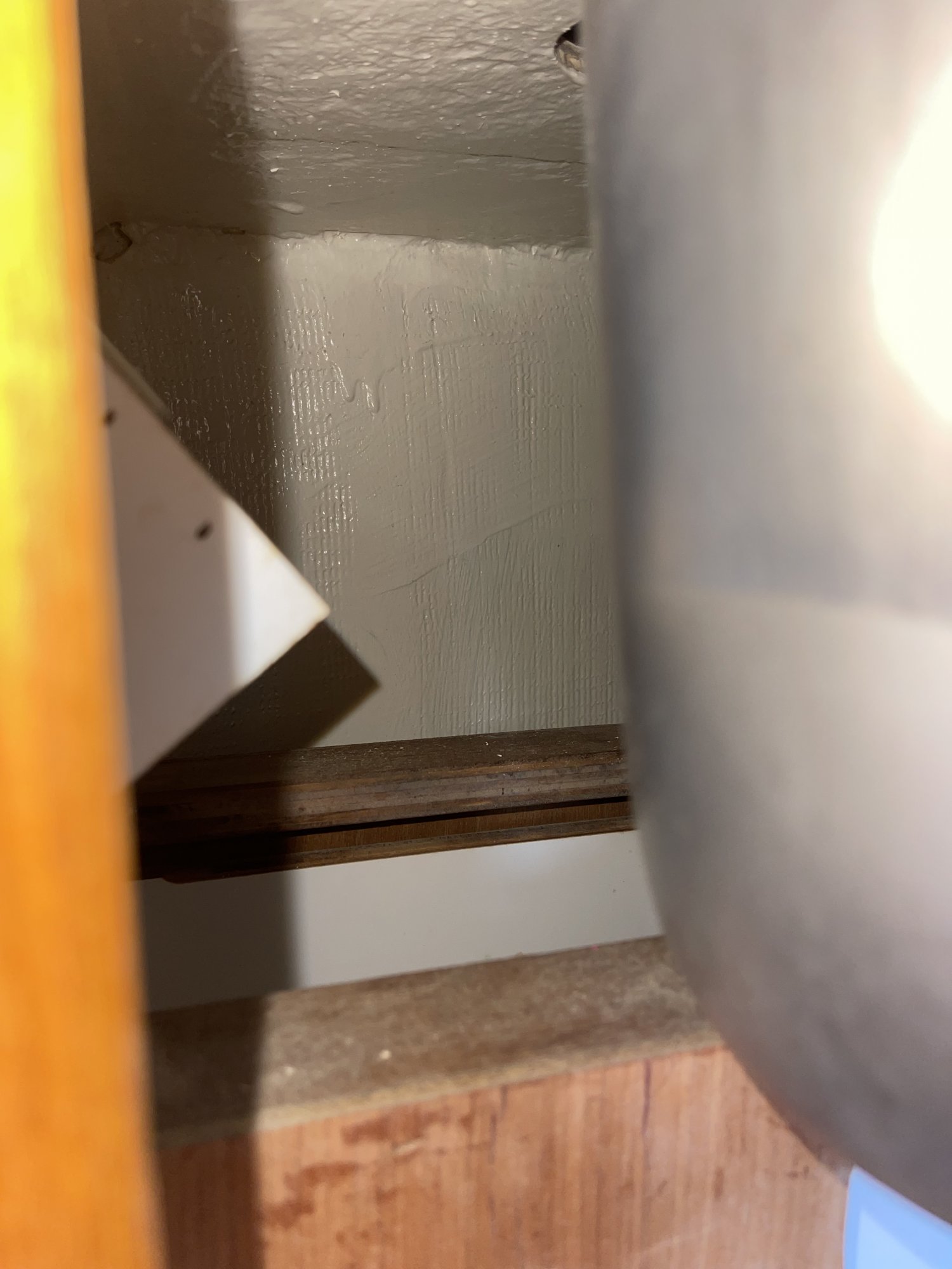

Good research, well done. From that photo in post #9, it appears that there is a wall of fiberglass behind that veneer wall in your OP photos. If so, there's nothing much to deal with other than "peeling off" the stained wood veneer and replacing it. The wood does not appear to be structural at all.
