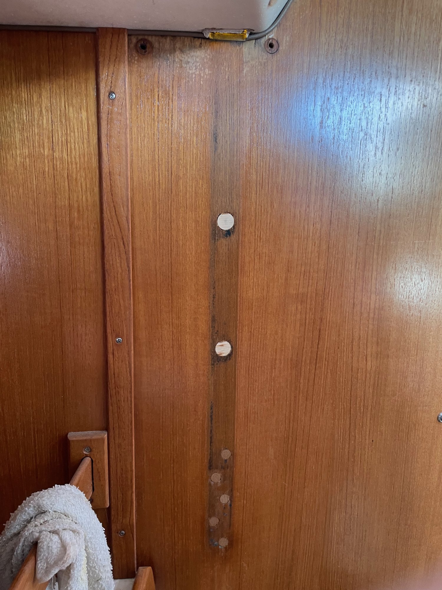

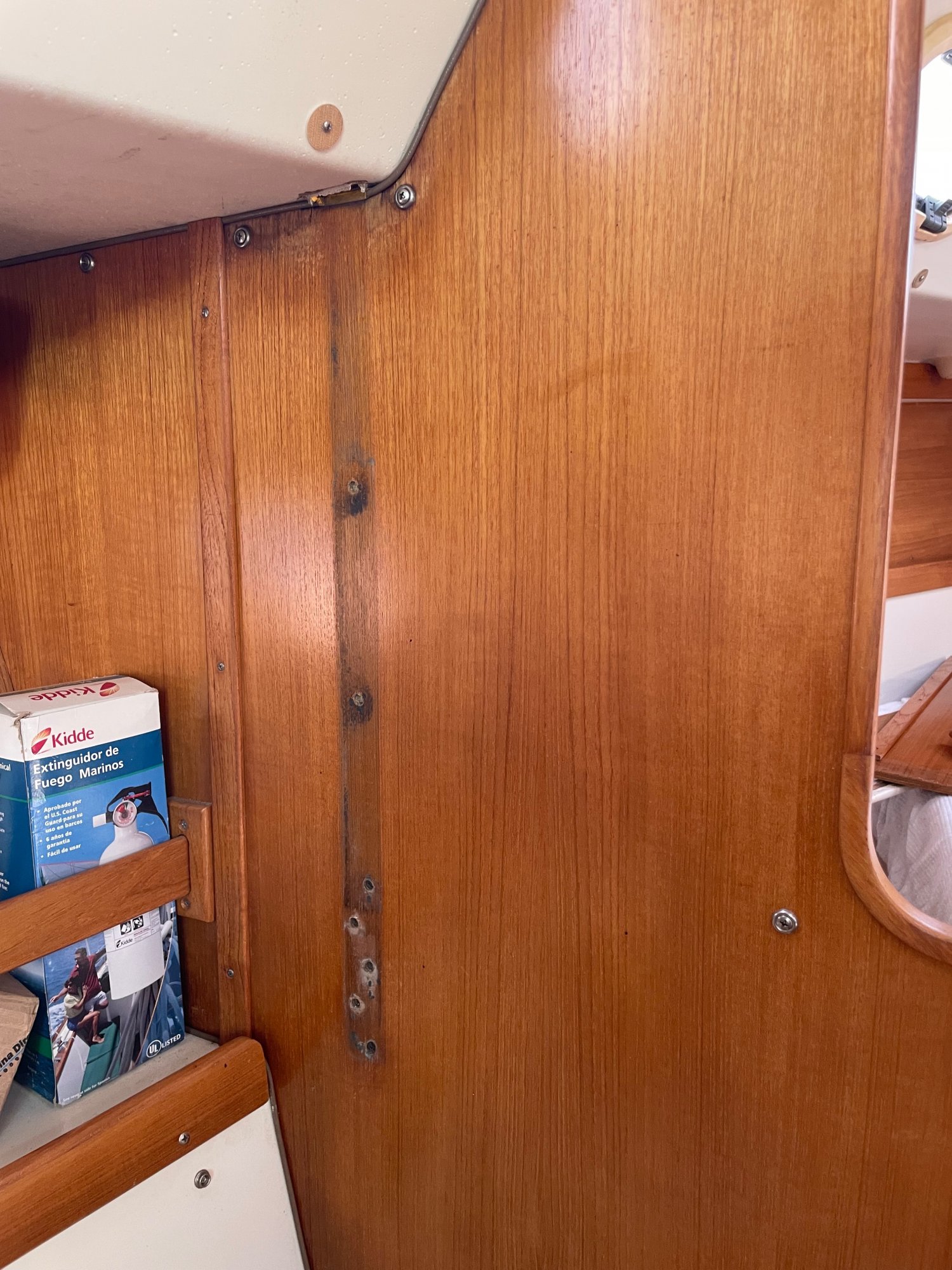

I about to dig into a starboard bulkhead replacement project on my boat, (Catalina 310, Hull 018).
Does anyone have a photo of the bulkhead after the veneer has been removed or experience with such a project on their boat?

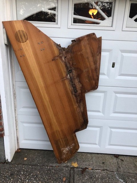

Are we talking about the bulkhead between the sitting area and the forward bed? If so, I have replaced my bulkhead.
The bulkhead did not have a "veneer"; it was plywood with a finished surface.

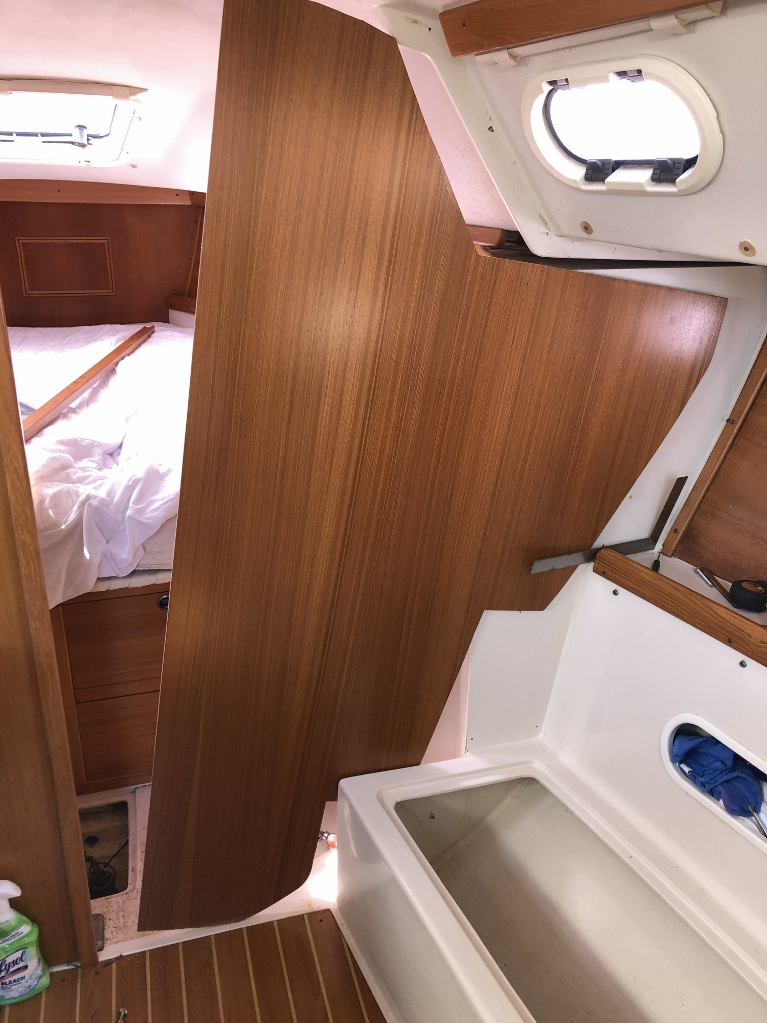

Attached is the bulkhead removed. It was a bit of a nightmare getting a replacement from Catalina. The first one they sent was not correct. They don't have the specs on our boat. The second picture is what they sent me, and as you can see, it would not fit. So I needed to ship them the bulkhead, and they did duplicate it for me. The final product, with some cutting, did fit.
Not sure what your question is, so if you could fill me in, maybe I can help.

Thank you for your reply and the photos; your timing is awesome as I'm emptying the boat now prior to starting this project.
From your photos, your issue appears to be the same as mine, (water from above), and your experience and the photos you've supplied are helpful. I'd be curious about the hull number of your boat to get an idea of how close its requirements/dimensions might be to mine. Is it correct that you ordered your replacement from the Catalina factory rather than Catalina Direct? I'm assuming the part was 3/4" marine plywood with teak veneer on both sides.
Given what you've shared about the piece being a single sheet, I feel like my bulkhead has delamination that will require at least a full replacement of the starboard side of the bulkhead. Do you recall any tricks or insights to dismantling the bulkhead that will help me out? I'm impressed at how clean the edge that was under your door frame is after being dismantled. Is it safe to assume you didn't run into any nasty epoxy or glue joints that you had to deal with?

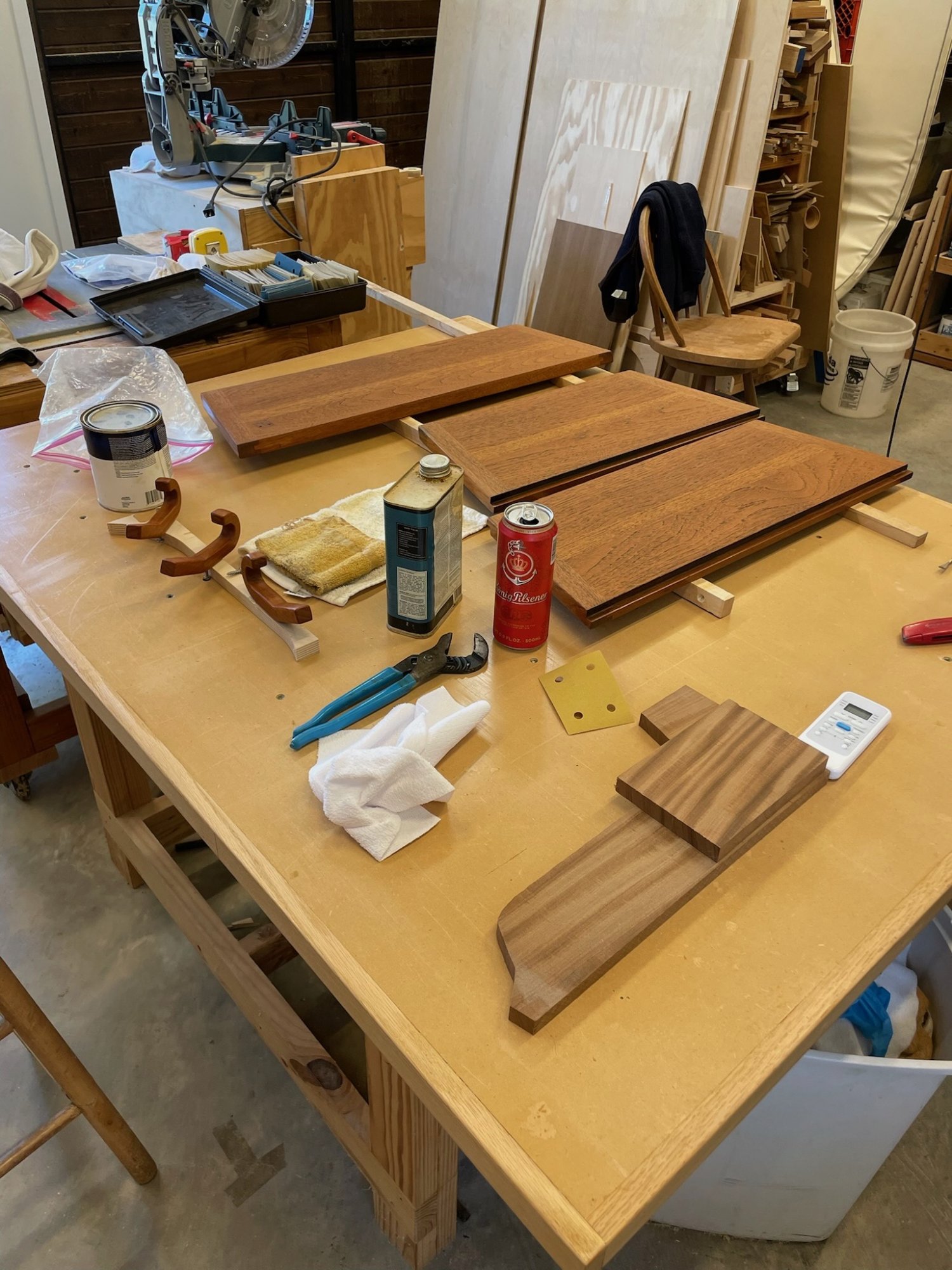

I didn't have the option to order a fabricated bulkhead when I removed and replaced both a on a different make/model several years ago, but this sounds like a very similar project. For mine, I sourced a sheet of okoume BS 1088 marine plywood, then I used the old ones as patterns to cut the new ones. This was less expensive and since I was cutting sheets to the exact specs, they fit perfectly on the first try. My guess is Catalina had a pattern for the bulkheads, but that each one may have needed a little trim to fit.
There's an album in my profile if you want to see what the finished wood looks like. Okoume grain is similar to mahogany. I stained it, epoxied the edges.

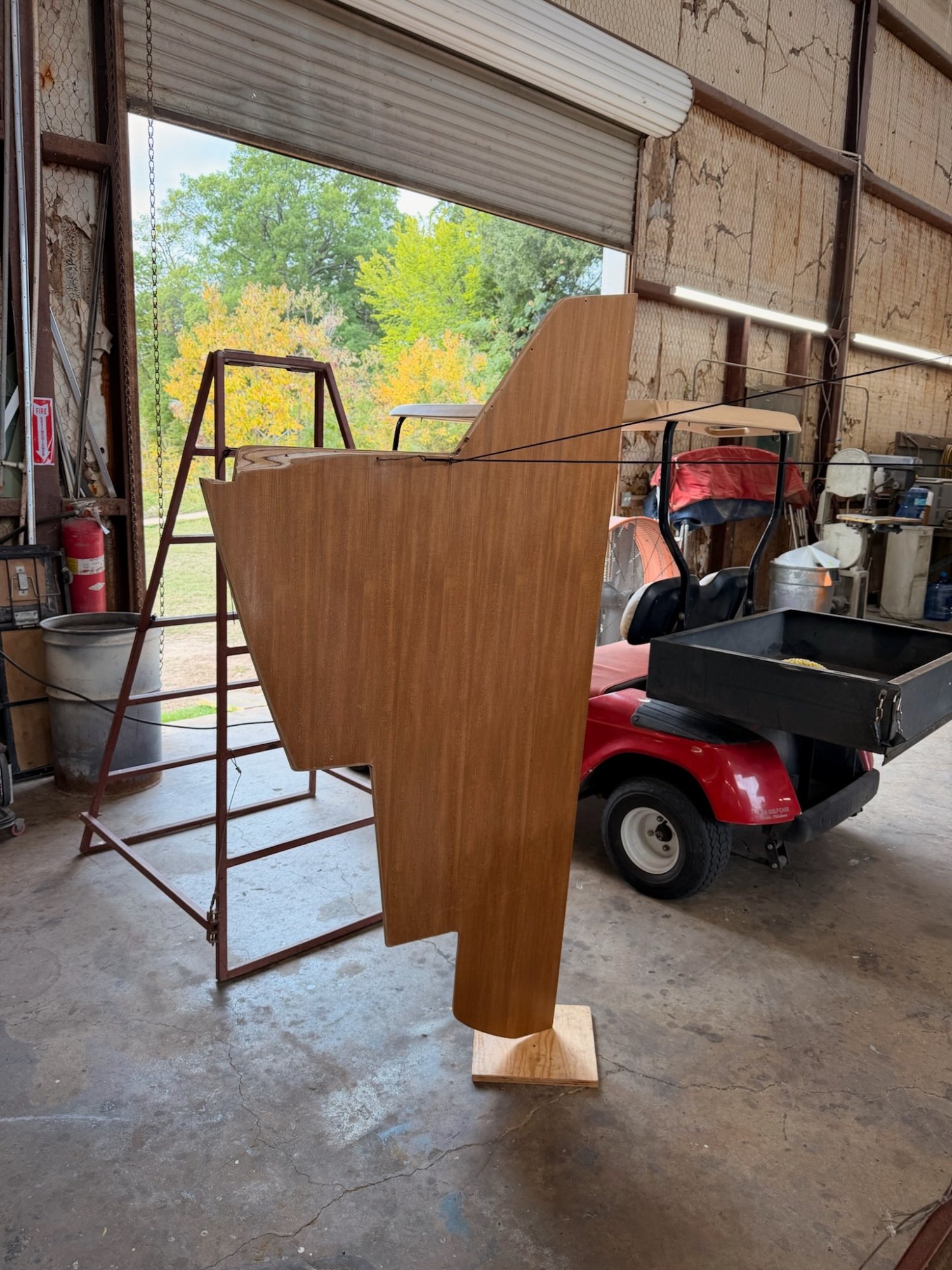

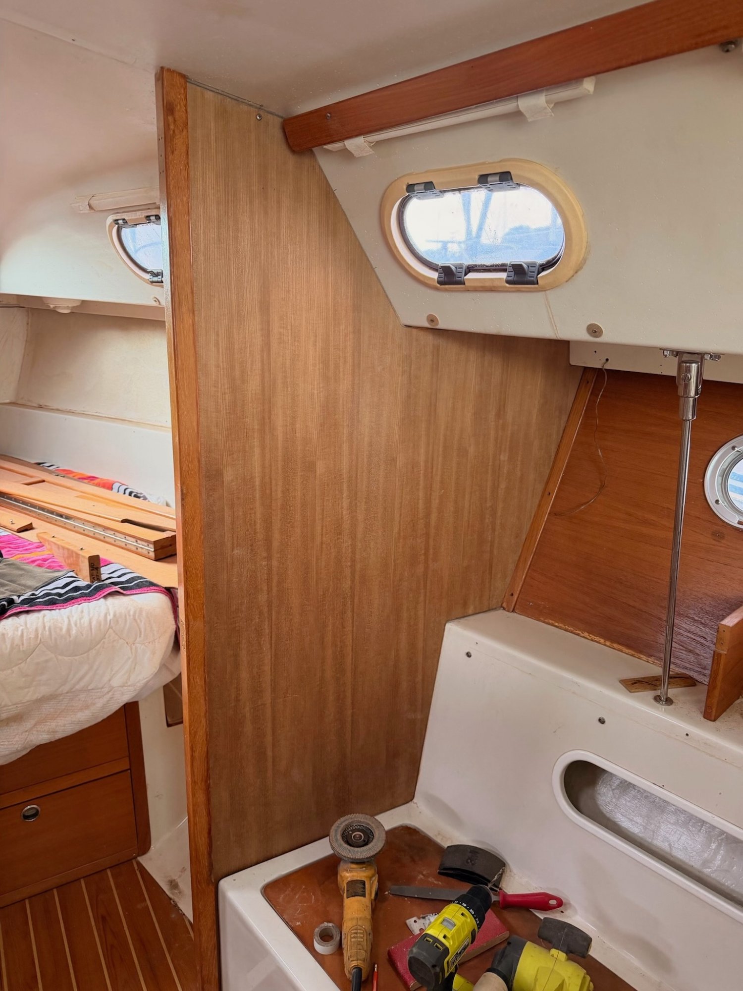

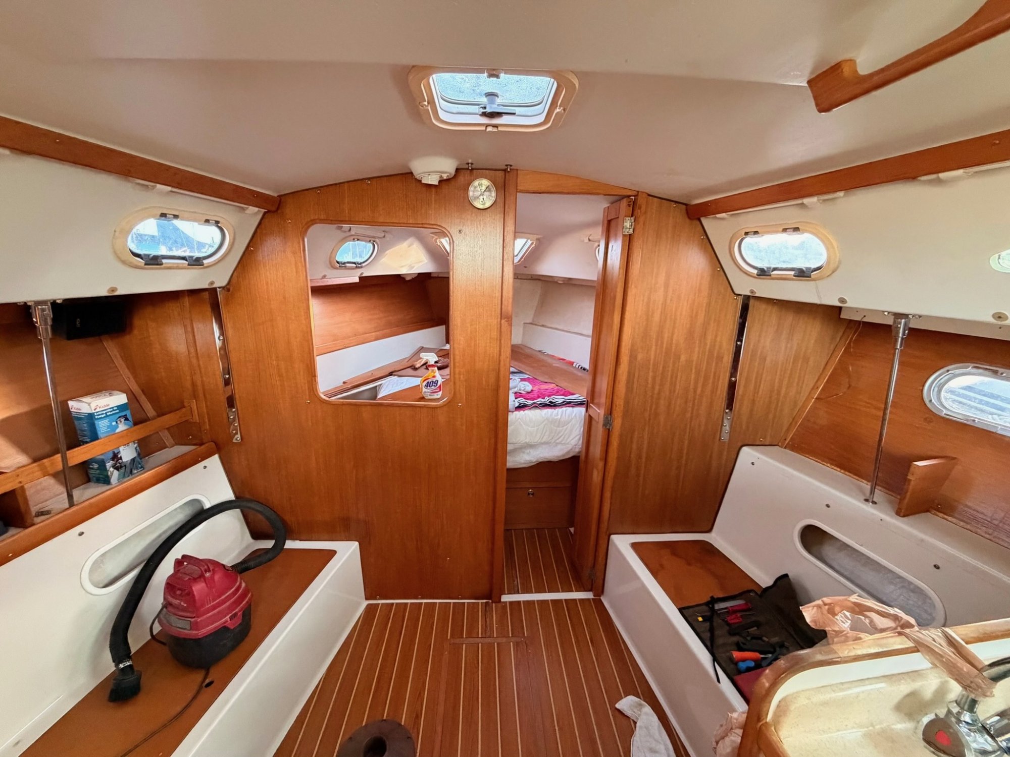

The project progresses; thanks for all the photos, guidance and suggestions from your experience.

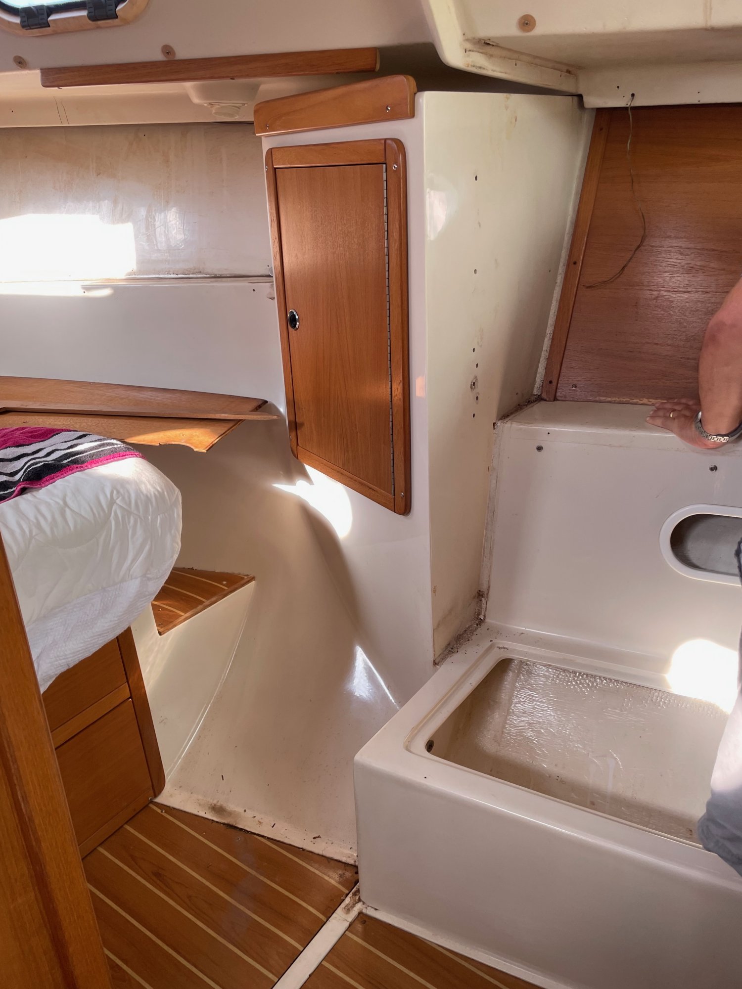

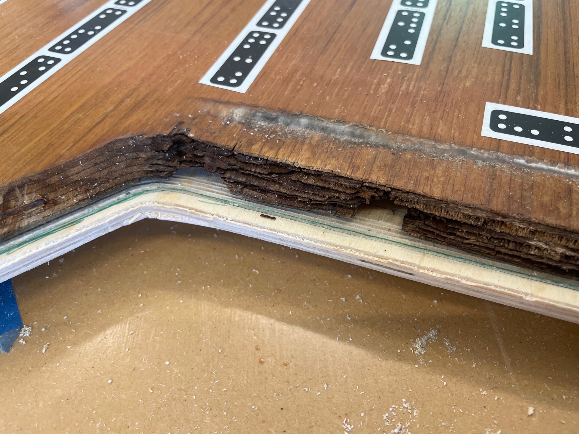

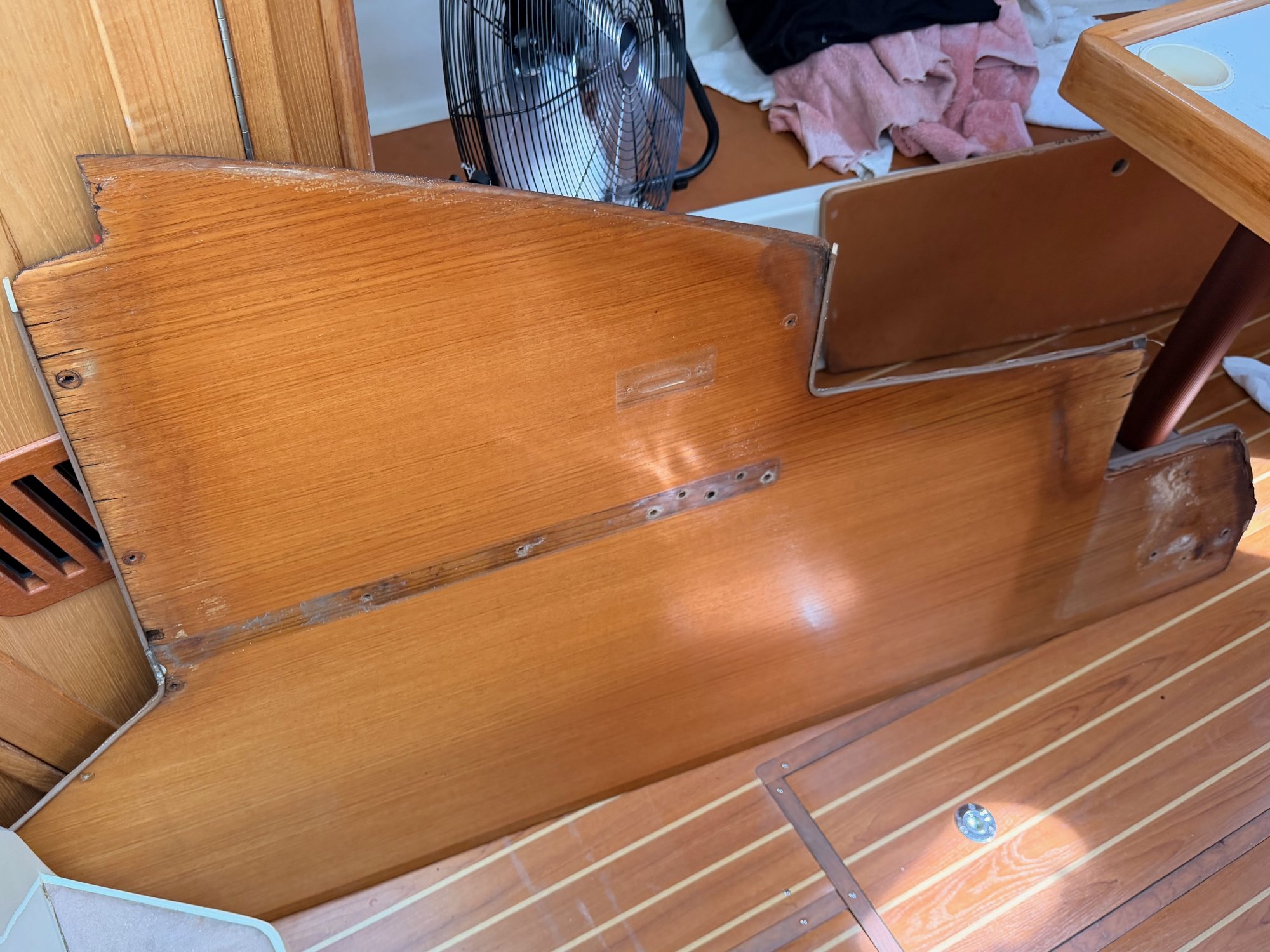

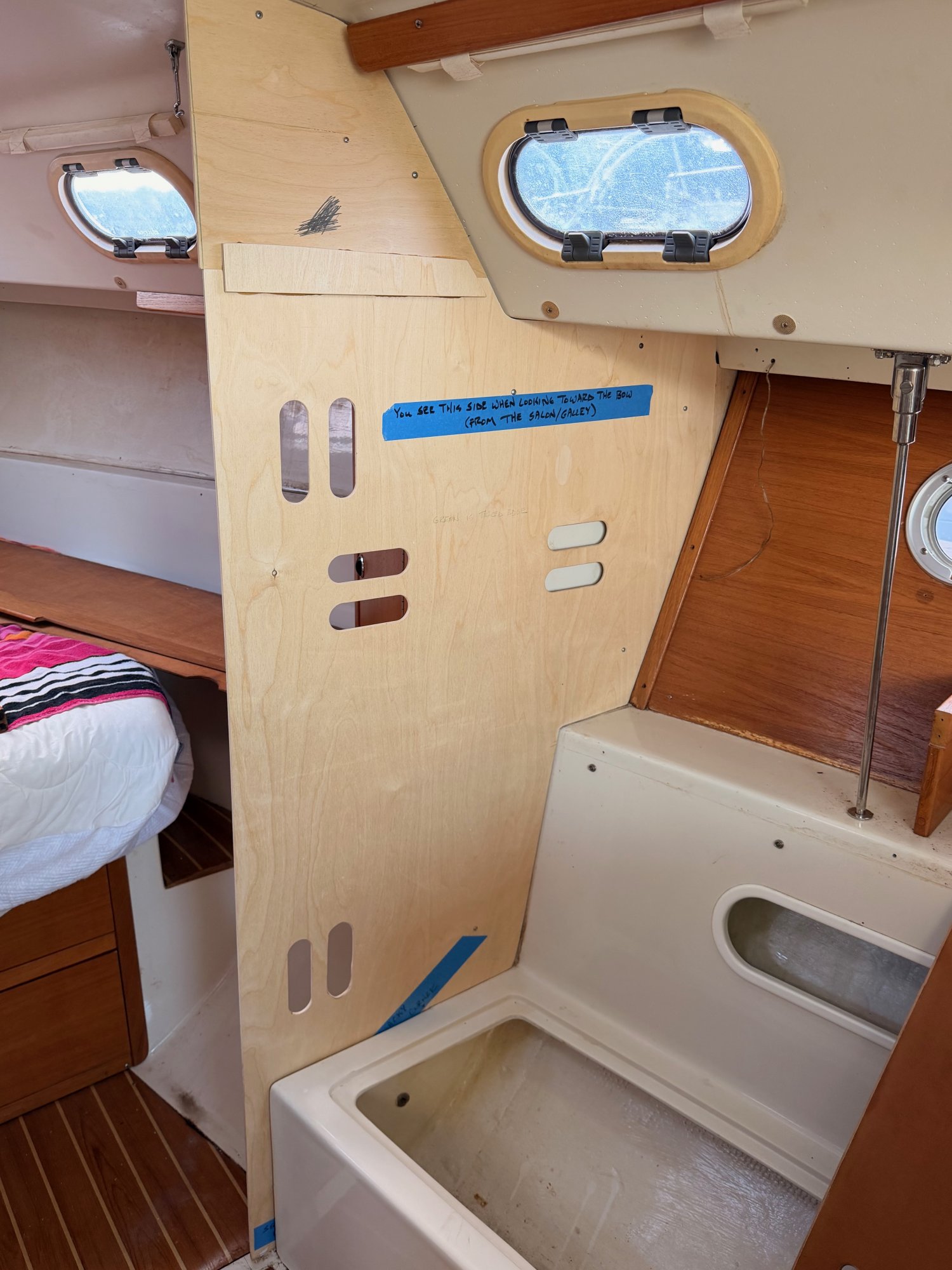

The mast is down and the chainplates are out. The deck and port bulkhead are fine and the starboard one needs replacing, (and our project is "in time" as all the hardware is still in great condition). We've pulled everything out and found the edges of the piece to be replaced very brittle from water damage but firm at the anchor points with the exception of the very top, (it was 1/2" thick). While we're waiting for delivery of our new bulkhead panel, I've built a 1/4" template to use to get the dimensions very close prior to cutting and personalizing the fit for the new panel.
I have my Target Coatings water based varnish, replacement welting and rust proof staples for the edges of the panel.

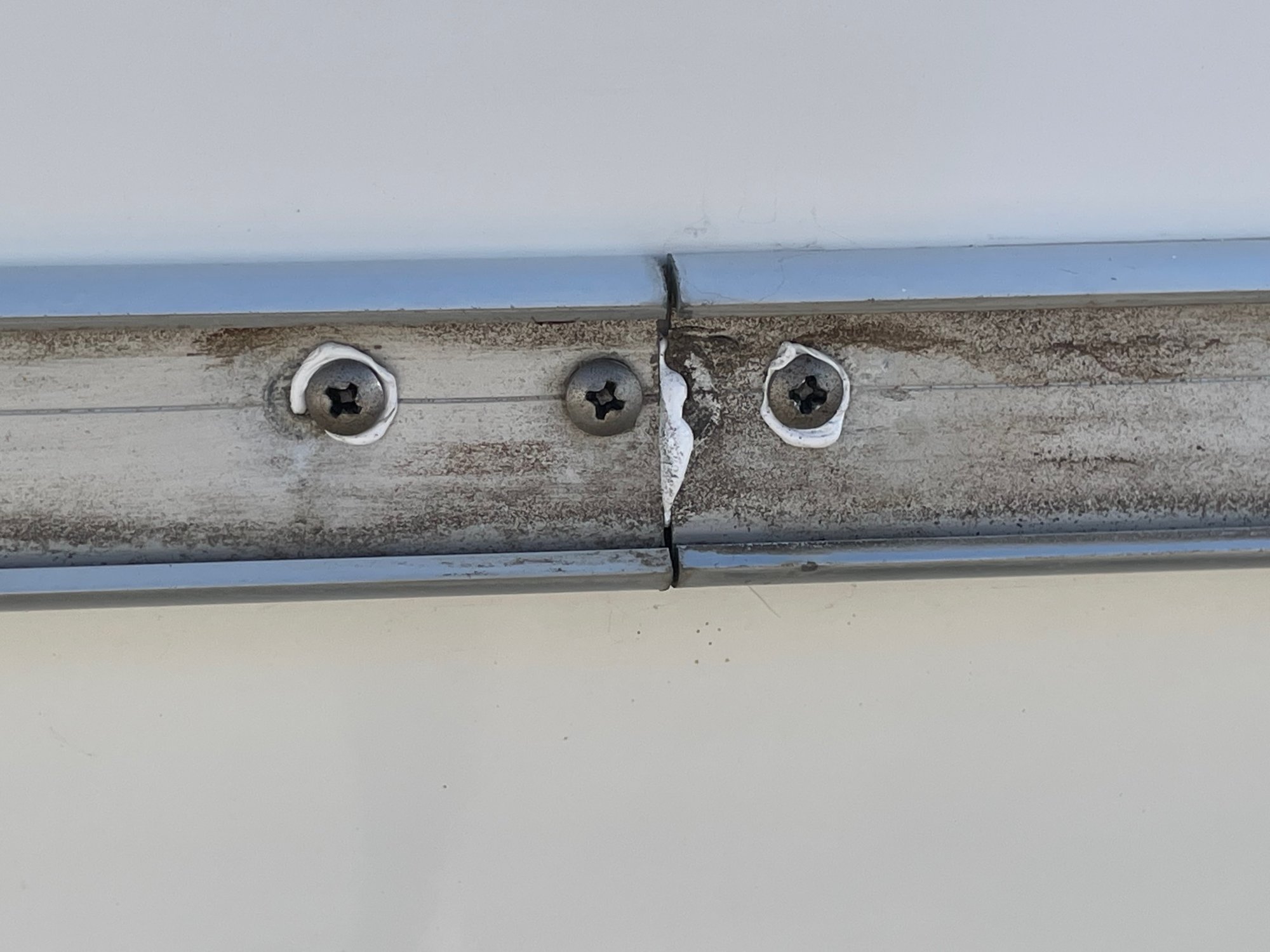

In separate news I've decided that the screws holding the rub rail bracket need re-bedding and at the end of that effort well replace the vinyl of the rub rail rather than trying to reuse the original. And finally, prior to raising the mast we'll review/repair/replace its wiring and put a new wind vane up, (all work I should have anticipated).
Todd L.
