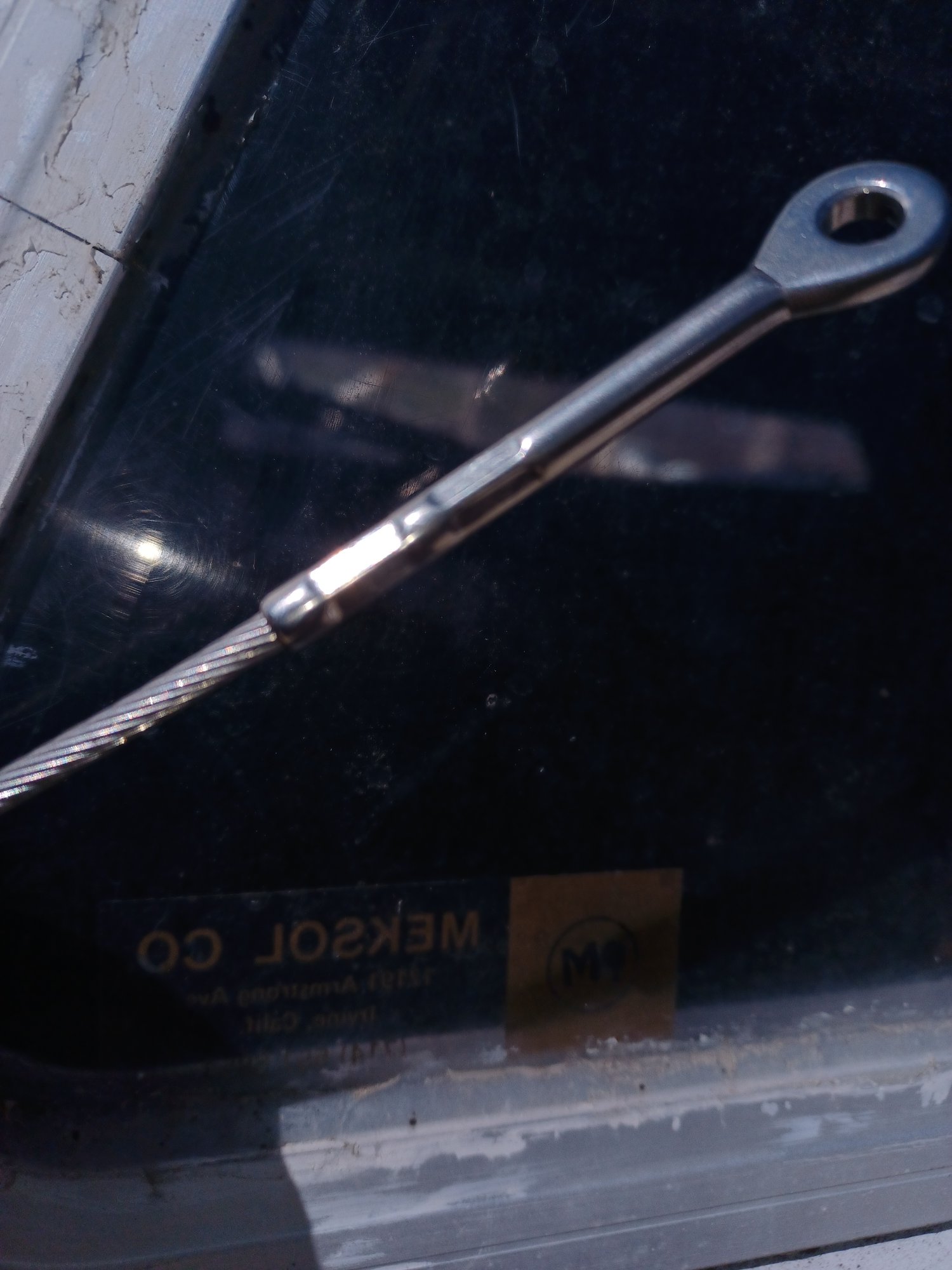

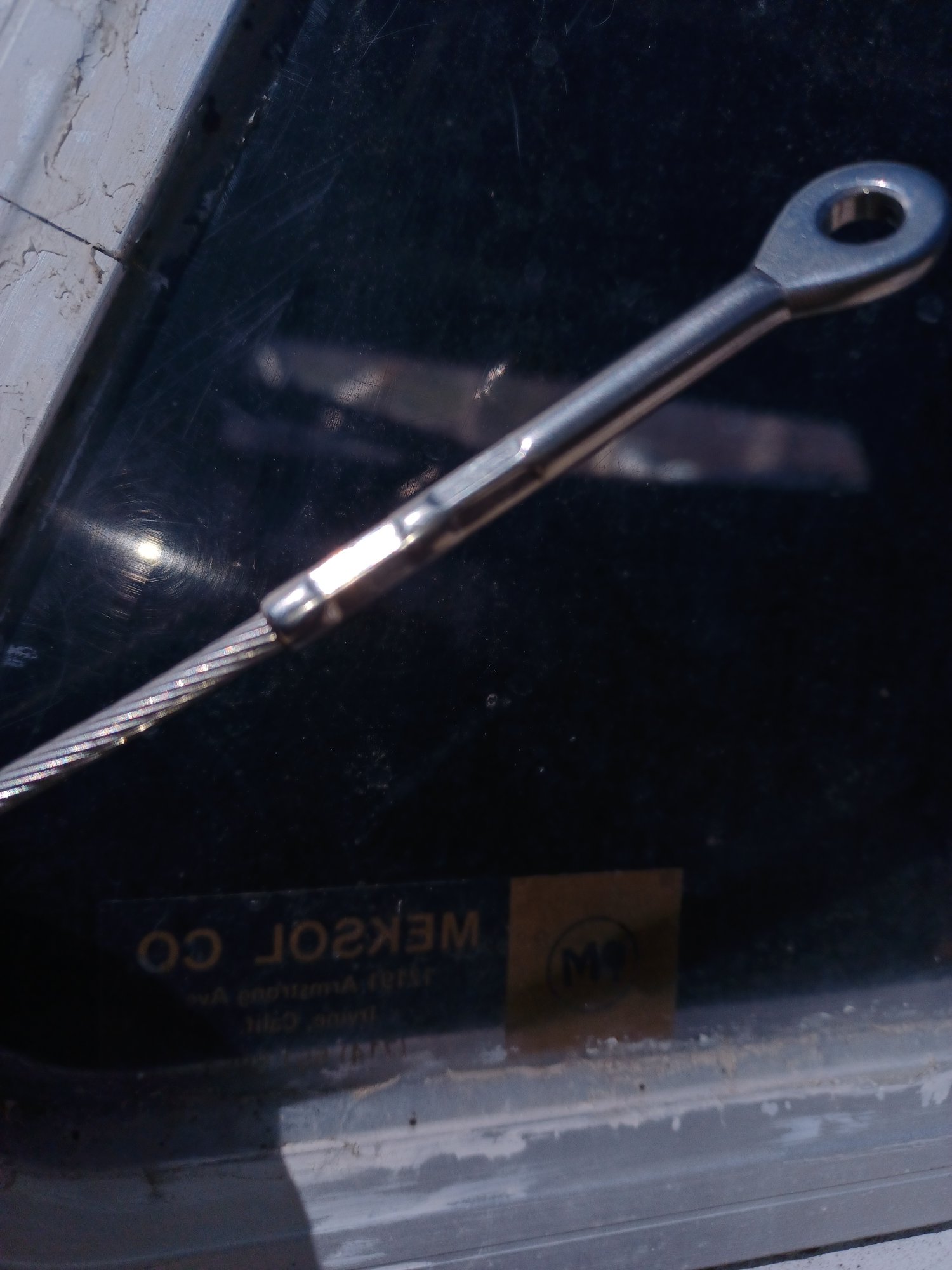

This is done with a hand powered hydraulic hex swager. I know from recent berating on the fb that it should have been roll swaged.
What are your thoughts on this? Perhaps if I swaged it the full length?
Will it work? Will I die? It's on a 21 aquarius
I chose the hex swage after watching videos of it being done this way. Was I mislead?

They look like good swages, and, being doubled, should have enough mechanical strength for a 21' boat. I wonder, though , if the hex shape of the swage might allow some moisture to intrude into the fitting. Add freezing temps and a cracked fitting could result.

They look OK but ya might want to offset the next ones so the flats of one line up with the ridges of the next one

The acid test would be to test the cable with tension. You could mark the point where the cable exits the fitting then suspend a weight for a time. If nothing moves, call it good.
In a former life I made cables for aircraft. I used an impact swager and tested the cables with a tension device.

It came from ebay for $70 same thing can be had from harbor freight. I made a paint line at the top of the fittings. I figured a light sail and check the marks will test it and give me a visual reference for a long time as to if it's moving or not.

Harbor Freight is one of my favorite stores. Make those fittings a regular inspection point and all should be fine. Thanks.
