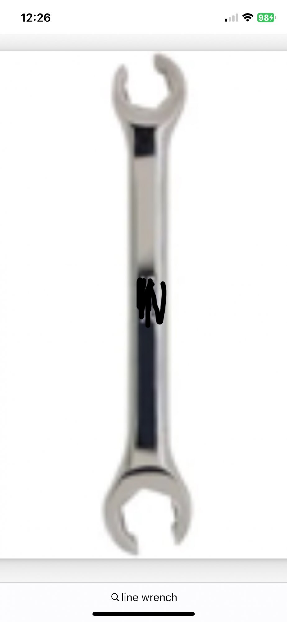

The photo below is a store bought line wrench.
The reason for using a flare nut wrench/line wrench on the stuffing box nut is because the open end wrench can deform the stuffing box nut because it is a kind of a flare nut.

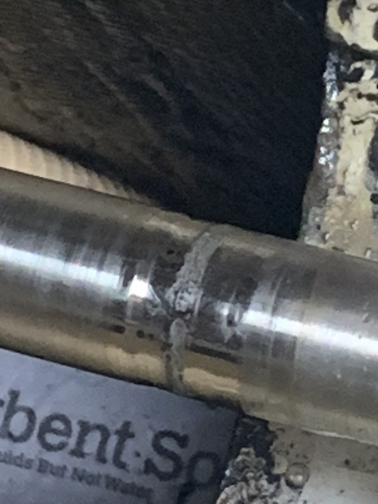

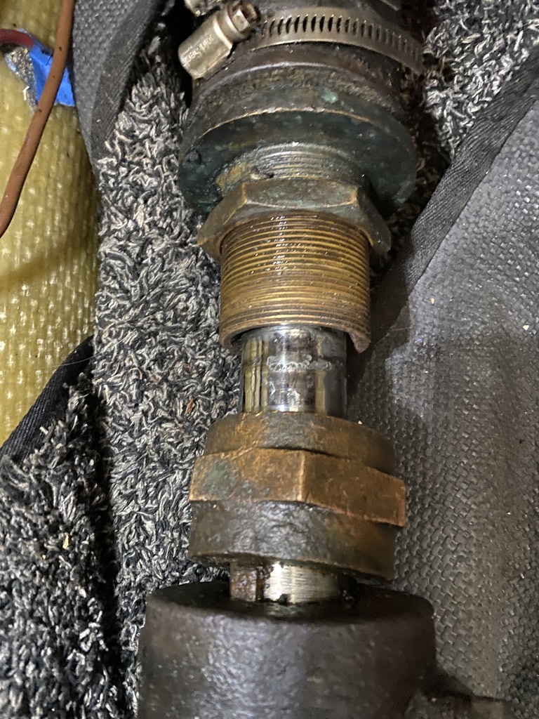

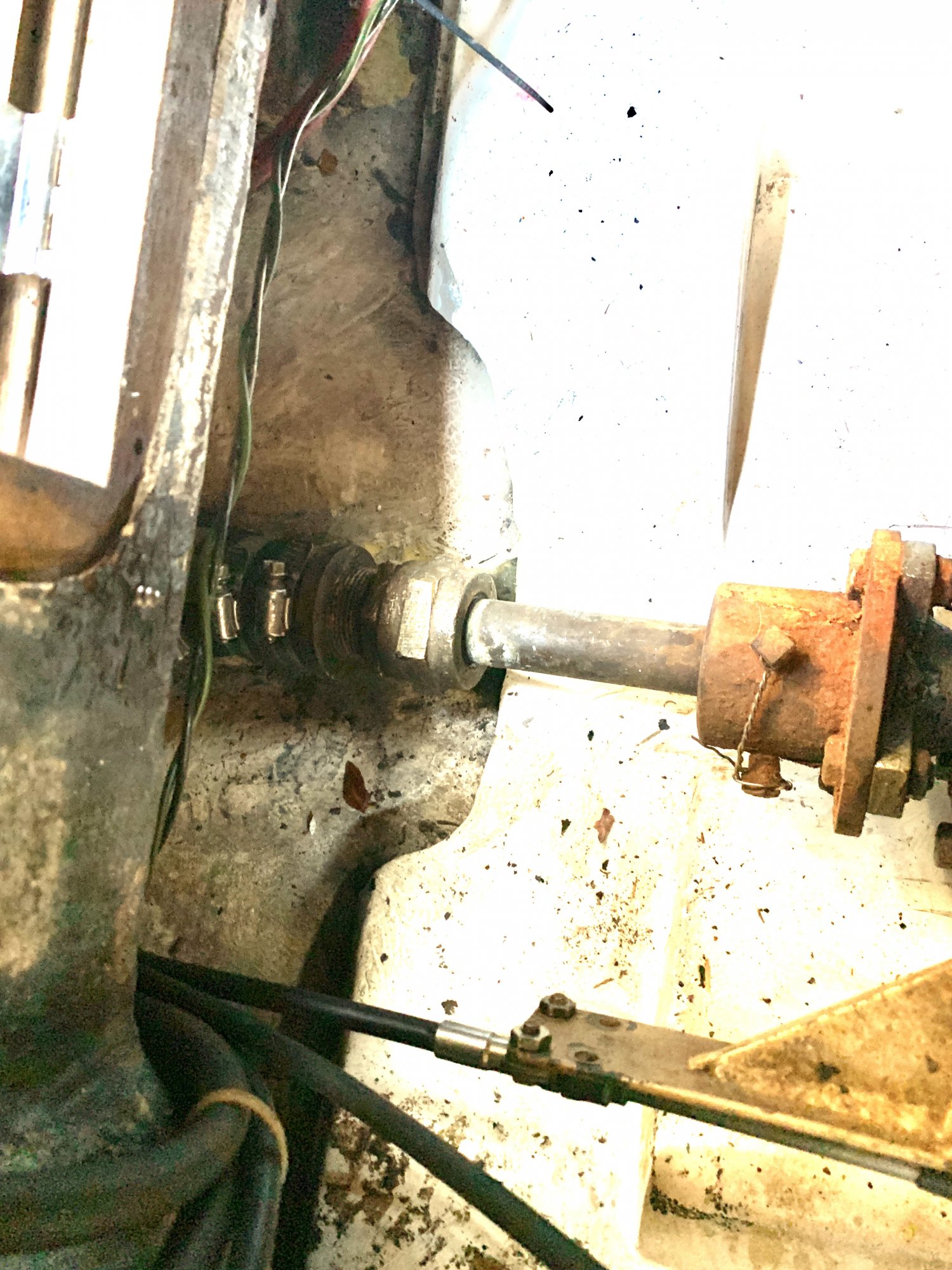

Here are some images of what I saw on my 49-year-old shaft when I started to change the stuffing box flax. I had the engine out of the boat for a rebuild. I could thoroughly inspect the shaft. (Not easy when the engine is in place.)
Just a minor pitting condition.
The shaft looks shiny. It is 1 and 3/8 inches thick.
I sail in open water, miles from safe harbors, occasionally.
This is what I discovered when I moved the shaft and exposed more of the area that was in the stuffing box.
I was not about to put my boat at risk of a lost prop and shaft.
I installed a new shaft and replaced the stuffing box with a dripless shaft seal.
