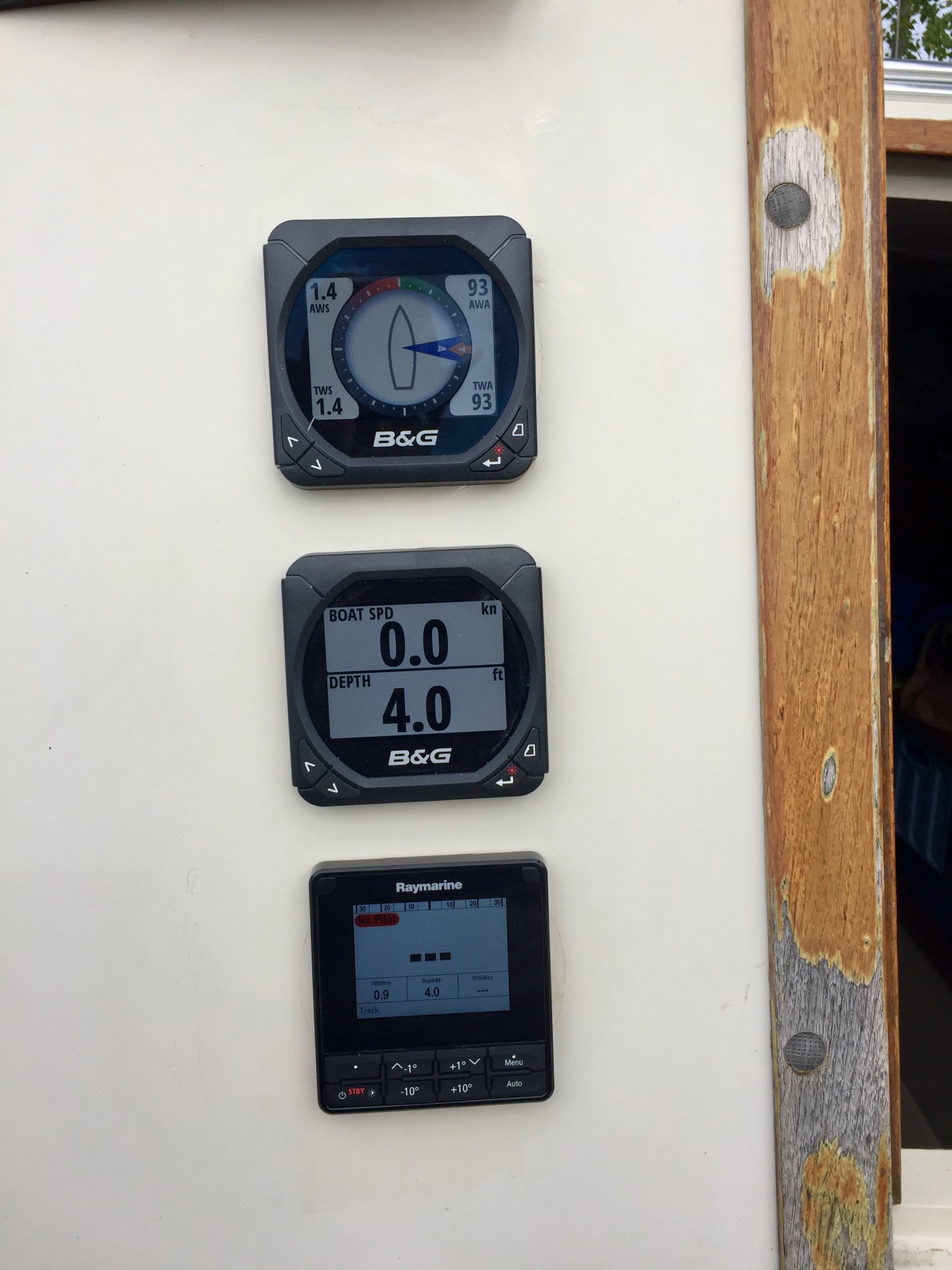

Get yourself an ITC-5 from Raymarine and a couple i70s’s. That will get speed and depth. If your lucky the wind will also be compatible.

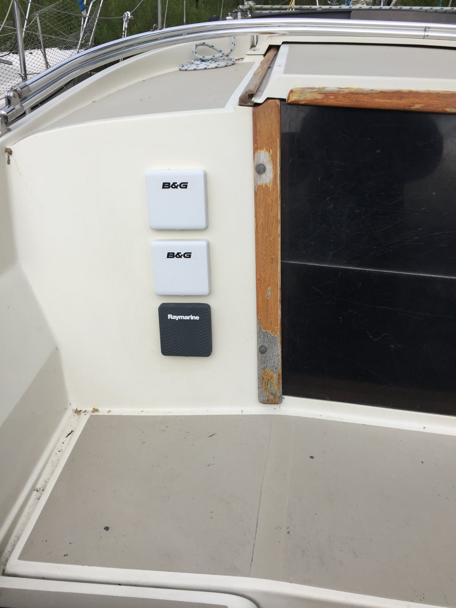

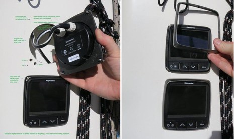

Impossible. I had large-hole Signet Marine gauges on my C36. They were repairable by the maker, but too expensive to justify for stand-alone gauges. I made nice, semi-rectangular (meaning with slightly curved edges) covers for the holes of Starboard, with 45 degree beveled edges, that fit over the holes, and were bored out to accept the new Raymarine wind, speed, and depth gauges. Looked and worked great.
If I didn't care about having everything on an instrument bus, and I had those large holes, I'd look for a set of Datamarine instruments. They are really good, and repairable, and look good.

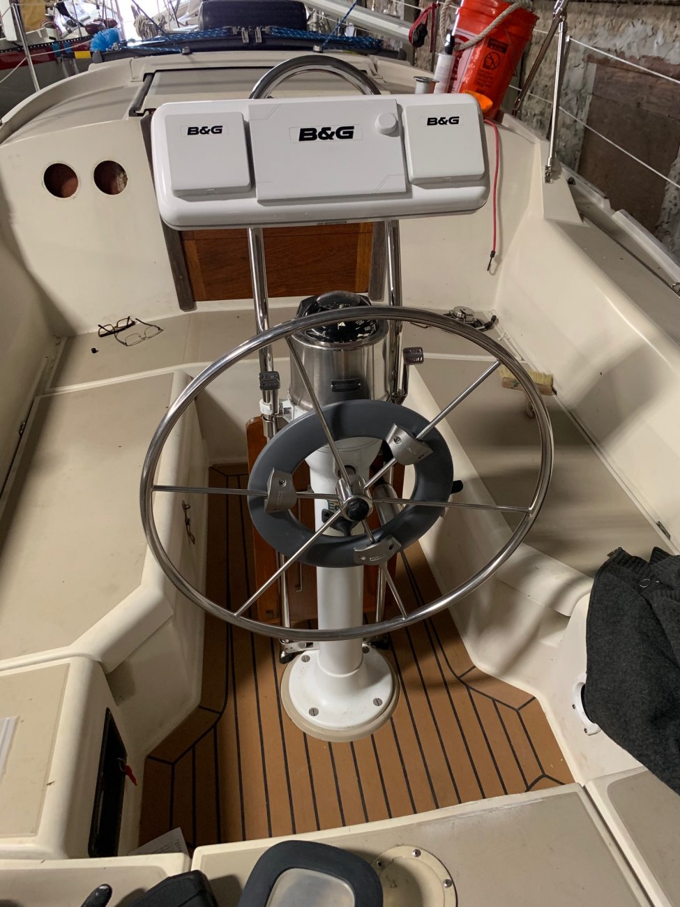

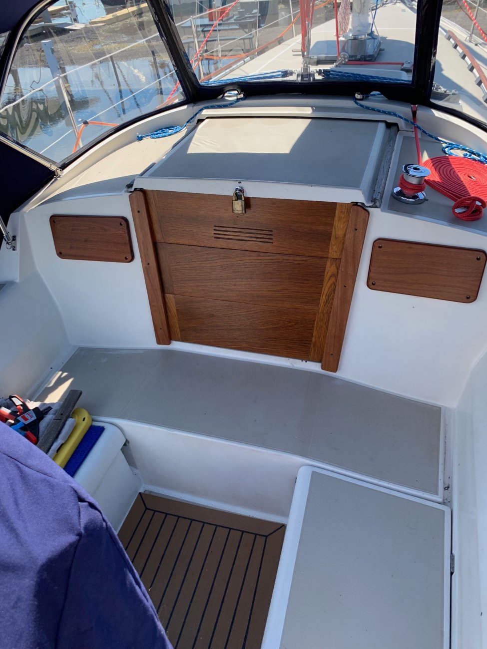

When I bought my boat I had 4 (2 water-filled and beyond repair) S/R mariners mounted on either side of the companionway. Depth would work "sometimes" So ..... I added a Nav pod and placed the new instruments at the helm where my old eyes can see them. They are never obstructed by a coiled line or a body as was the case often is when mounted on the bulkhead. I temporarily installed 2 mahogany blanks, (wife is happy again holes are covered) over the coming winter layup I am installing 2 portlights that will cover the holes. I never considered fiberglass knowing it would never look good and would be a ton of work. The new portlights will be under the dodger and will allow me to keep them open for ventilation and will add some much-needed light in the galley and @ the Nav station. IMG_0669.JPG 414BA4D0-5240-44DD-AA2F-E25D9F1D6725.JPG

Nice job, David! I had considered port lights that on my C36, but I was running out of steam, and my instruments were mounted one to starboard, and two two port, vertically, kind of.
I considered a horizontal pod across the companionway, forward, under the dodger, as I'd seen that on some racing boats - so crew can see them as well as helmsman. The new Raymarine instruments ore very easy to read.

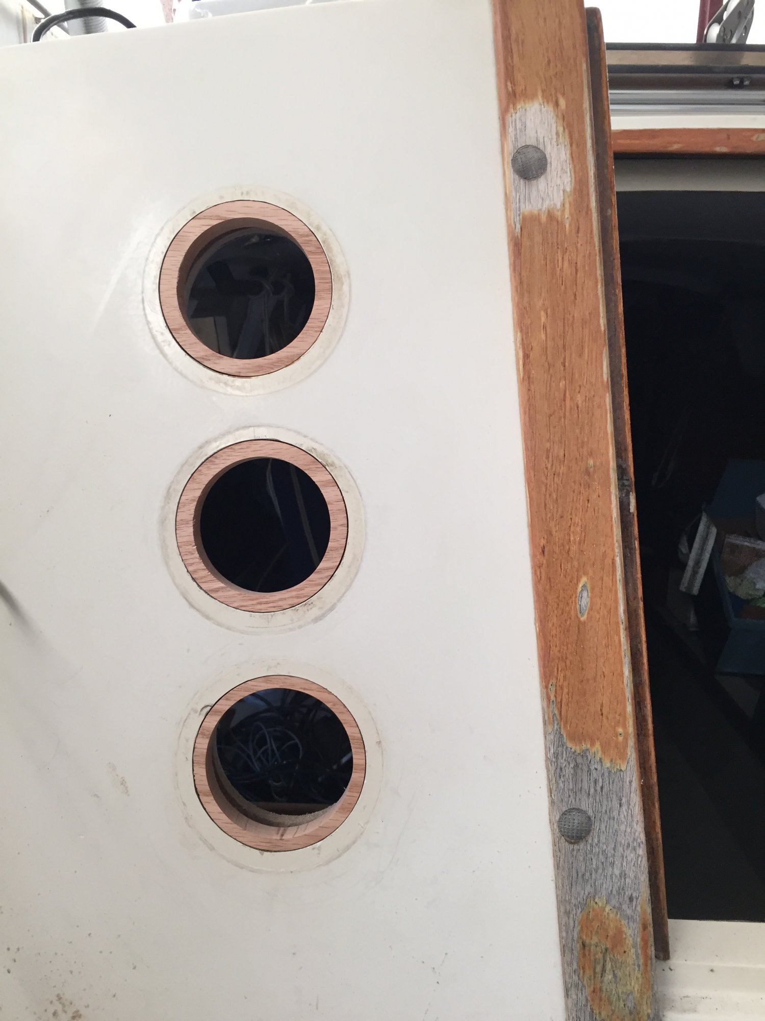

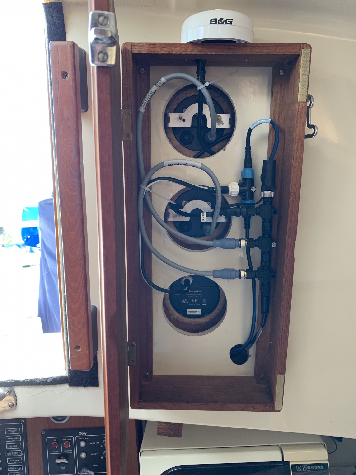

I had similar issues with OE Datamarine instruments in the port bulkhead. Found a deal on B&G package with 2 MFDs, wind/DST/GPS and decided to add the Ray AP control head instead of leaving a blank hole. Had a relative with a CNC router make spacer rings out of 3/4in oak that I epoxied in place with West Six10. Really appreciate having more info on TWA/AWA and an AP that can point to the wind for hoisting sails. Now I need to tackle the brightwork...

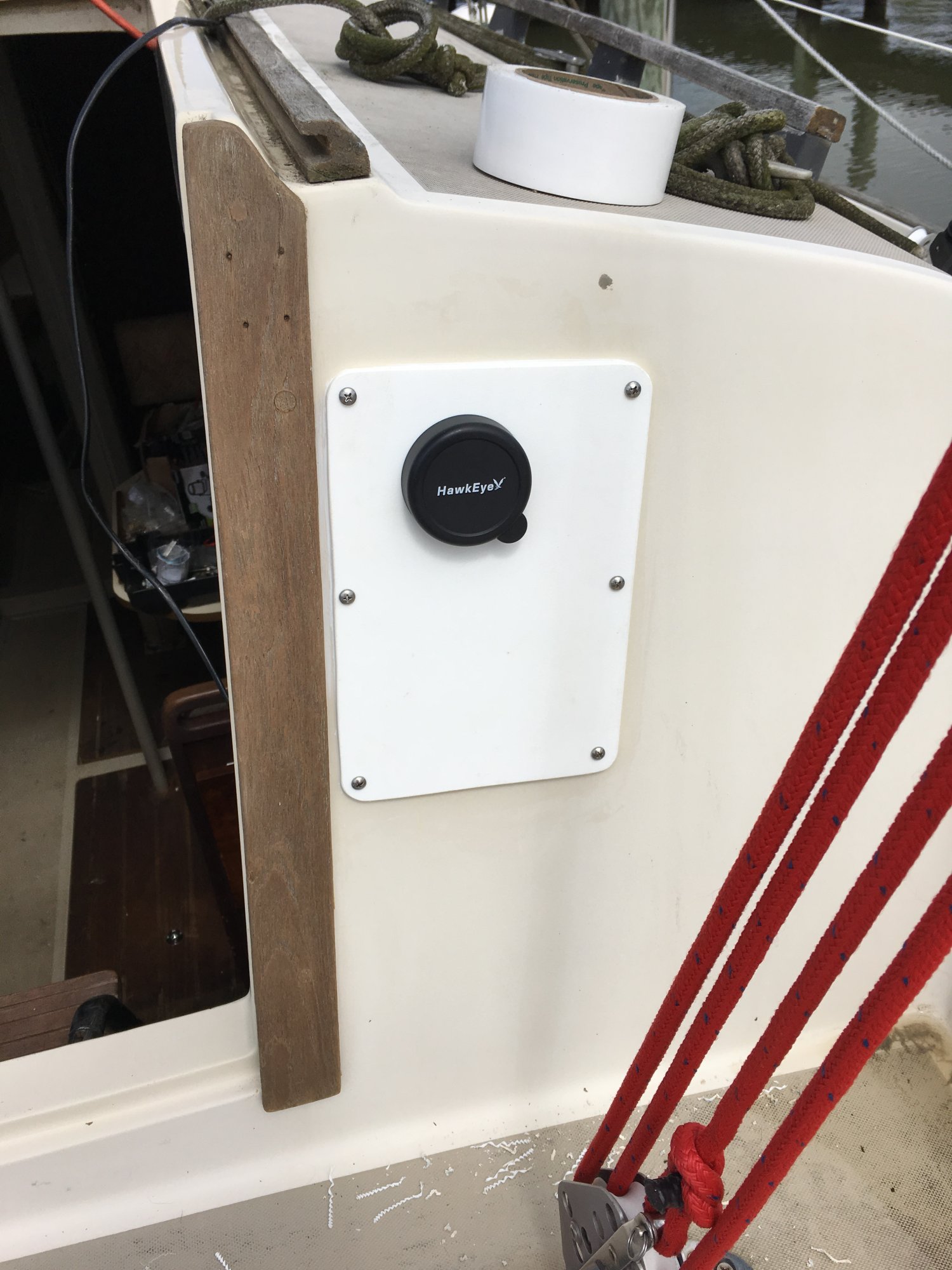

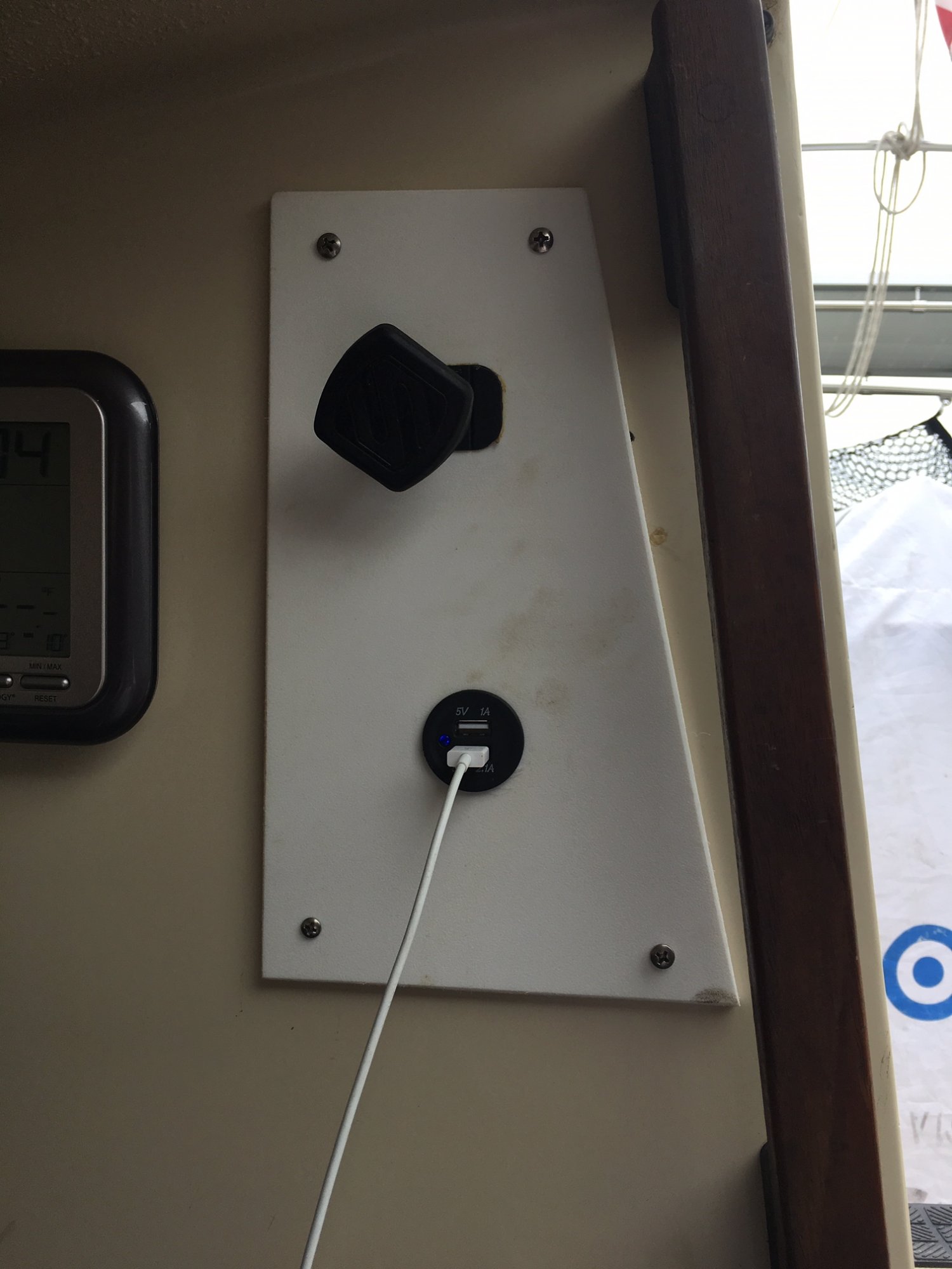

I never did show what I did. On the Starboard side there was two instruments which were trash. A depth and a speed. I removed them both. The previous owner had donated a ton of stuff, including a Hawkeye depth gauge with transducer. I kept the original depth wire in place. It had a male RCA jack on the end to go into the old instrument gauge. I made a connecting wire, One end a female RCA and the other a male 8mm jack. The Hawkeye has a female 8mm receptacle. Before and real installation was done, I powered it all up and it worked. Here is my end result. The starboard covers both holes. I used screws and 4200. On the inside cabin wall I made a cover plate, also covering both holes, but with a scooch cell phone magnets system and a USB outlets so I can charge my phone or my Ipad Mini
