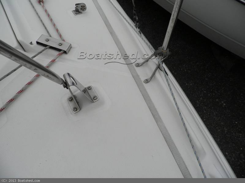

Ours have 3 fasteners. The largest is a bolt that goes up from under the toerail. The other 2 are threaded into the aluminum piece molded into the fiberglass. The biggest issue I've seen is the stainless screws seizing in the aluminum. That's why I recommend using anitseize compound. and that's why you need the impact screwdriver. First clean up the threads with a tap. It sounds like the fastener has stripped out. If that's the case drill up one size and re-tap. Then be sure to use the anitseize to keep the problem from coming back.
I also see that you think it's 3M 5200 sealed. That stuff never gets brittle so you won't fracture it with a hammer. It may however be difficult to clean off to prep for your new sealant.
If it's just tapped into fiberglass I'd look for another method of repair. Threads in glass or even in epoxy aren't suitable for a lifeline sanction, but I'd be willing to bet there is aluminum buried in there.
Ours is a 1989 H 30 I found a pick online that looks like ours:
