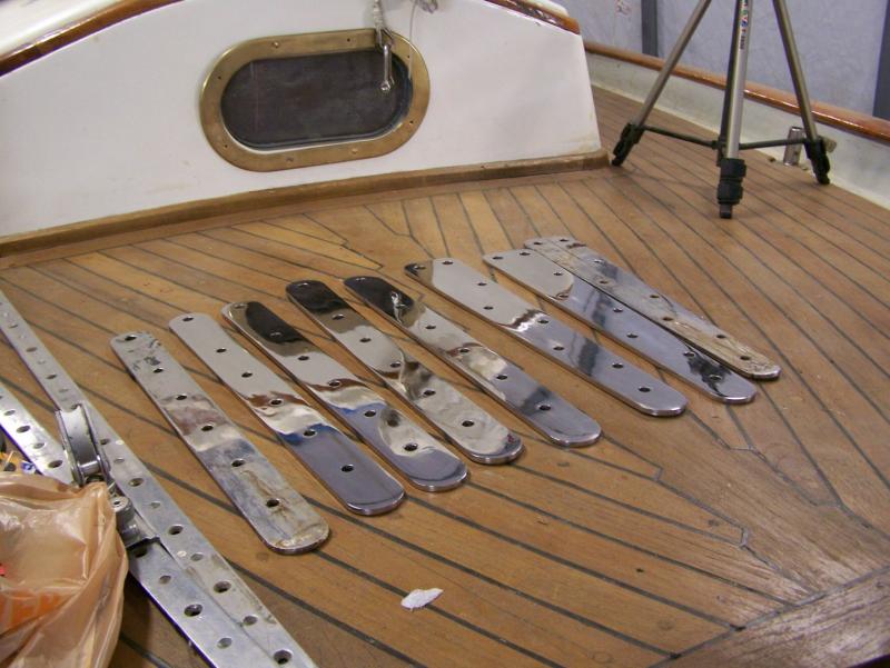

Baba 30 Minneapolis
316, plasma cut and polished.
I am surprised how nice the plasma cut came out. They went a little overboard on the polishing, but I'm not complaining!
