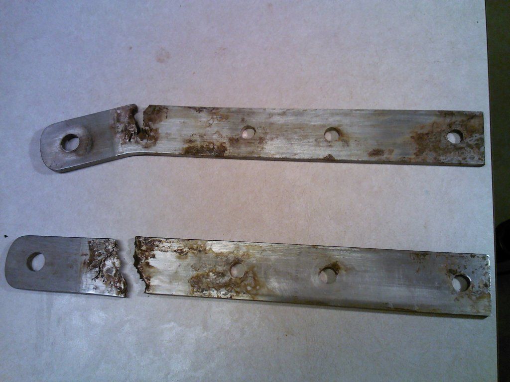

When we bought the Pearson 6 months ago I checked the chainplates visually. The Pearson has larger 4 bolt chainplates for the upper shrouds and 3 bolt chainplates for the lower shrouds. They looked good, no corrosion visable, they actually looked really good. We sail often and have never had a problem. Fast forward 6 months and we are crossing the Gulf from Carrabelle to Tarpon Springs Florida. We had a great weather window, less than 1 foot and winds 5 to 10 knots. We checked several sources and the weather window looked solid. We start off and it may have been a little more than 1 foot but nothing to get worried about. We are having an awesome sail, doing a solid 6 to 7 knots but the wind is a little to much on our nose, still a good sail. About 25 miles out we hit a dark line of thunderstorms and it is only 10 am. Lowered the main, brought in the genoa and motored through the thunderstorm. It was pretty nasty, white flashes that were so close you could hear the hiss before the boom. The seas kicked up a little and the wind stiffened after we got through the storm. We ended up going through three pretty large thunderstorms and by the time we got 50 miles off shore the seas had built to 8 foot and the wind was howling directly onto our nose. I told my wife that we could sail towards Cedar Key and perhaps the seas would die down a but when we got out of the middle of the Gulf. So I reefed the main and only let out half of the genoa. We were making 6.5 knots and the boat was handling the 8 foot seas with no problem. The swells were constant and close together. As we came over one swell, we go hit with a really solid gust. It pushed the rail into the water but it was not that big of a deal, we had been sailing with the rail close to or in the water most of the day. When we came down the other side of the swell the boat came out of being heeled over as much as it was. My wife said, Dave the baby stay! I looked over and saw that the aft lower shroud on the starboard side was swinging against the boom. My wife took the helm and pulled in the genoa as I went and lowered the main. We motored the boat back and anchored behind Dog Island for the night. The wind howled all night long. The thunderstorms really brought in some weather. It would have been a really rough night crossing to Tarpon Springs had we continued. My wife asked me what we wanted to do now? We had given up our slip in Carrabelle so we could move the boat over to St. Augustine for a change in scenery. I told her that Panama City sounds like a great place to keep our boat. So we motored over and decided to make the city marina our home now.
I pulled the broken chainplate that snapped right at the deck level. I also pulled one from the port side so I could have replacements made. It only cost me $25 for each chainplate to be water jetted using my good one as a template. While researching the best stainless to use, I read several articles about stainless. I read that when stainless is deprived of oxygen, as we do when we bed them and make the area water proof, the stainless will corrode from the inside out. I also read that they have a serviceable life of about 10 to 15 years. I am pretty sure these are the original stainless chainplates from 1982. Well the starboard aft lower shroud plate snapped right where it was bedded. When we remove all the plates we found the forward lower plate on the starboard side was pulling apart too. We were hit with the big gust on the starboard. All the port plates were solid.
Anyway, A word of caution if you have 20+ year old stainless steel chainplates. They could look great and be corroding from the inside out where they are bedded through the deck.

The original chainplates were 316 but it is very possible they used 304 as most builders did at that time. In researching I had read that Pearson used high quality stainless, which leads me to believe it was 316. The replacements are 316 and the new bolts are 316. The originals were 30 years old, way past their serviceable life. They were very easy to remove and replace on this boat. I think in the not so distant future I will be switching them to bronze. I wanted to get the boat back to sailing quickly so I had them duplicate the Stainless. I need to do some more research to see if the bronze needs to be thicker?

These look pretty corroded to me pal.
Am I looking at the backside of the plates? Notice the area of greatest stress & corrosion are in the same spot.
I can tell you from the pictures that they are a cheaper grade of stainless as evident by color & corrosion. I'm surprised you didn't see telltale signs. Had you removed a bolt or two at some time to check, You may have caught this earlier.
Boats built in the 80's did not have too much in the way of quality control. Many builders skimmped where they could as profit margins were thin. My 1980 C30 had alot of subpar stainless. Twice my bowsprit support plates broke almost losing my mast. I only use 316 ss & alot of replacements I have a fab shop do, instead of buying from the manufacturer.
As a side note, I had a new bobstay made from Nitronic 50. A 1/4" dia. solid rod with a 43,000 lb tensil breaking strength. But make sure you only use 316 ss pal.

I forgot to mention that the lower the number of ss grade, the higher the percentage of carbon steel in the mix. All stainless has some carbon steel.
304 stainless is the worst, for if the finished coating, edges, or drilled holes left compromised, just add air, moisture & stress over time and viola, you have corrosion/rust & eventual failure.
And remember, looking at the pics of the failed chainplates this rust, corrosion & failure are very self evident.
