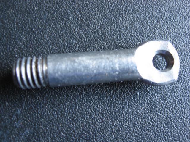

Oxalic Acid vs. SS Rust
Maine Sail:
Have you ever tried cleaning the SS with Oxalic Acid? It is listed as a possilble cleaner for SS, but I am wondering how well it works compared to some of these other products.
I'm also intrigued because I've had success with oxalic acid removing rust stains from sails and also from anti-skid areas of my deck that were subject to years of constant dripping of rain and seawater off now replaced old SS standing rigging.
I happened to be home when I saw your query. In my garage stock of safe-and-sound (well probably not all of them) home chemicals, I had oxalic acid crystals. Disolved some in jar with water and placed in a surface-rusted SS shackle pin. 20 minutes later the rust was in fact gone. (See attached pics).
BUT, I also put some of the oxalic solution on a weld on the underneath side of a cheek block that had some rust in the weld crevices. The rust disappeared, but the before the surrounding SS surface was very shiny, almost mirror-like. After the application, the surface was dull. I suspect that the oxalic acid also has etched SS a bit, indicating maybe a quick return to surface rust? It doesn't look like the surface will be chemically passivated which is the expectation from the "Spotless Stainless" product.
I'll attach the cleaned shackle to the base of a stanchion on my boat and observe it over the next few weeks and months.

hard to tell from those pics (kinda blury) but it looks like the pitting might have been there from the begining, and maybe that's why it isn't as shiny?
Jun 21, 2007
2,118
Dear Fourpoints:
The finish dulling I observed was on the ss backside of a check block that before the oxalic acid was really shiny -- except for the little bid of rust around a weld spot. After the acid the rust was gone. But also the shiny adjacent surface was converted to much duller metal gray.
I did not take a picture of this because the difference just wouldn't have been picked up by a camera. But yes, I've got to learn the close-up focussing technique on my camera better. The close-up mode seems to be tempermental. This time, the background surface is in perfect focus but the object is a bit bluring. Anyway, the pics do show: Rust before ... No rust after.

Have you tried polishing the block? I am wondering if it is some residual from the oxalic acid. There was no mention of this in ANY article that I read about it.
Oxalic acid is one of the primary ingredients in non-skid deck wash. You can purchase oxalic acid for about $4-5/lb. I doubt that the quart bottle that you purchase from your favorite marine store has more than a couple of ounces in a single bottle.

I have indeed used oxalic acid on stainless but quite by accident. It seriously dulled the finish and then caused it to rust at a rate that was drastically faster than before I hit it with the acid and I literally had to remove the item from the boat and bring it home and polish it on my bench polisher. It will remove the rust but it also removes something else that is helping it seal itself from the rust..
As I mentioned before the only two acids that will re-passivate stainless are nitric and citric. I suspect that more potent acids like oxalic attacks the chromium leaving the stainless less able to build a chromium oxide layer thus sealing itself and preventing rust.
