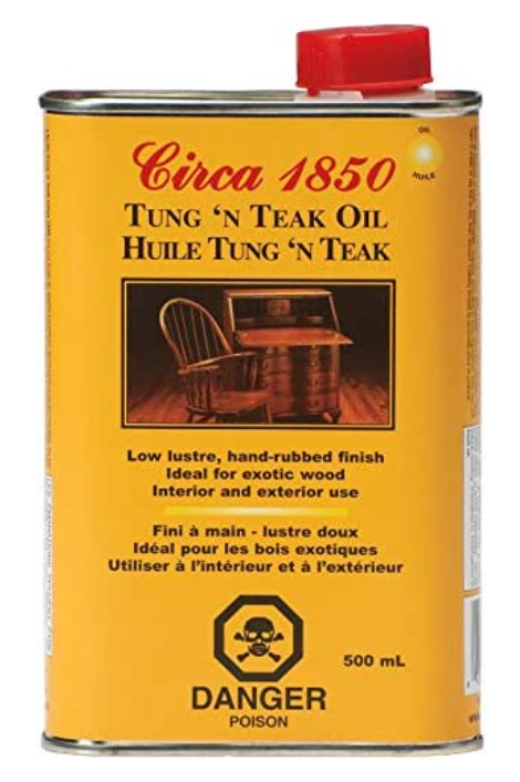

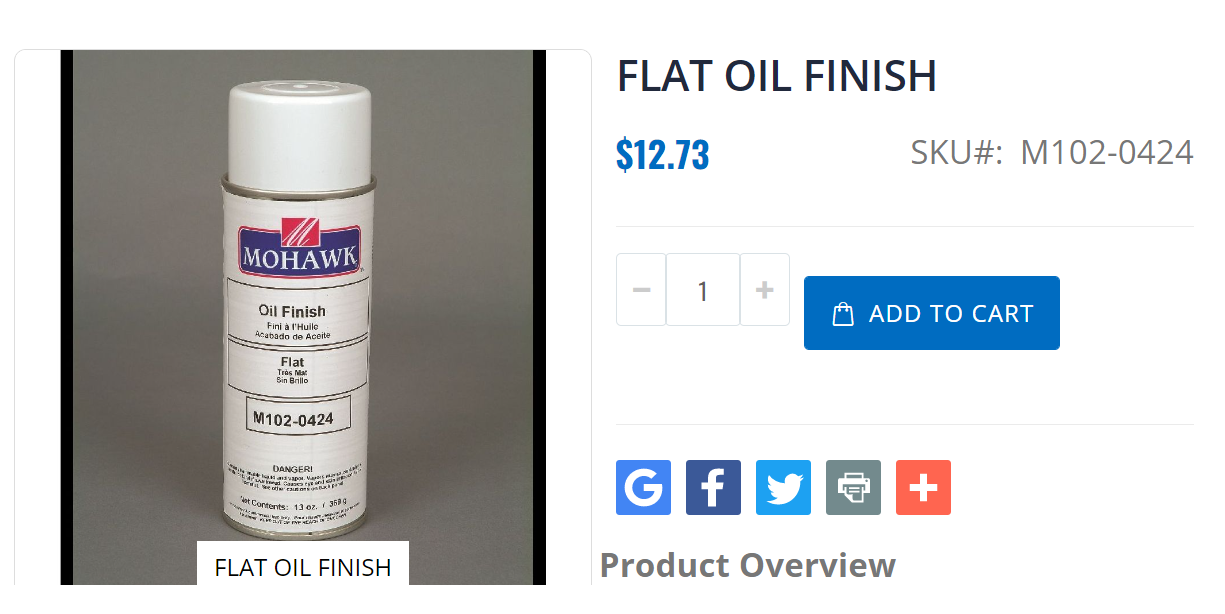

On my 2002 356 I was referred to the Mohawk line of products.
This is what you would have been referred to for repairs:
Same thing as I use (and finally remembered) :
I'm sure they're both the same thing and do a good job.
They're linseed oil, petroleum distillates, any anything else that's toxic, for teak surfaces but contains no such thing as oil which is extracted from teak.
