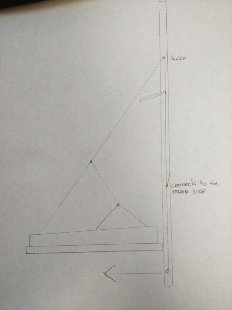

The simple drawing shows how my lazy bag control line is attached. The control is led aft to cockpit for adjustment when required.

My somewhat brief experience with lazy jacks is if you can't ease them so they open up, you have to be dead into the wind with enough blow to keep the main straight back.
Both sides of your 'jacks are attached at the mast. You may be able to do what I did: attach blocks on the mast for them to pass thru, join the two lines and run a single line back to the cockpit or cleated on the mast.

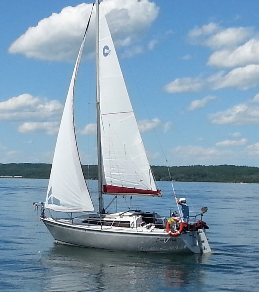

Pat,
We do have a member at the marina with 272LE and lazybag - he is out on the water all the time and to the best of my knowledge has no issues with his lazybag system. I'd say your setup needs some 'tweaking'... please note how the lazyjack lines are run on this boat.
Rick D
Jun 14, 2008
7,139
That control lineslneed to be re run so that you can easily adjust them from the deck.
Pat
Jun 7, 2004
1,250
It's interesting looking at the photo above...the 272 was always equipped with a single-line reefing system that worked very well as well as being easy to reef...when I ordered the Doyle Stack Pak, I was not so much purchasing it to be easy to reef because the boat was already easy to reef....I was more interested in the fully battened main...I'm going out again this afternoon and I'm going to take photos of both port and starboard sides of the main because to me, the photo above is set up exactly like our is currently.....more later, Pat
