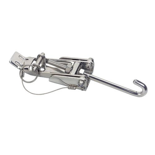

Install an anchor stop with a pin to the side in order to secure the anchor chain tight on deck. Remove the pin before deploying. No need to put the strain on the windlass.

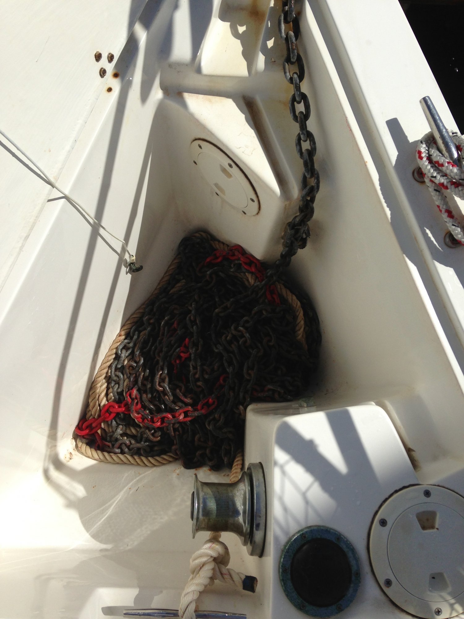

A photo of your existing setup would go miles towards coming up with a solution ............. from non Cat owners.
24,951
But the lid for the anchor well is not set up with opening on port side,
Can you change the way the anchor well lid opens? Move it to ope on the port side?
Pictures might help others think about your problem and develop a solution.

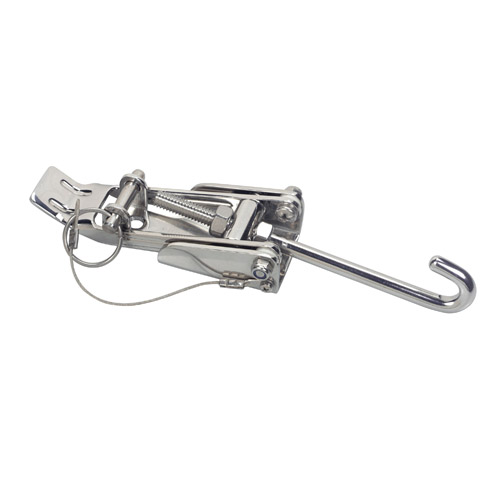

My boat came with the Bruce, but I have since gone to a Delta and then a Manson Supreme. What worked well for all my anchors was to install a snap-over-center tie down for the chain that pulls the chain tight and secures it. I mounted it on the forward bulkhead of the anchor locker, just below the cutout on the locker cover. In addition, I tie a short line through the anchor eye and the stem fitting for the fore stay for added security.
Welcome to the Catalina family!

That's similar to what I use, yes. Mine doesn't have a pin, but it should, since it has popped loose once or twice.

As I understood the issue, the OP can't run a line from the anchor to cleats, etc., to tension anchor chain, so this, I think, is a solution to keeping the anchor chain tight and the anchor in place on the roller. I also keep a small line on the stem fitting to tie through the anchor eye for additional security.

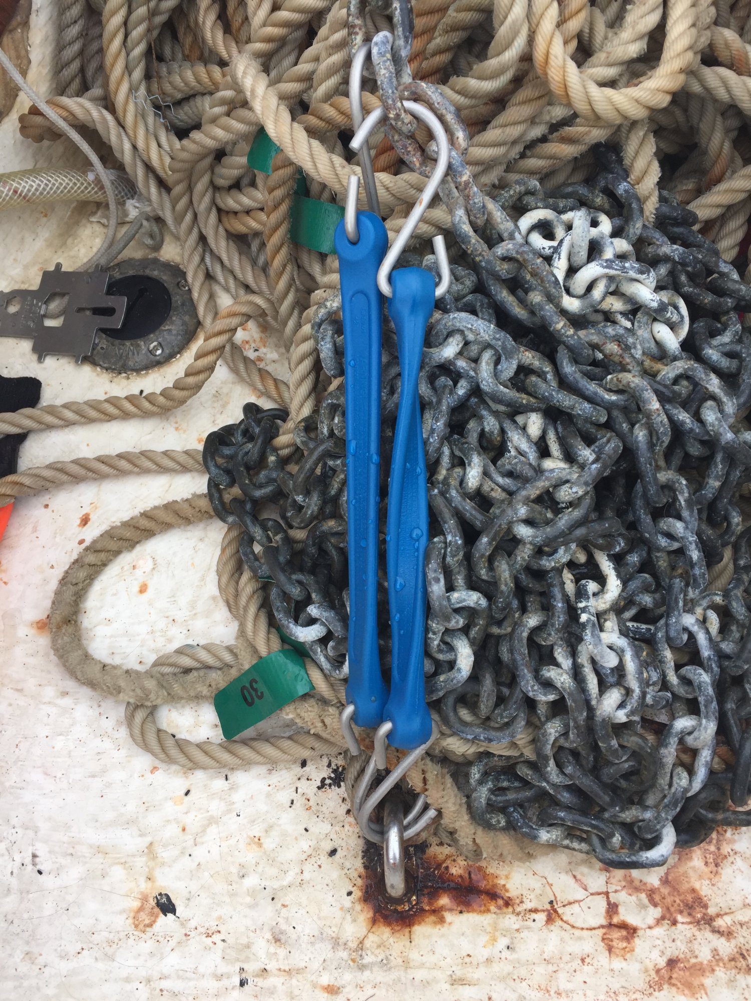

Two marine bungies with stainless hooks. Fast, simple, inexpensive, and safe.
Likes: SV At Last
