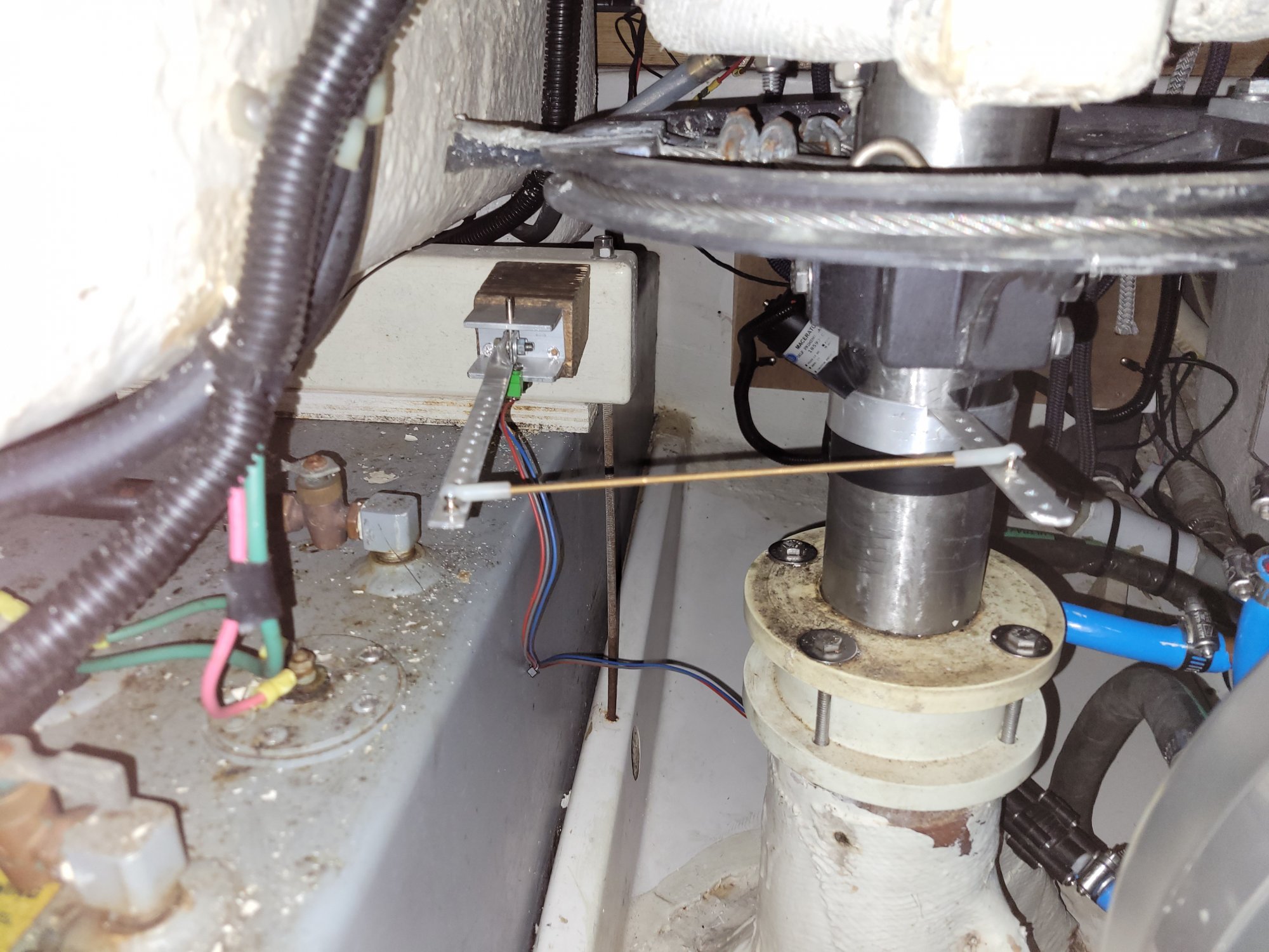

For me, it was more about the AP knowing where the rudder is.
On my set up, particularly in light winds, the AP would steer, but no steerage as boat wasn’t moving, and AP kept trying to turn, past the stops…and it kept trying.
With the rudder sensor, AP knows how far it can turn before hitting the stops.
