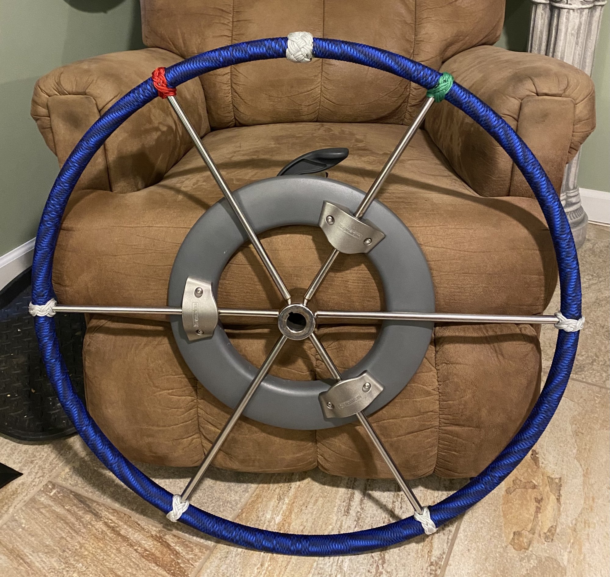

Another method is to adjust the steering cables so that one spoke of the 5 spokes is vertical when the rudder is centered. This makes it very easy to see how much rudder is being applied and how much weather helm there is.

If you want to go really super hi-tech, put a wrap of red tape on the port side of the spoke and a wrap of green on the starboard. ;):beer:
