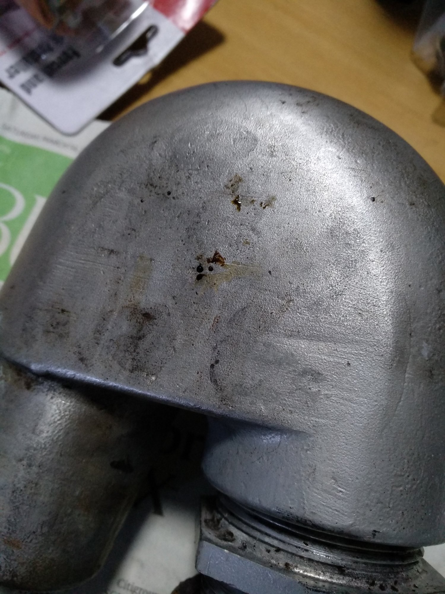

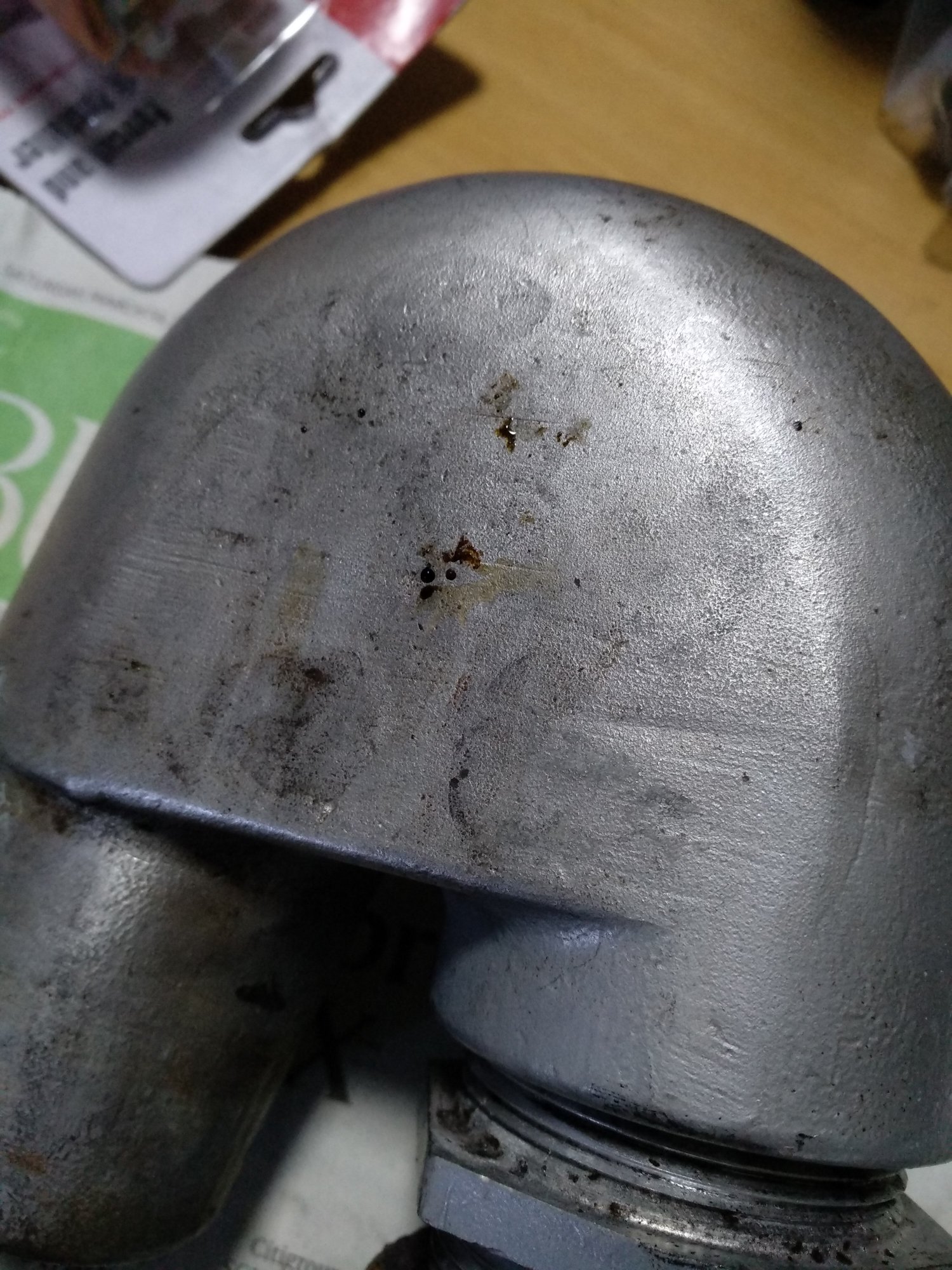

I've uses the HDI SS U-Mixing elbow for last 3 good years. Each year I remove and check, no fouling. Just last year I noted some rust stain. Didn't think much about it and clean it.
This year I noted more stain and closer, it looks like chloride stress corrosion. Small putting and crack lines. Has anyone same problem?
Hi Ken. Installed mine two years ago and have not taken it off yet to inspect. With this bit of news, I will remove it now to see what's going on if anything. Rust stain should not appear and I very much doubt it would be a precursor to stress corrosion. Cases I've dealt with are without colour. Mind you, most anything is possible with the right environment.

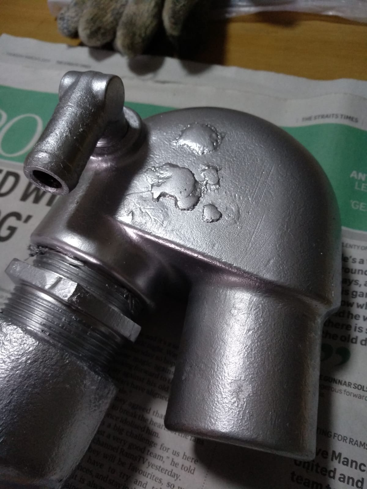

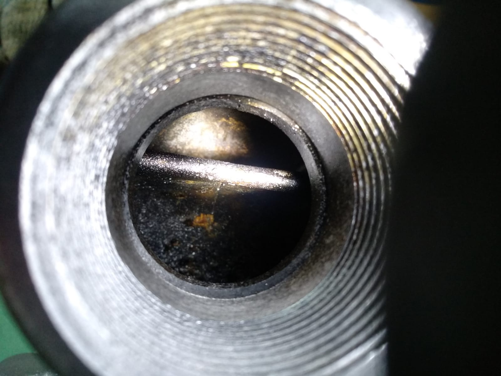

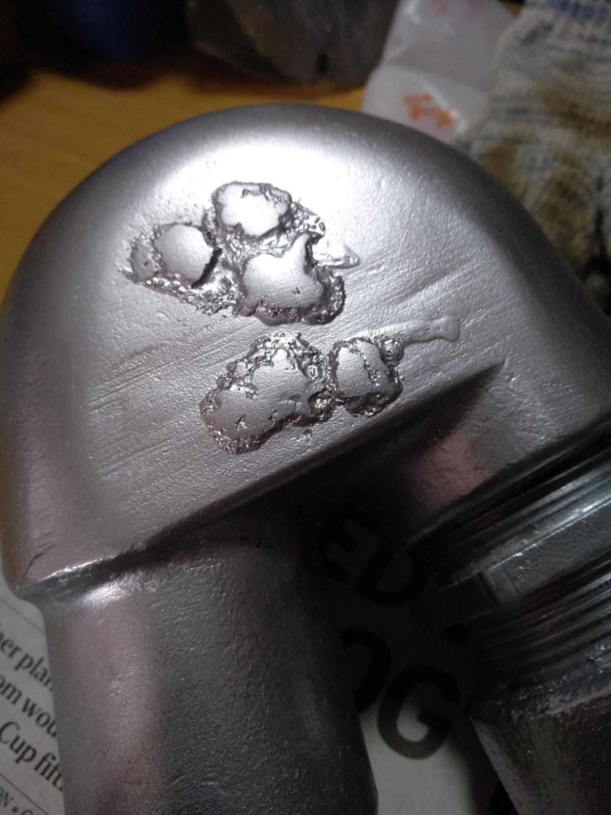

After cleaning up the outside of the U-Mixing elbow (no need to clean inside 'cos its very clean, see photo) I don't have access to any welding equipment so I patch the fine cracks with Q-Bond and spray paint. Hope it works.

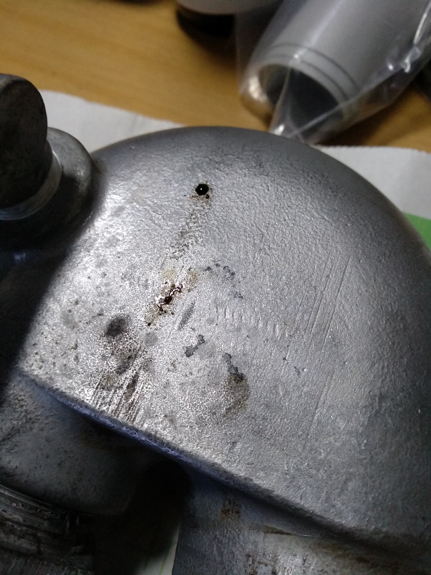

1. Did you test to see if the external signs of corrosion went through the casting to the interior ?
2. Did you ever contact HDI Marine to get their take on this problem ? I'm sure they'd be interested.
Oct 29, 2005
2,366
Qn1- the water droplets was brownish-black, and could only comes from inside.
Qn2- nope. Doubt they can do anything for me from so far away.
