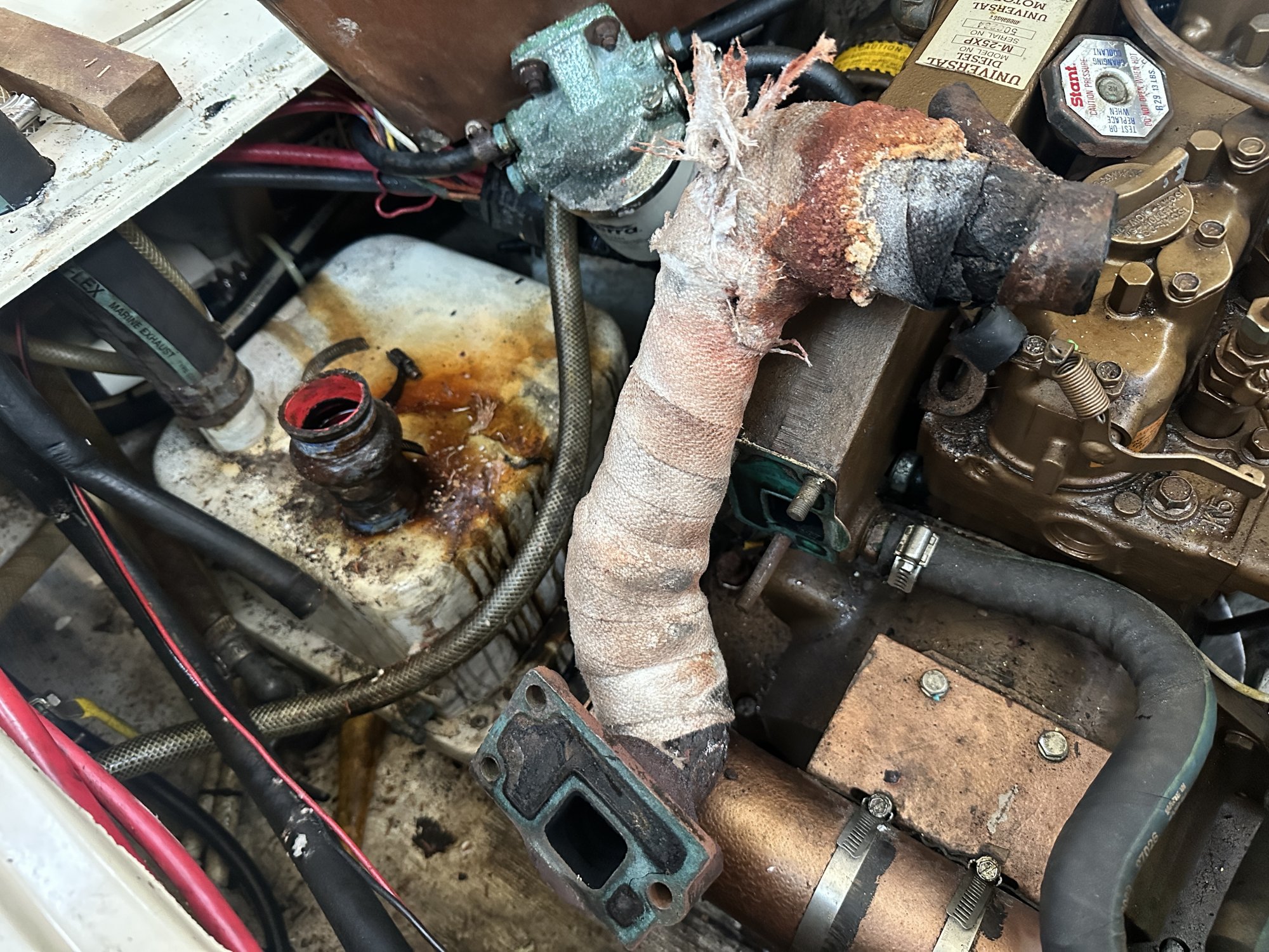

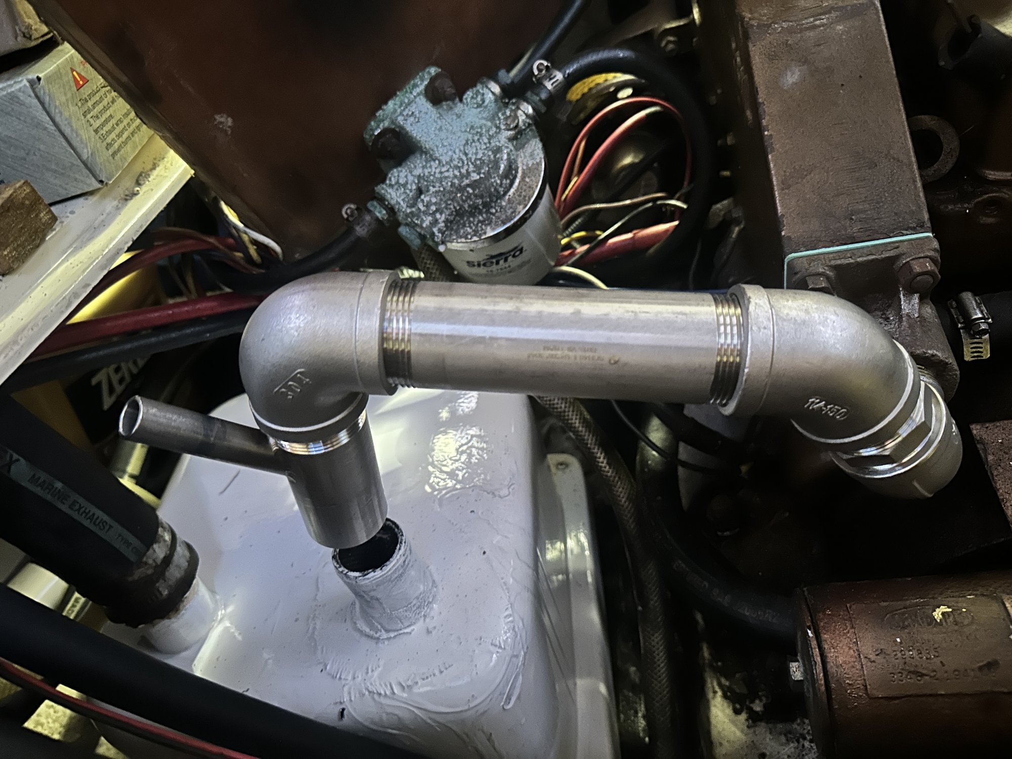

SS exhaust rebuild finished.

I'd give it many more years than the remaining life expectancy of your boat.

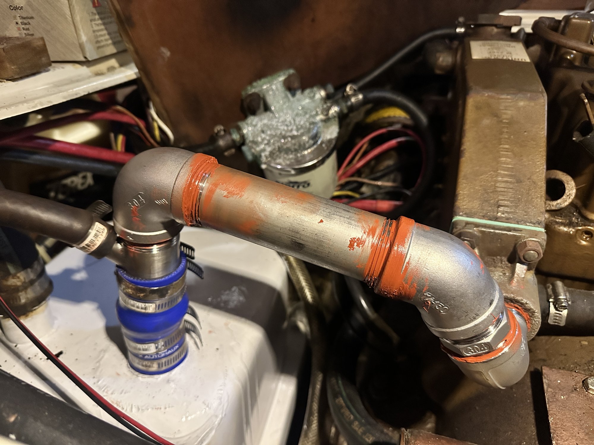

Got to ask : what is the orange material on the threaded pipe joints ?
24,836

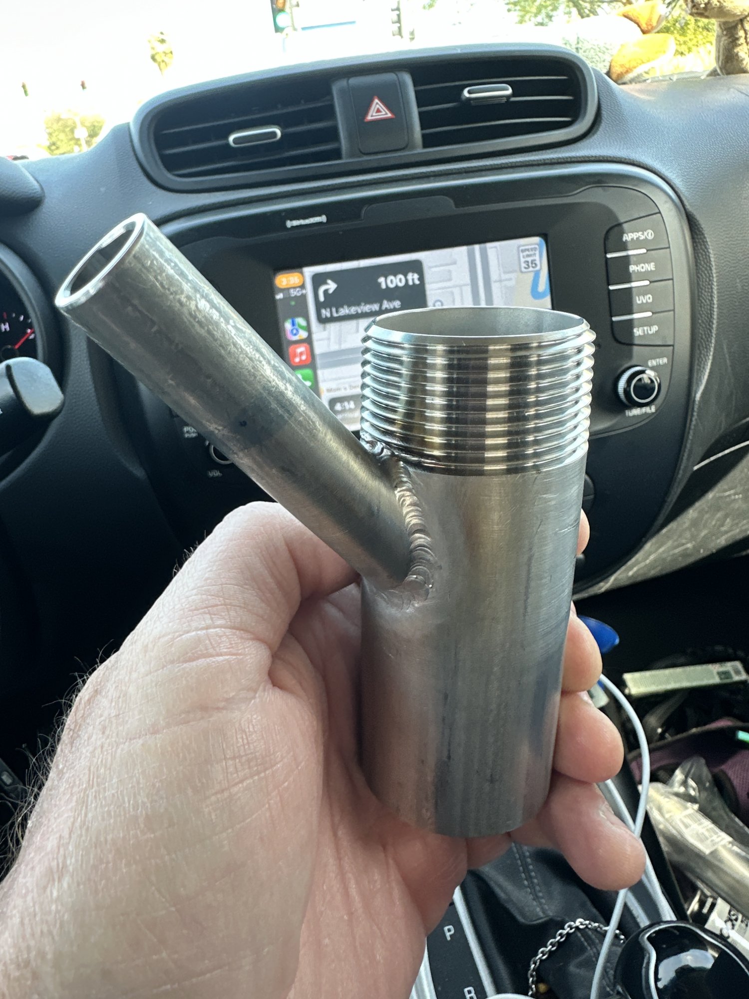

Nice Job. Should live up to your 10 year expectation.
Ralph... I suspect the red is High Temp Pipe Dope.
Jun 2, 2014
606
Catalina 30 mkII - 1987 Alamitos Bay Marina, LB, CA

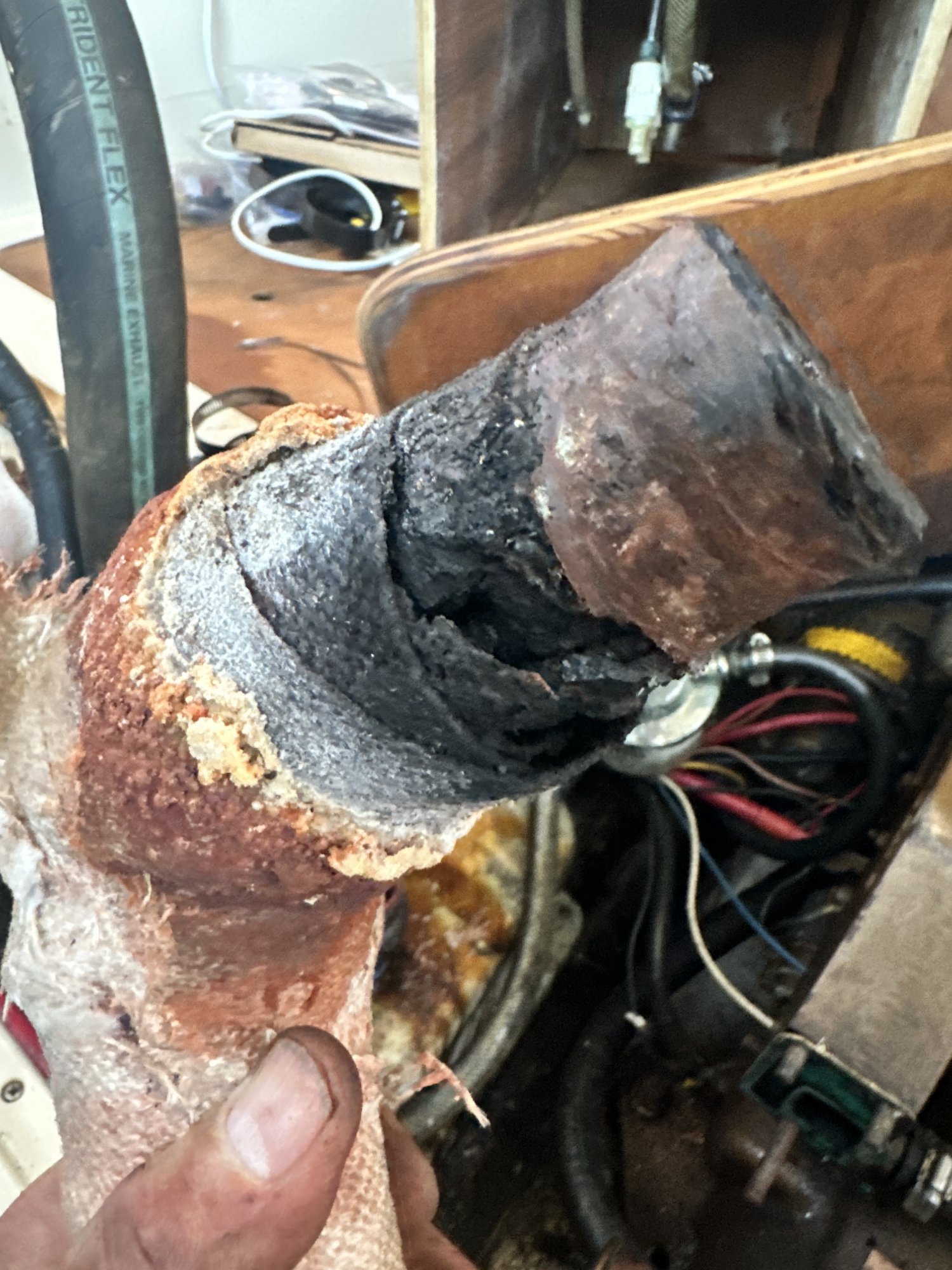

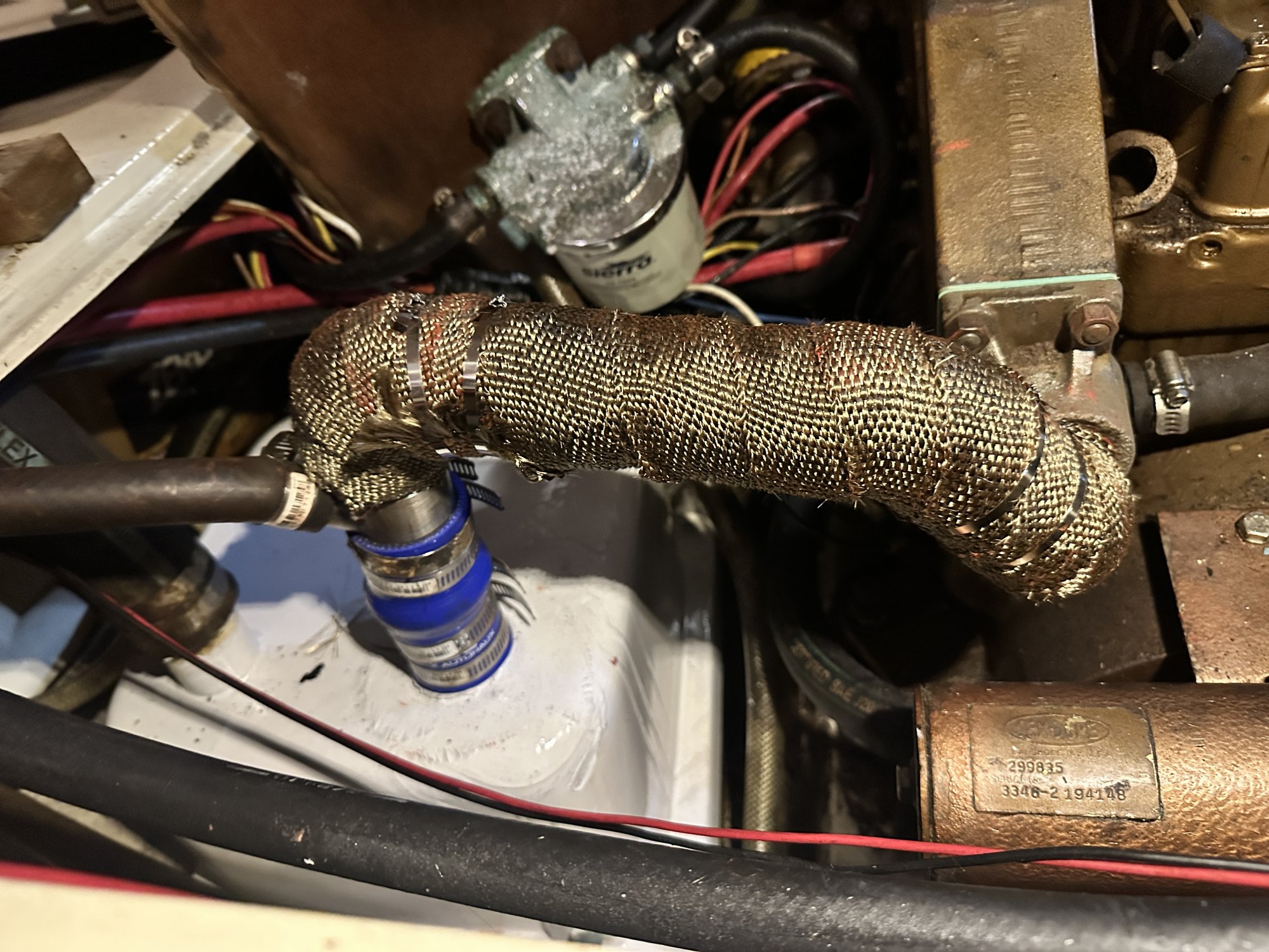

Yes, that weld looks really nice and I was happy to get that done. And the orange red stuff is Permatex high temp gasket sealant. I put some on the threads before I screwed it all together, and then I proceeded to make a mess with it afterwards, but it’s all good all covered by the heat wrap. And if we’re talking about ours for longevity of exhaust pipe, my iron pipe lasted exactly 6 years and around 500 hours maybe less
  • Ha
24,836
I used it when making my exhaust connections. My mechanic did the work of making the connections. He also got a bit of goo everywhere.:yikes:
