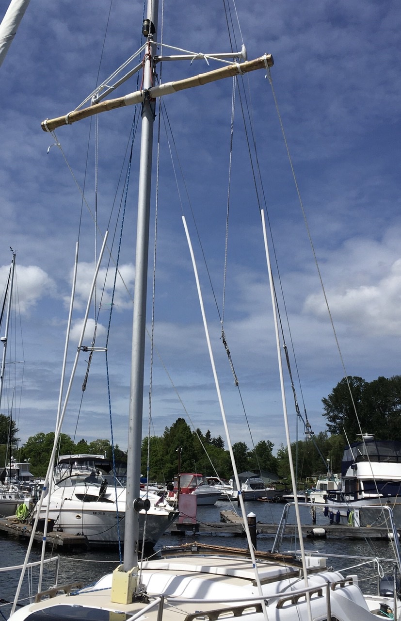

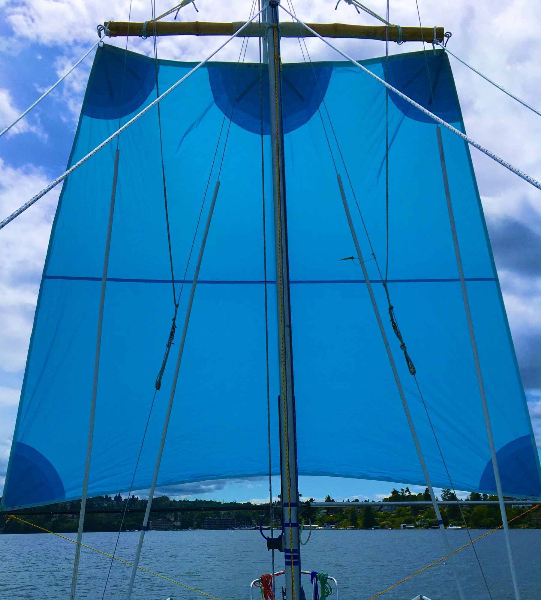

I am in the process of converting my Laguna 26 into a square-rigged vessel. My slip neighbor pointed out it could be considered a “gaff-rigged spinnaker” but I want to pretend I’m in a Patrick O’Brian novel, so I’m sticking with “square rigged”. If you think this wacky idea might be entertaining to read about, here is the blog:

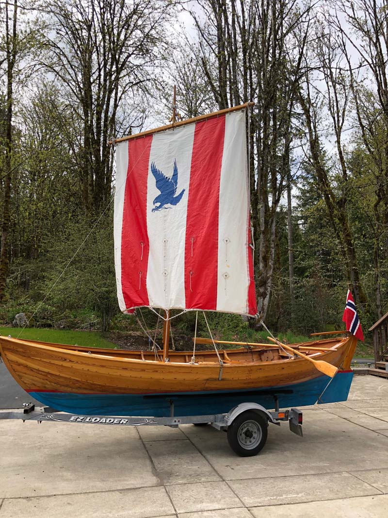

@rgranger, came across this and thought of you.
2019 Festival Boats | Port Townsend Wooden Boat Festival
Gyrfalcon
For Sale
Home Port: Port Orchard, WA
Year Built: 1995
LOA: 22'5"
Owner: Jeffery Miller
Designer: Oslo Trebatbyggeri
Design: Kobberklinket
Type: Sloop
This boat was hand crafted in Norway and shipped to a Norwegian Merchant Marine living in Seattle with his American wife. It is constructed primarily of an oak frame and pine lap boards, and has a full length keel to allow sailing in shallow water. The mast supports a traditional main sail and jib, or the boat can be rigged with a red and white square sail reminiscent of the early Viking ships. Two systems can be used to steer the boat, a traditional rear rudder, or a side paddle which can be fixed to the starboard side. This boat is strictly a wind driven vessel and was never designed to be outfitted with a motor. There is a set of oar locks and 12′ oars should you lose your breeze!

Thanks for the comment and explanation. I use the square sail for downwind sailing only, so the sheets only run aft; I haven’t found a need for bowlines and tacks. I rotate the yard-spar (and thus the head of the sail) about the yaw axis using the braces, and I can rotate the foot of the sail by pulling on the appropriate foreguy, which pulls that crossjack (aka whisker pole) forward, thus moving the associated lower corner of the sail (is it a tack? is it a clew? I have no idea!!) forward as well. When sailing upwind, I use the mainsail and genoa just like a regular fore-and-aft rigged sloop...or I just turn on the motor...gasp! A sailing heretic!
Do you have any pictures or weblinks you can pass along for the square rigged vessel you’ve been sailing? I’m most curious! Thanks again for the comment.

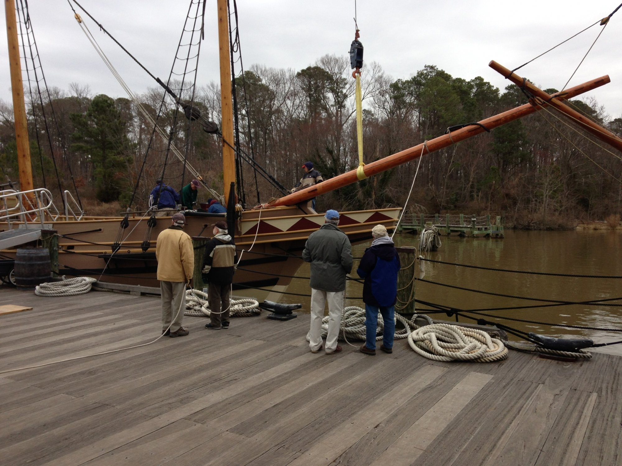

I had the privilege of volunteering at Jamestown Settlement in Virginia for a few years. During the off season I participated in maintenance work on the Susan Constant, Godspeed, and Discovery. I had the opportunity to sail on Susan Constant and Discovery in Chesapeake Bay and to help move Susan to dry dock for routine bottom maintenance.
I enjoyed the work immensely, and got a tremendous education as a member of a crew sailing square rigged 17th century craft. Its not as easy as sailing my Bene.
Sadly, had to give it up due life changes and a knee replacement.
