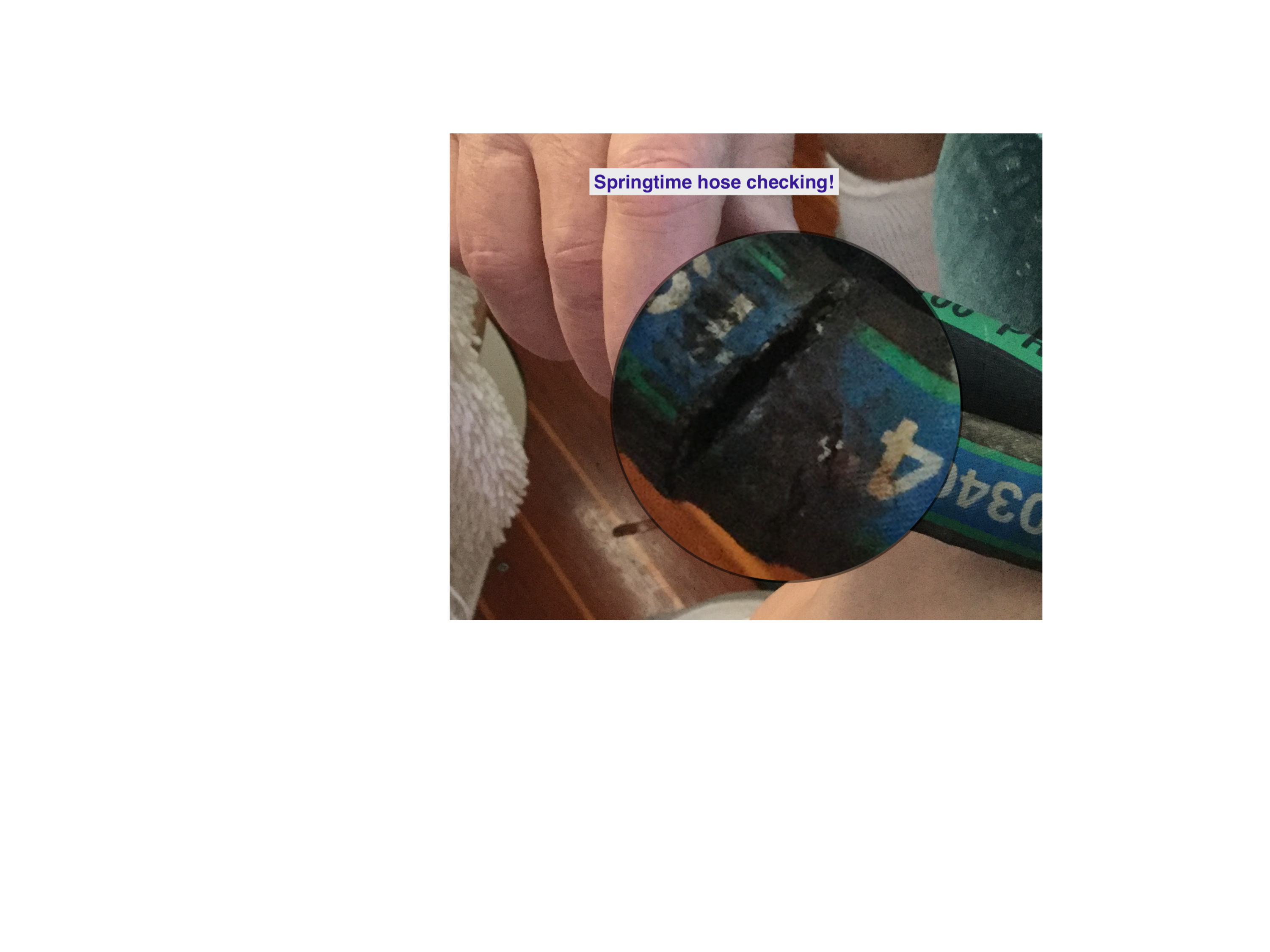

Although Spring is not early, today was a nice 80° sunny day on the Gulf. We began the preparations for a Safe Sailing 2018.
We always start with the seacocks, hoses, and clamps that could sink our boat or a least cause a major disruption in a nice sailing adventure.
_____
Look what we found, just in time.

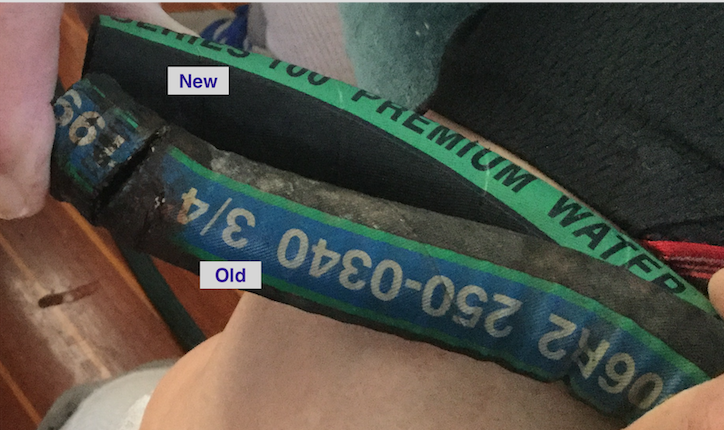

This is a super strong, wired reinforced suction hose to the AC system. It was partially
Hidden under these hose clamps.
BION [Believe It Or Not] we had a piece of spare suction hose aboard along with new SS clamps. It was replaced immediately. The cracked piece was in compression and on the suction side making it even less obvious.
Safety check all your hoses!
Jim...
PS: All other 9 seacocks and the PYI bellow were all good to go.

The AC water line is a heat pump and dehumidifier. During this winter, we needed the heat. Fortunately we check our hoses and I strongly recommend close inspections with a magnified light, at least once a year.

I assume the hose was OEM. 17+
_____
Rubbers are different and are compounded with, normally, Carbon Black, and don't dry out. This appears to be Neoprene that is normally in the dark. The key, IMO, is the stress point, not age, movement or other boating fatigue. The NEW hose may be 10 years old also, but stored in the dark. This damaged OLD hose, was a key location to remove for purging/blowing the AC cooling water line.
Multiples pulls and re-clamping by the PO of my boat, was more a factor, than age of the hose. It is a semi flexible, interior lined, steel wired reinforced, vacuum rated hose.
Originally appeared to be installed making an curve and in a bind. The old [new replacement] is not in a bind.
The OLD hose was NOT hard or brittle. Rubbers may harden when exposed to high heat and/or UV, but not this hose.
Per your request.
Jim...
PS: Bowling balls are Harden Rubber. I manufactured Neoprene. Auto Neoprene radiator hoses don't require changing every 10 yrs, but inspections are recommended.

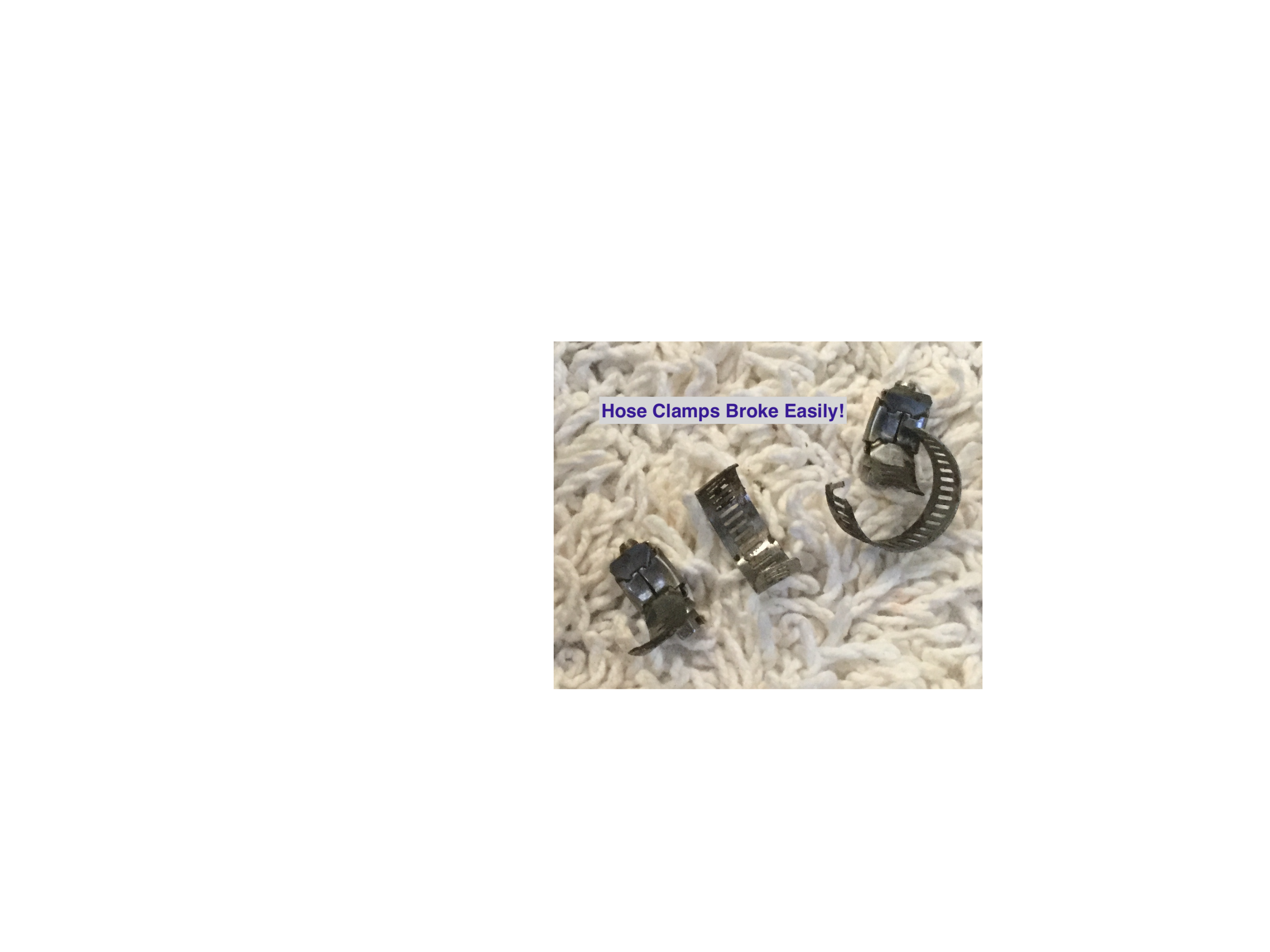

It's pretty amazing how often these perforated track clamps have failures. I found one that had one side of the track broken in two on the back side of a raw water hose where it was hidden. Clamp looked new except for the tiny 1/8" diameter rust spot (where a drip formed I bet) at the break. Mainsail turned me (us) on to the nonperforated AWAB hose clamp that I now use when replacing any old clamp. I typically use the blue stripe trident hose. The ends on the green striped hose that I took off the siphon break between the mixing elbow and heat exchanger were harder than the middle of the hose. Maybe they have been "heat treated" in the engine compartment! The hose is OEM from '08.

BTW, the Old hose was way over specified for its use.
It was used "probably" since it was short, maybe scrap, or bulk bought by OEM.
The New hose is for water and not high temperature, but vacuum service. It should last longer than the AC unit.
Sometimes the "better" hose is not the BEST selection.
Pick your replacement for the service needed!

The hose was holding by friction, with or without the clamp. Prior deformation and repeated PULLS off the seacock caused the fatigue, crack and drip.
