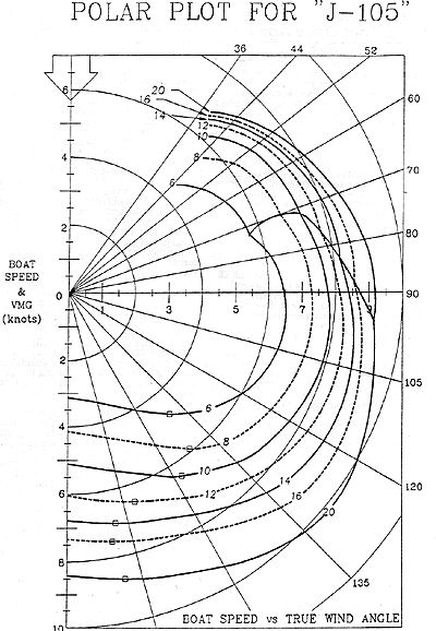

Just to be clear: I was saying my boat speed with an asymm while running deep angles increased from 4.3 to 6 kts. VMG DDW was slower, under 5 kts. There was a sister ship sailing downwind, wing and wind with a poled out genoa behind us, and we were much faster with our asymm than the sistership.
For example, a J105 will do 6 kts through the water in 8 kts of TWS with the class asymm, at a TWA of about 140-150. That computes to about 5 kts VMG DDW. That's pretty good performance, and there's no drama. My brother and I used to double hand a J105 all the time. In winds up to 15 kts TWS, we'd fly the asymm.

Judy, I really think this is great and the J105 is a fast boat. My point was more along the lines of, if sailing in the trade winds, ddw, the diffence is under a knot, even if it is 20% of the speed. On the average, it will add a couple of days to a passage. But, yes, Spinnaker sailing is exciting.
