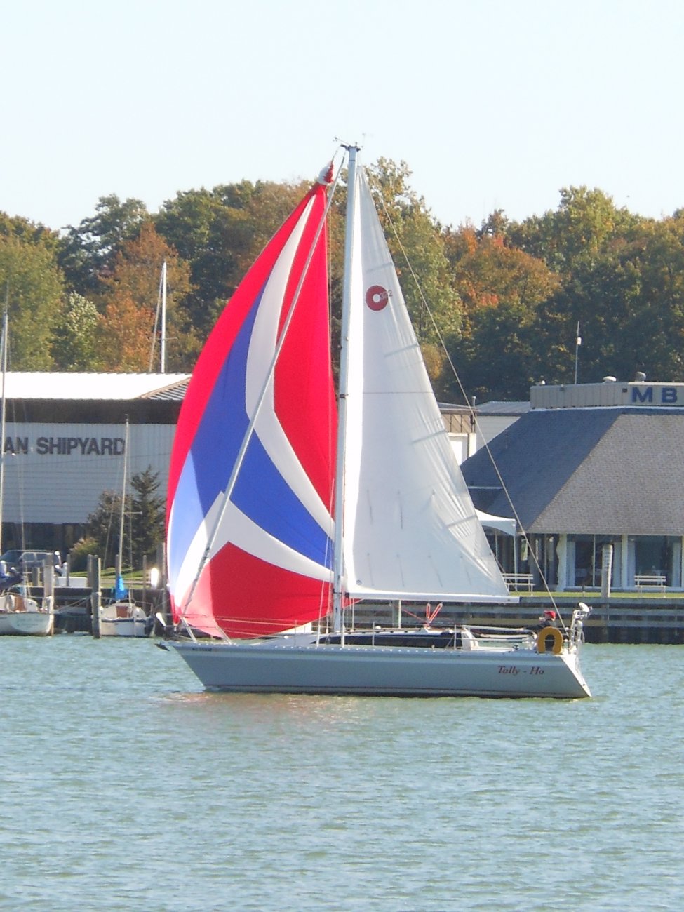

Oct 29, 2016
1,915
Hunter 41 DS Port Huron
@Meriachee my pole is not retractable but is removable the Top Down control line is extended to the cockpit makes the kite easy to fly, I only run (1) sheet to reduce weight on the clew so if tacking I have to pull the line from one side to the other, and that's the only time I have to step out on the deck.

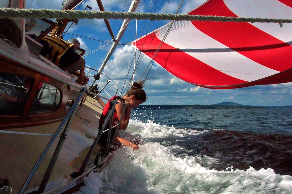

It takes more work to fly a symmetrical spinnaker(we had a cruising chute on one boat-easy in comparison).
We've had symmetrical spinnakers on our last 3 boats. Flying the spinnaker is the pinnacle of sailing joy! It's also at times can quickly overpower the boat.
The old boat we have now had 4 spinnakers with it as it was raced. We never raced this boat but have covered some miles the two I keep onboard (a heavy air and light air, the one in the photo).
We'd only raise this big 1/2 oz light air chute if the wind was guaranteed, to stay below 12 knots and only if we had at least 10 miles to cover, and nothing in the way.
There is so much power in a symmetrical spinnaker.
I haven't flown it in a few years now. I'm looking at at least a sock for it if not one of the new top down furlers and an asymmetrical. We'd use an asymmetrical much more often but I doubt we'll get as much performance as a symmetrical and pole.
