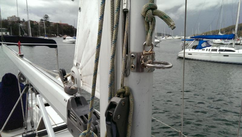

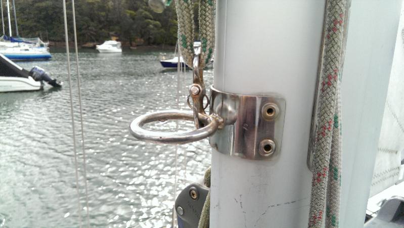

Our rigger had this made, we added a kicker and used spare halyard as topper for the pole
Works well

Hi Pompardi, that looks neat. Was there any concern about interfering with the inmast mainsail furling with the rivets to attach the ring to the mast?

We checked the selden mast diagram before drilling into the mast , the area at the front is hollow except for the cable conduit .
We use the pole to goose wing the headsail , most of our racing is non spinnaker so we don't have one.

Poling out an asym is a great idea for reaching. We do it all the time, even when racing.
On a 30+ foot boat you for sure want a ring on a track. While reaching the loads are very high, and could rip a single riveted ring off the mast.
Remember, the loads on TACK of a spinnaker are much higher than on CLEW of a poled out genoa.
