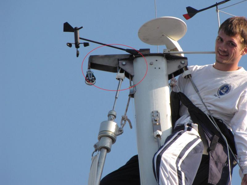

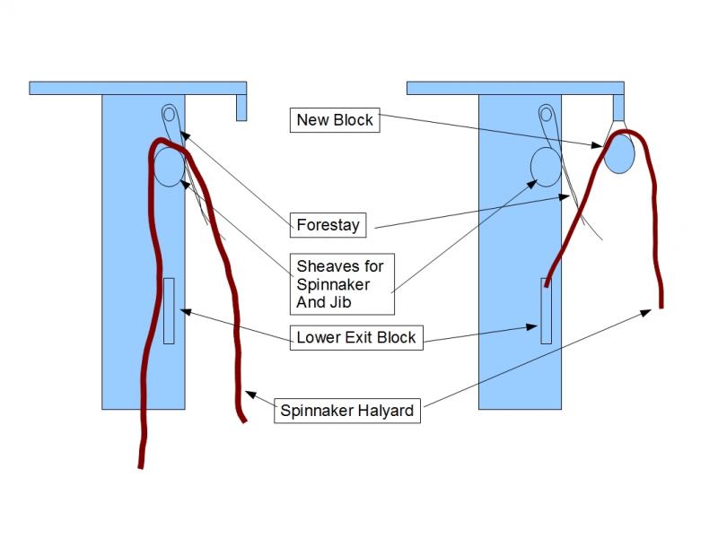

Hello all, I was rigging the boat for the newly acquired asymmetrical and was wondering what the consensus was on halyard routing. Our mast has the spinnaker halyard run up to the masthead and over the sheave next to the Jib Halyard. There is an optional halyard lead down about 3 feet. If I run it from below I was going to run it up to a block and if I left it where it was it only will lead fair if I forgo the block on the masthead bracket. My mast is the one on the left. Not the far left. You can see the masthead clearly in my avatar.
