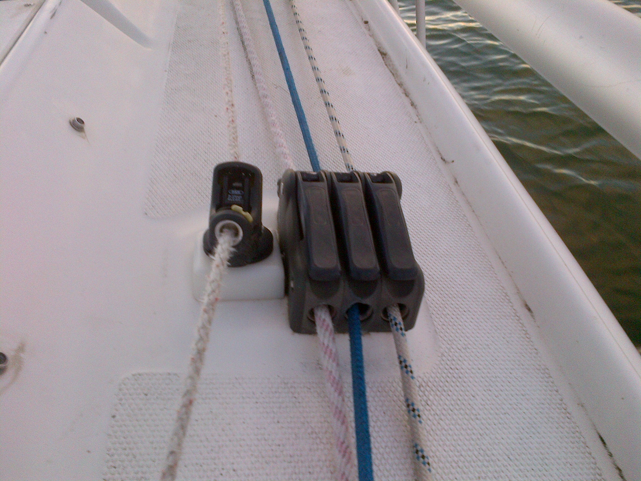

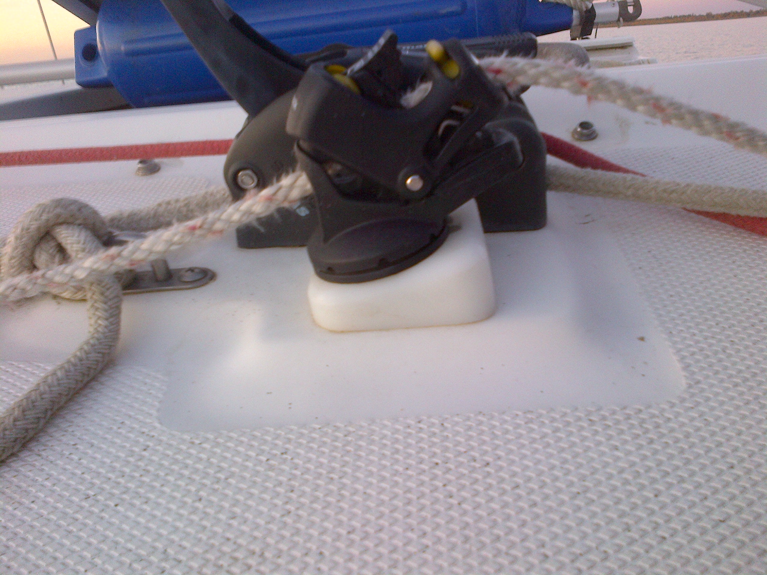

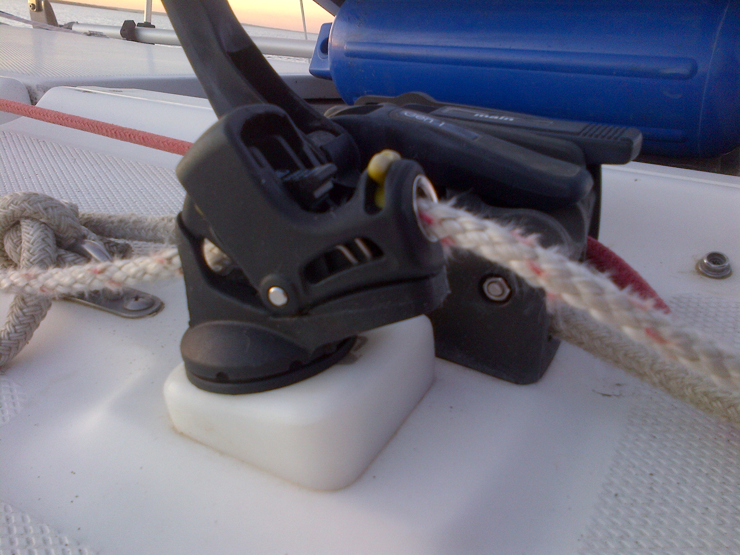

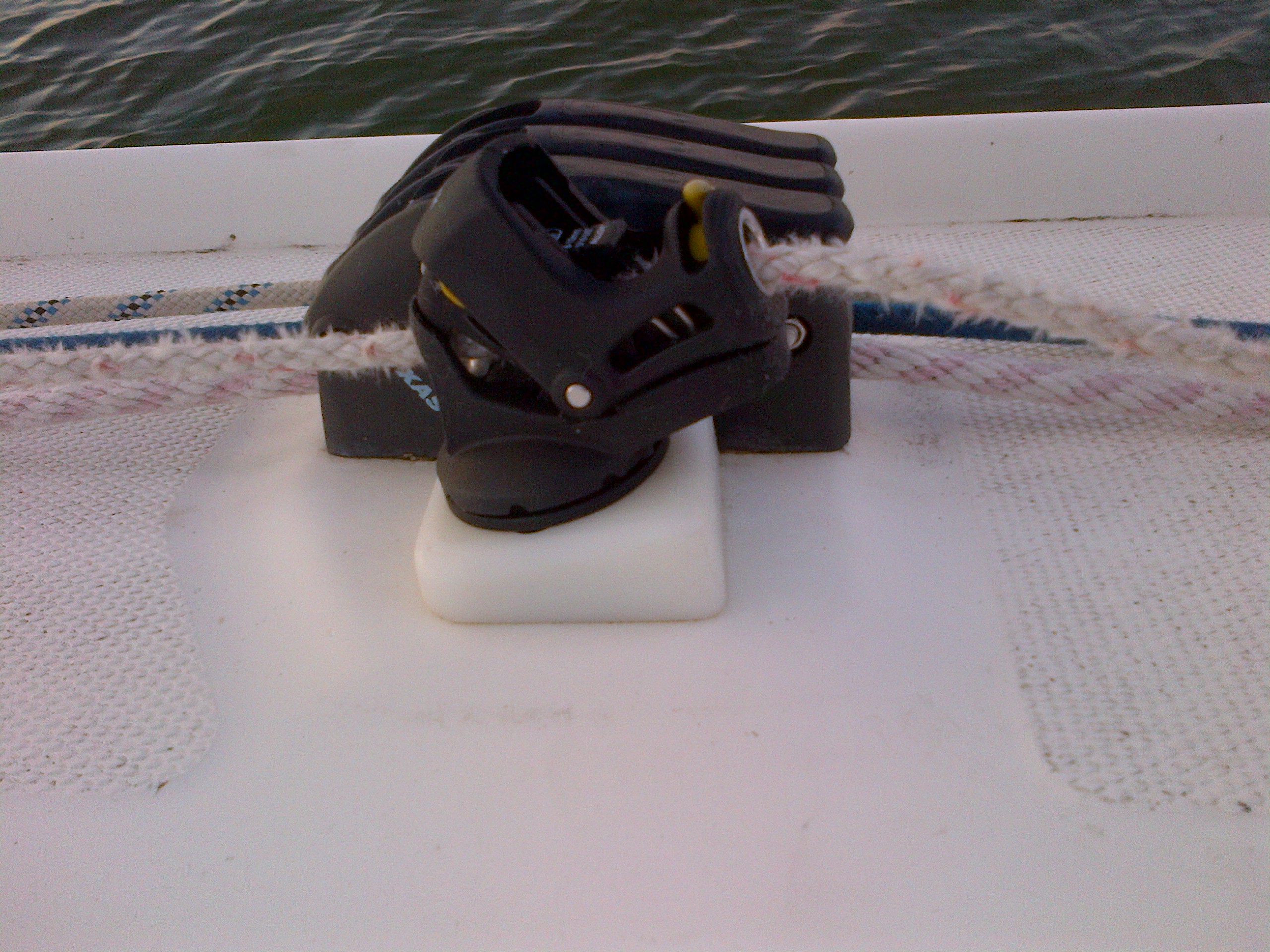

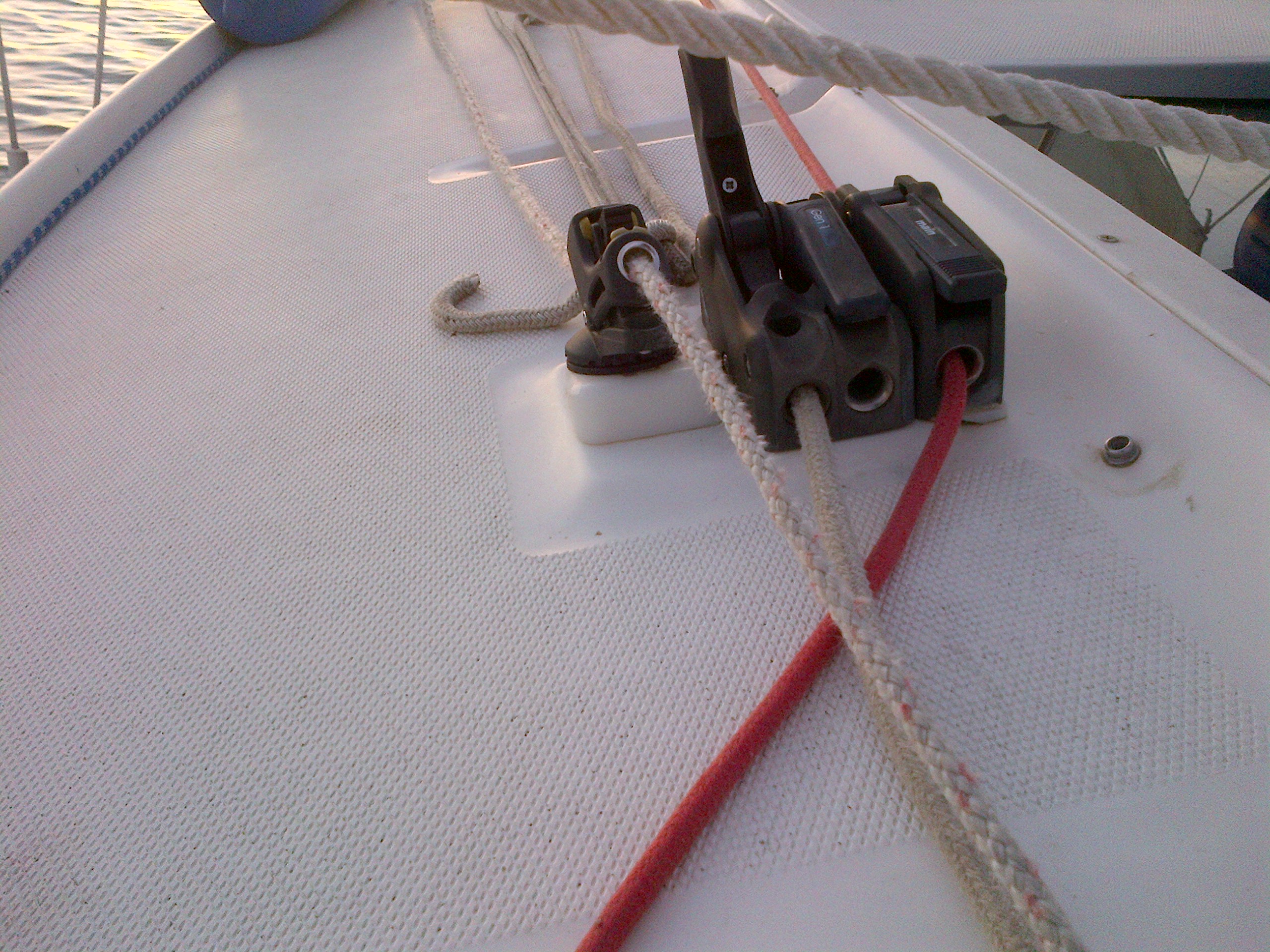

I installed some spinlock power cleats this summer and wanted to update you on how they worked out. The location is really key for these and even though I wanted them closer to the companionway edge, I felt that without any reinforcement in the cabin top, that I should keep them where I know they have good backing or support. I removed the existing cam cleat and the spinlocks fit right into the existing holes. I had options with the spinlocks and decided to go with the swivel style and I'm glad I did. The biggest challege with this placement that I choose is getting them on the proper angle for ease of use. I saw pics from others that used spacer blocks to raise them up as well as wedges to get the right angle. So I decided to experiment with the angle of my home made wedges. I used some leftover UHMW to machine the wedges. I fitted the cleats to them and installed them on the cabin top.
They take a little getting use to but I really like how they work. I was supposed to replace my jib sheets this year but WM messed my order up so I don't have the new sheets running through them. One of the negatives I read was that these cleats would jam up and should not be used with sheets that the cleats are sized for. So I can't speak to that issue until I get my new sheets next year. For me, I love single handling and these really work well. I do have to adjust the angles of my wedges as currently they are pointing too high and at times I really have to reach up high to get them to release. Those adjustments will have to wait for next near's sailing season as the Blue Honu is in hibernation mode.
I'll post some more specifics and details when I get home. If anyone has any input or experiences to share please do.
The pics show the port and sbd cleats from two sides and the last two pics show the port cleat in the open and closed positions.

Diana made a good point for caulking. Shanker, let us know if you did that. When the swivel cam cleats came out, the first one installed was not elevated forward toward the bow; thus, it made it very difficult when pulling down that cam cleat to lock in or hold the line. The reason it is too far back from the edge. I did what you did and made pieces out of white delrin or starboard which like you took care of that problem. Later Spinlock per discussion with them started to make a wedge kit. I am not sure if a wedge kit is made for this paticurlar cam cleat but wanted to have anyone thinking of that to look into a wedge kit if available.
Also for those who do not know, there is a large aluminum plate underneath the flat surface encapsulated in the fiberglass that one can drill and tap for bolts. I suggest bolts vs. screws for better holding. Be sure to caulk and there DO NOT USE 5200. As for winches it works but then there is a placement issue and securing them. From practice, I found winches were not necessary for the jib sheets as I use to pull them over thru the cam cleats when changing direction and if I needed to shorten and there was pressure on the lines, I would turn momentarily quickly turn into the wind releasing that pressure on either the 26 or 260

I use the spinlocks in lieu of the winches. No need for them. Just flip your wrist to release the cleat and flip to lock it. They really work well for the 260 with its small jib. Not sure if this is the right equipment for other boats.
Diana/Dave
Good points about 5200. I have yet to use that product on my boat. As far as how I have it attached/sealed to the deck; The spinlock is bolted directly into the top of the riser block. I drilled and tapped the riser and it is not a through hole, so no water migration issue from there. The riser is bolted down using the existing bolt holes in the deck from the original cam cleats. Because they are threaded into the factory aluminum plate (embedded into the fiberglass), it is possible to get some good purchase on those two bolts resulting in sufficient holding power. I actually re-used the same two bolts from the cam cleat. As far as sealing it to the deck to avoid water migration, on the bottom of the riser I machined a groove with a 3/16" bull nose end mill around the outside of the block about 1/4" from the edge and about 3/32" deep. I over filled this groove with marine silicone and then secured the riser to the deck with the bolts. The groove holds the silicone and creates a seal point. This is a prototype and once I get the angle and the location where I want it, I was going to use an o-ring in that groove. Lots of success with that setup in various oil and gas assemblies. I had this setup installed all sailing season and had no water issues.
Hope that makes sense. Let me know if you forsee any issues with this set up, I appreciate your experience and knowledge.
