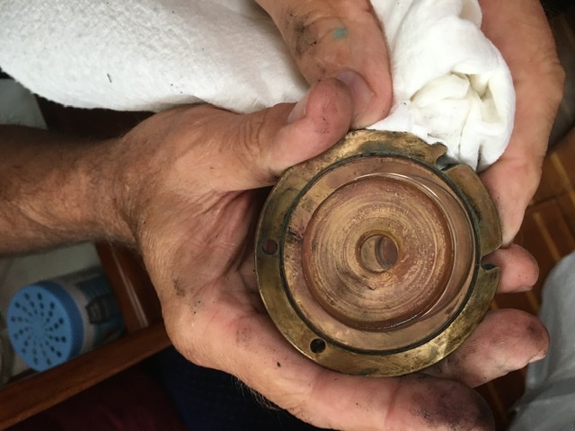

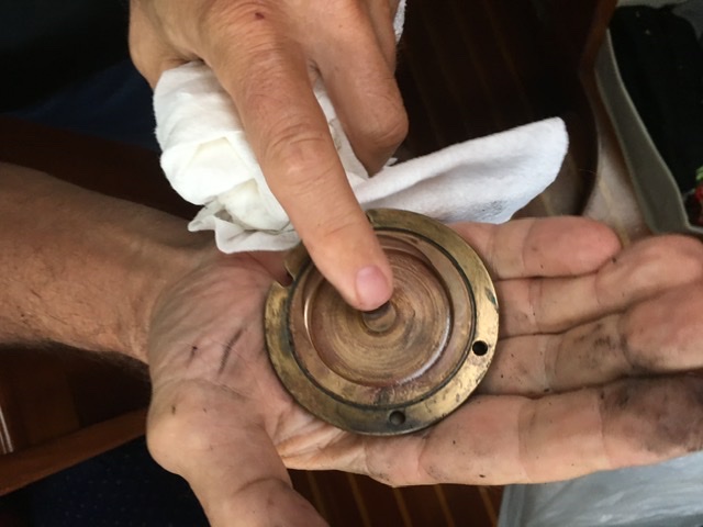

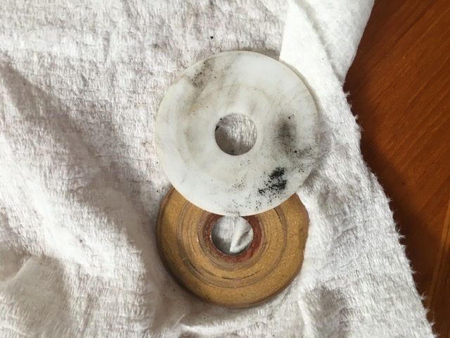

Here’s the speedseal cover and my measurements. Center hole on the bronze bearing increased .02 of an inch and total diameter reduced .06 of an inch. The cover speaks for itself.
34B96739-FCA5-482E-A715-DE6E3F23B1D3.jpeg.5BE7DE03-B2A9-4CDA-A392-28B3267AA3EE.jpegD43961A2-FF50-4358-A2E0-56DC19D9064B.jpeg
I flipped the cover using it like any cover but using the thumb screws. Thumb screws, good name.
View attachment 173286.View attachment 173288View attachment 173289
Your measurements agree closely with mine. It clearly is a design fault with the SpeedSeal Life product.

The bronze bearing reduced.01 in thickness but the delrin remained about the same. Should have just used the delrin and not have any wear.

Zoom in and you’ll see where the bronze bearing scored off center nearing the o-ring. The pump would then leak once it ate through that area. The engine would soonly overheat. Both the cover and pump have been scored. Just the type of Christmas present everyone wishes for.
