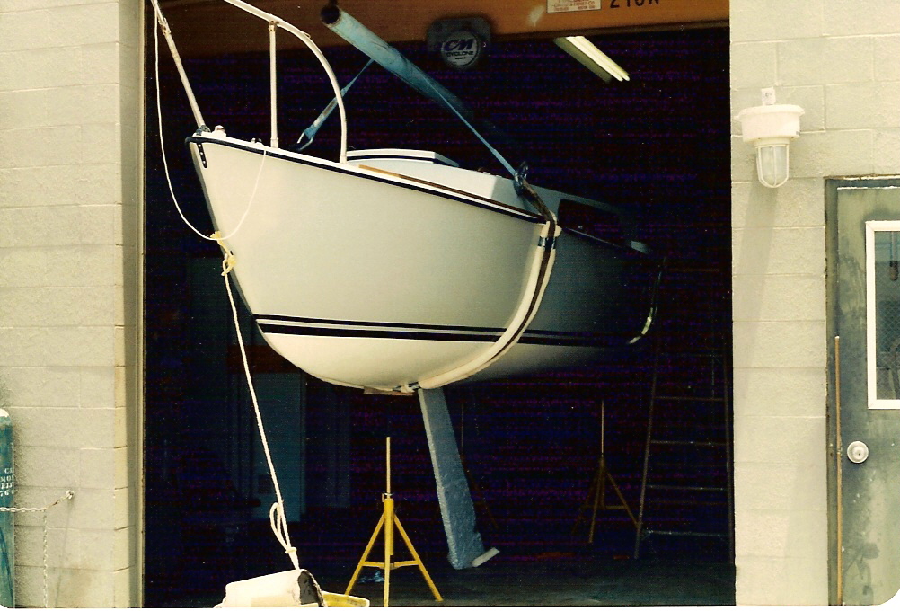

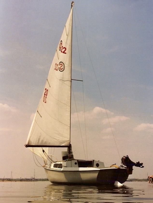

I refitted a South Coast 22 back in the 80's, it was a Hurricane Alicia wreck I got for $500. I stuffed flotation foam under the v-berth and under the cockpit. I didn't have a lot of faith in the repairs I made to the cracks in the bottom. I would do something about the leading and trailing edges of the iron centerboard. I saw an article on some website about adding wood fairings and glassing over them.

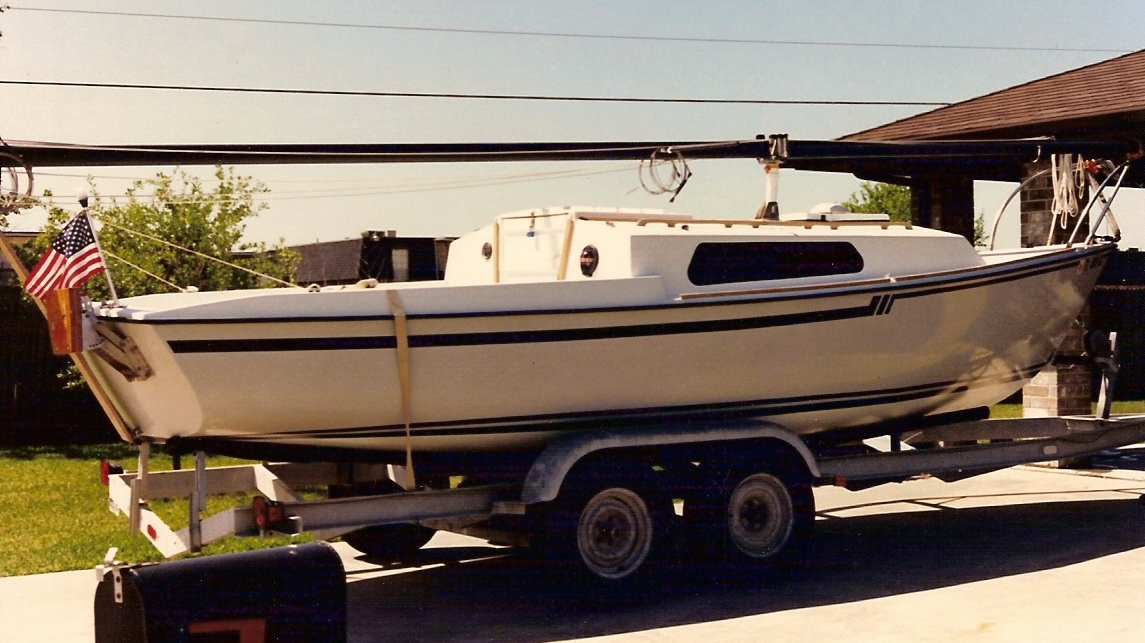

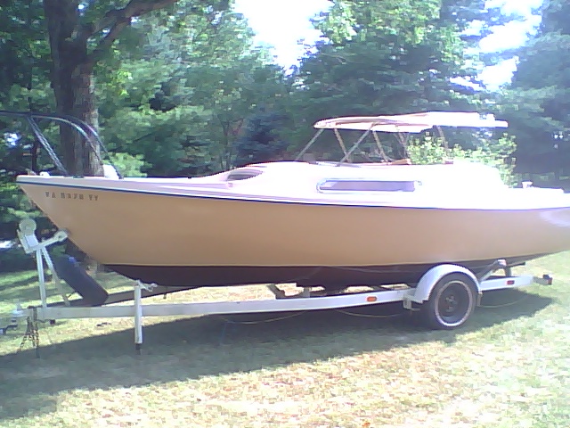

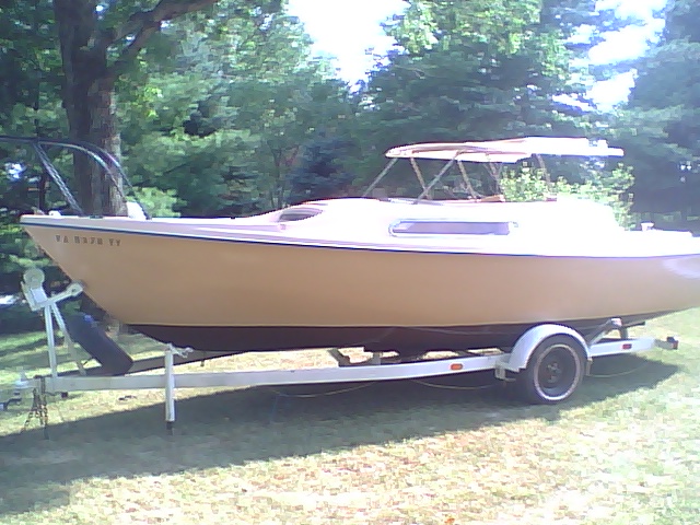

Thanks Dave, look at the photo of the boat on a trailer in a driveway a few posts back in this thread. Zoom in on the motor bracket, you can see angle adjustment holes on the bracket. It was an adjustable bracket you used to be able to buy in the 80's. I haven't seen it available in a long time.

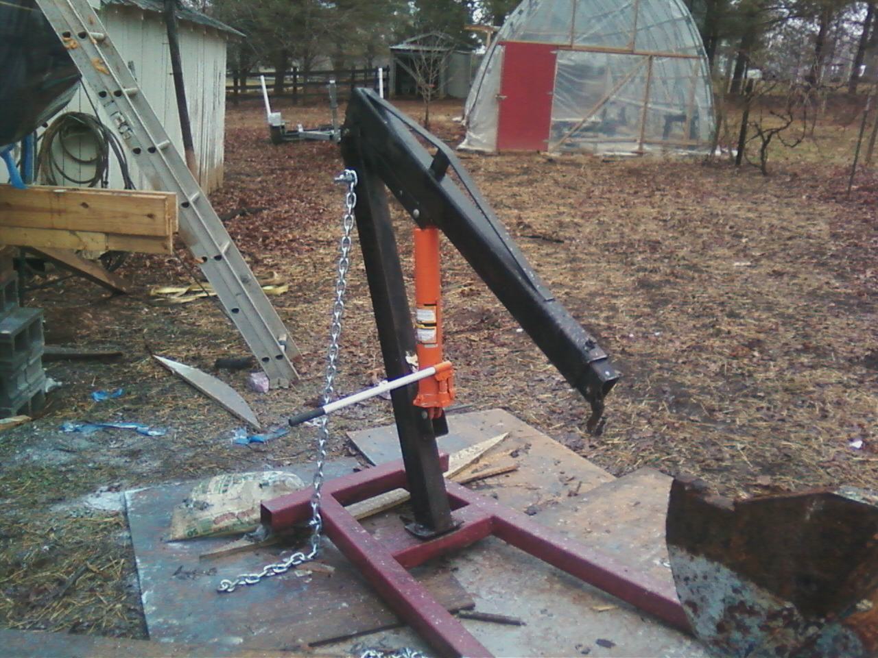

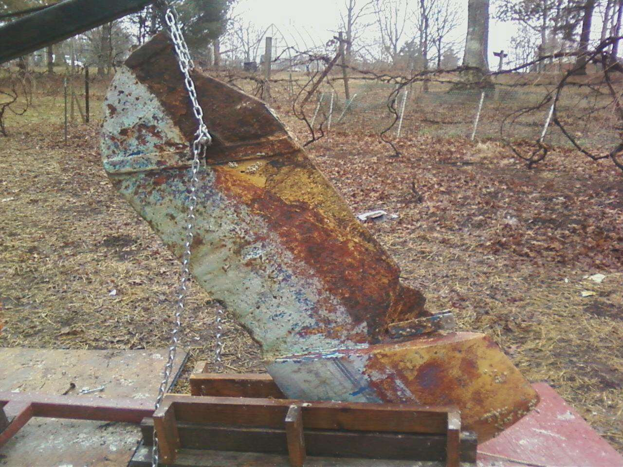

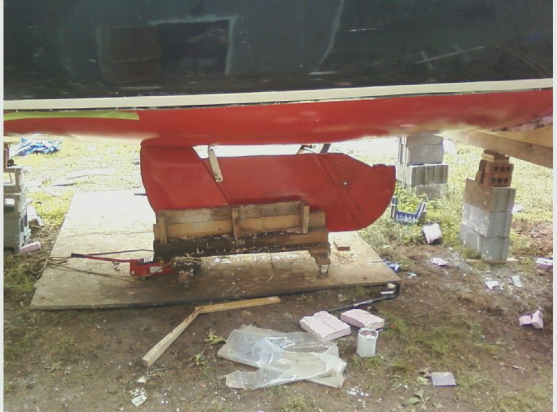

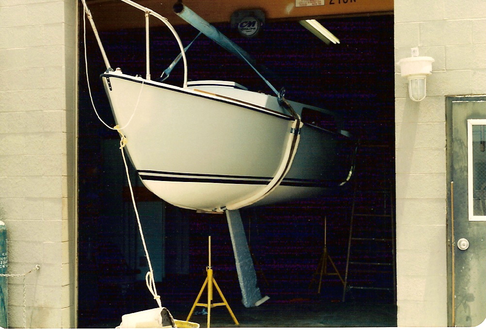

The last time I worked on a keel, I found this engine hoist on craigs list... these suckers are heavy so get some advice on how to move them about before you dive in. The keel in these pics is 1200lb... yours is probably in the 600lb range... still very heavy.
