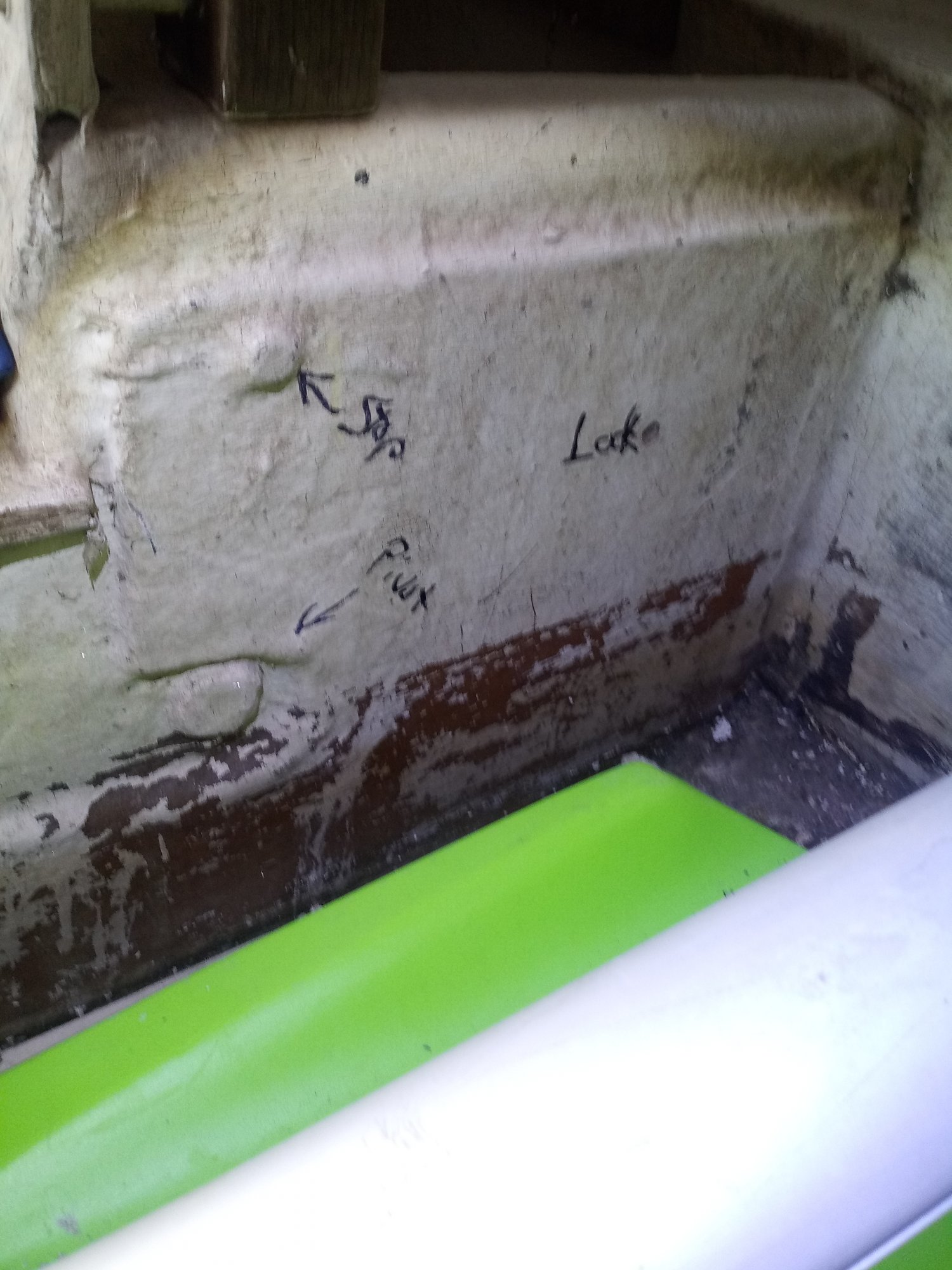

I looked in my trunk from the underside and cannot tell if the keel pivot bolt is SS or not. My lock bolt goes through the keel. The hole lines up when you winch it up a couple clicks past full down, basically just enough to take the slack out of the cable, bolt goes through, then I slack the cable so it doesn't make the whole boat hum.
The sides of the trunk are plywood cored. knock on them with a hammer. they should sound solid, not a dull hollow thud.
by observing the water line, my lock whole sits about 6" above the water and the pivot would be right above the waterline.

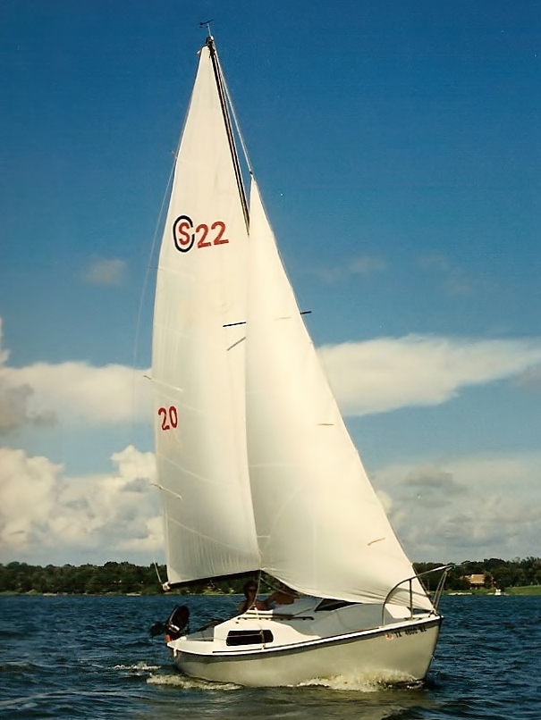

Southcoast 22 was my first boat. Bought a hurricane wreck and tried to repair and restore it. Learned a lot, especially how not to do things.

great picture! I would love to have the proper sails. My main is a bit short in the luff. The jib is correct I think, just small.
Mine is set up with winches and genoa tracks, but I don't have the genoa. Yours has grab rails toe rails, mine doesn't.
I just bought new turnbuckles for my rig. It goes under the knife when this snow melts. Time for some new plywood bulkheads and a couple stringers to stiffen her up and for piece of mind. Hopefully stiffened back up and being able to tune the rig properly, she will sail a little better. she's got some heavy helm and wants to run in the wind rather than turn into it. I think the mast needs raked back a bit.

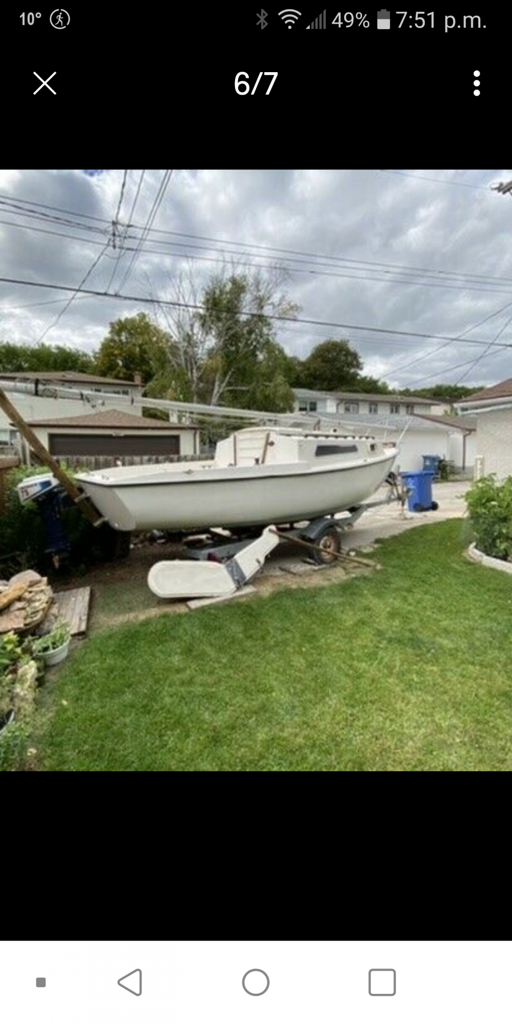

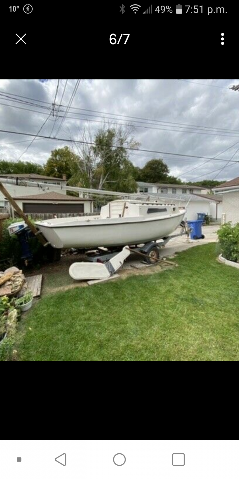

excellent you guys. now i cant wait for summer so i can work on the boat. i bought it in october so i havent had a chance to put it in the water even. this my boat. i do think the pin is ss. there are 2 collars on it that look like they may be mild steel. i have to put it on blocks or in the water and drop the keel to really know what the issue is.

excellent you guys. now i cant wait for summer so i can work on the boat. i bought it in october so i havent had a chance to put it in the water even. this my boat. i do think the pin is ss. there are 2 collars on it that look like they may be mild steel. i have to put it on blocks or in the water and drop the keel to really know what the issue is. View attachment 190545
sharp boat. if you have any questions about rigging it, feel free to ask.
10,536
-na -NA Anywhere USA
Be very careful if droppping the swing keel beneath the boat. Suggest you have a jig or something to keep it up as if it should slip, anything can happen like a friend of mine fractured his leg while trying to remove a swing keel from a MACGREGOR 25 by himself. Have a second person as well assisting you for safety.. My second boat was a SC 22 as well. It made more aware when I became a sailboat dealer.

thanks for the heads up. ive never done it. but have you tubed a catalina keel drop. i believe the sc22 has a 500lb keel. HEAVY. lol Safety 1st for sure.
