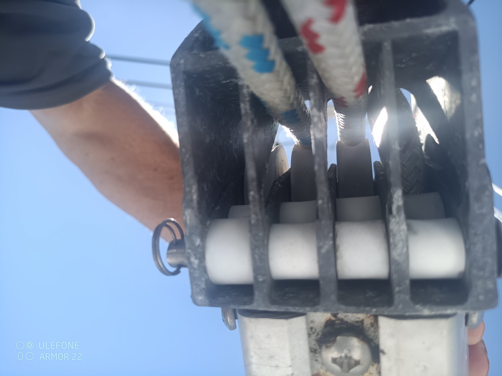

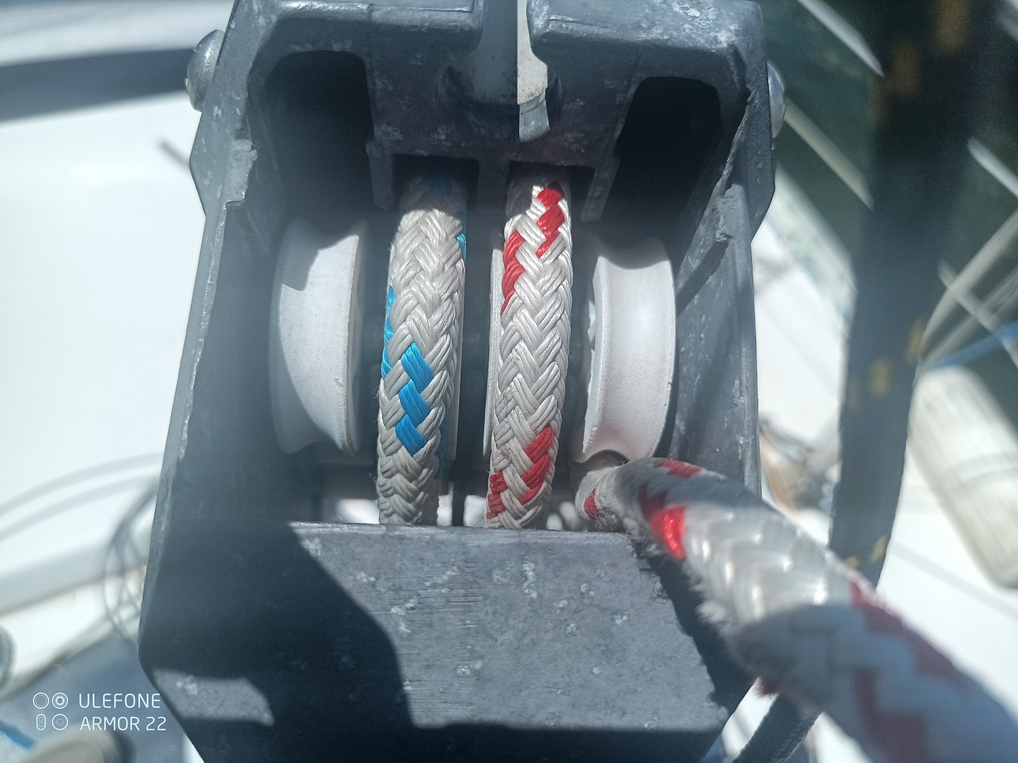

I'm looking for any input or suggestions. The forward end of the boom looks like the pics attached (Blue coded line is outhaul, red is reefing system):
Top:
Bottom:

So I've been searching for answers for the last how ever long and it would appear that the line to the deck organizer (back to the cockpit), is supposed to go over or between those little white rollers at the bottom of the forward part of the boom. and the line that goes to the forward reef point is supposed to be under the sheave and up the mast? It would make sense, but the smaller things on the bottom have me puzzled. Why so small, and does it go between them or over the top of the topmost one.

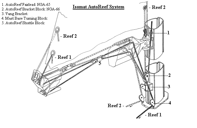

The forward reefing line, the one that runs up to the forward cringle, doesn't go over one of the forward sheaves, it goes under the same sheave that the line runs over going into the boom to the shuttle block, then down to a turning block on the mast. The picture below shows how the lines are routed.
Mar 15, 2023
26
Hunter Legend 37 Hampton
Brian, thanks. That is the most clear diagram I've seen yet! One problem tho ... I don't have item #2 on my mast. Of course, if I'm supposed to have that, it would explain a lot!

Regarding that 'Item #2'. My Legend 37 (1989) Isomat rig does not have it either. So, I added it. My rig has a very robust stainless rod contraption instead of the #3 and #2 fixtures shown on the Rig Rite autoreef diagram. I am about to use a low-friction aluminum donut sheeve (as #2)with dyneema (sp?) pigtail so I can attach it to the rod contraption (#3) on the mast.
I have the axle for the small white parts but no small white parts. They are available on the rig-rite.com site. But, I don't think they are needed.

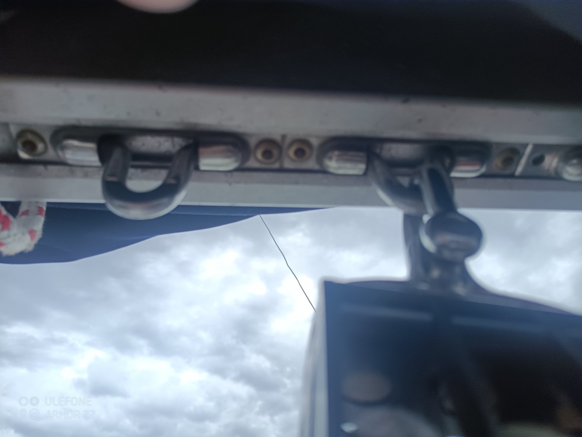

So, after nearly a year, I am finally getting back to this task. I am hoping to NOT have to take the book off or parts of it apart, but if I must, I must. I want to add that second reef line, and I can't tell if there is a second car inside the boom for the second reef line. If not, I am assuming from other comments in this and other posts that Rig Rite should have them?
Secondly, I have the bails on the underside of the boom for the tie-offof that end of the reef lines, but they don't make a lot of sense. There are 3 bails, 1 for the mainsheet block, and 2 for the reef points. The 2 for the reef points (I'm assuming that's what they are for) are riveted into the boom, right next to each other - and by that I mean they are touching each other. Currently I have the mainsheet attached to the middle one, and the loose bail is between that and the end of the boom (I'm assuming that is where the main sheet block*should* go).
This pretty much means that the two reef lines would be separated by about 2-3 inches? Looking at the sail, they are much farther apart, parallel to the boom, than that. Can I conclude that at the very least the forward one should be moved forward to just below where the reef point is on the sail?
Picture of what I'm trying to describe:

On my Hunter 39 it did not have the reefing cars installed and thus did not work well. I had two cars installed one for each reefing line. The system work very well now. My rigger said don't use the bails on the underside. Just tie a loop around the boom for each reefing line. You want them to slide on the boom.

...My rigger said don't use the bails on the underside. Just tie a loop around the boom for each reefing line. You want them to slide on the boom.
Why?
It seems to me that those bails are better located for a muli-part mainsheet than for reefing lines. But the picture doesn't show where they are on the boom. The fact that you have the mainsheet attached to one suggests they are not in a place suitable for tying the reef lines to.

Hopefully the second shuttle block is inside your boom. I don't believe the Isomat Auto Reef shuttle blocks are available, but Seasure makes one that will work. You can also use two small blocks fastened together to form a makeshift shuttle block.

In your second picture the appears to be a boom bail that is not riveted to the underside of the boom. There should be two unless a previous owner removed the second one. Slide the free sliding boom bail aft of aft of where the reefing line comes down from the sail when fully raised and attach the end of the reefing line to it. When the reefing lines are adjusted properly the new clew will be pulled down and aft when you reef the main.
When shaking out the reef, and anytime you're raising the main ensure you've opened the line clutches for the two reefing lines.
Actually there are 3 boom bails there... the two that are shown in full and are riveted, and the one that is most aft and free. Still unsure as to why those two are riveted, but, it is at the moment of secondary concern, as getting the second reef line into the boom is primary. And thanks for the link!
