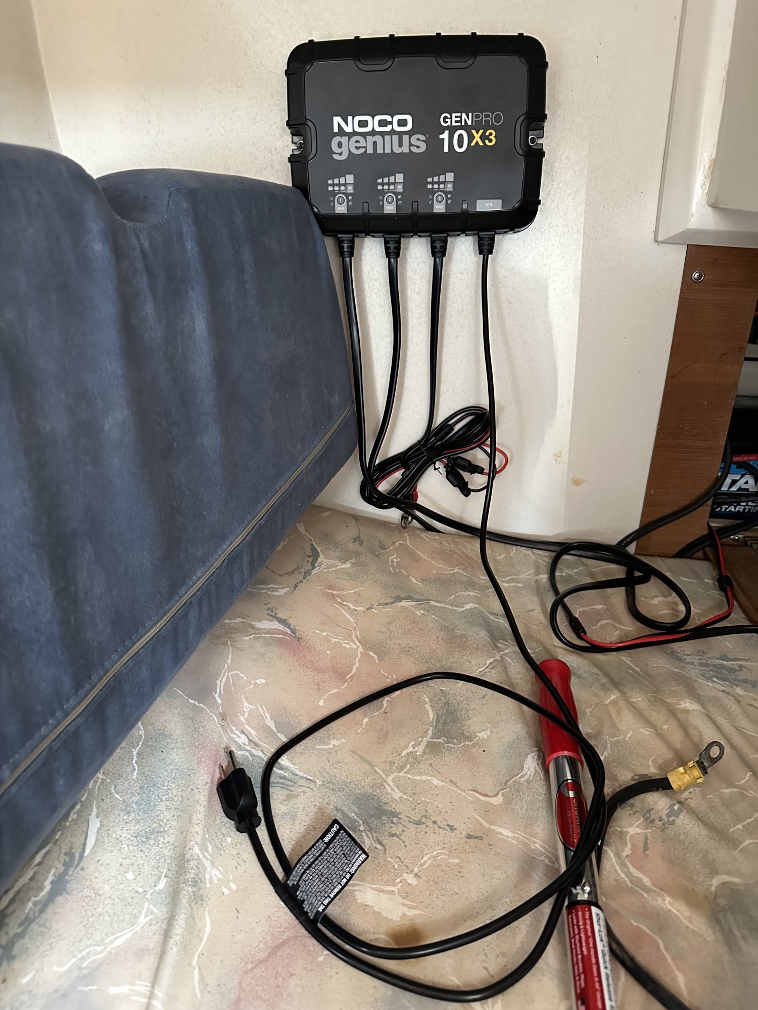

It’s in the quarter berth on the aft bulkhead. Here is a photo.

Thanks for the quick reply! Wow, that's an odd place to mount it. Maybe you can find a better place, say, in or close to the battery compartment, and have someone hardwire it to the AC panel for you?
Sep 13, 2021
159
Catalina Capri 26 280 Lake Jacomo

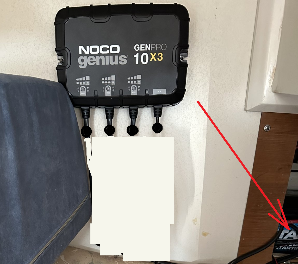

That’s actually right between the battery compartment and the panel. The wires you see on the right are coming from the batteries.
I see. Are you handy with electrical stuff on a boat?

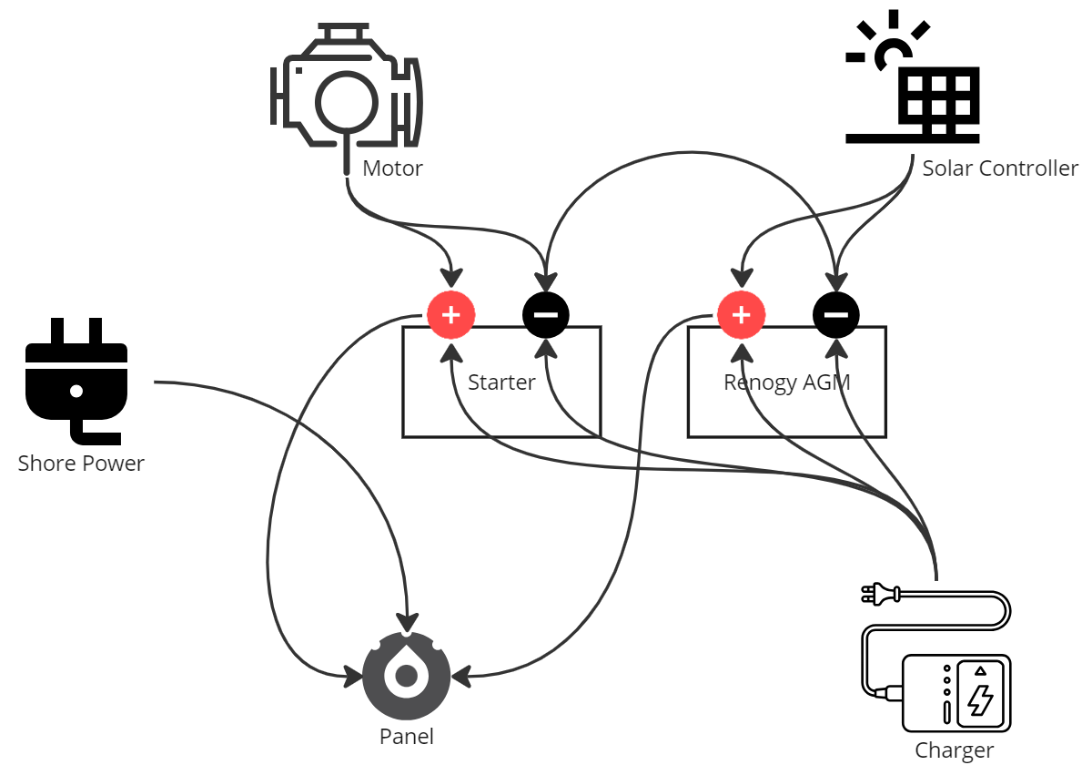

You have a bit going on Chris in that diagram.
First let me share a great link.
@Maine Sail has shared a wealth of sailboat electrical knowledge here in the forum Musings With Maine Sail
and on his website in the above link.

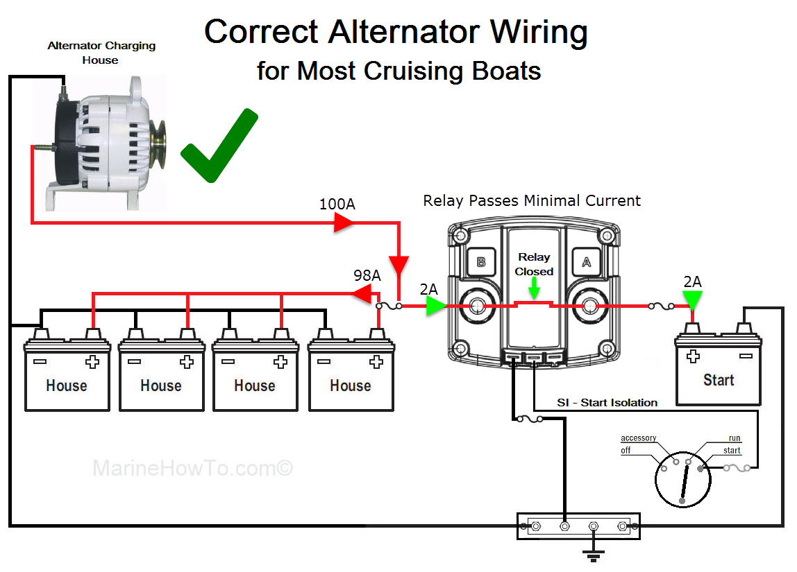

Your diagram is a great place to start. You show multiple charge sources going to different paths. This can be a problem.
Let’s explore just the alternator for now. When I run my engine I want the charge power to be shared among my batteries. Generally the house battery is more depleted so I want to get it back to full before I stop for the night. When it is full I want to spill the excess over to the start battery. For years owners would use a manual switch to flip the charge from battery to battery. Being sailors they would sometimes forget. One or both batteries would be depleted. A clever solution was designed. An automatic relay placed between the House and Starter battery. Problem resolved.
Now both batteries get charged and sailors can focus on the thousand other issues.
There are many solutions to these electrical challenges for boat owners in the two links above. They are designed to make the system work and keep you and the boat safe.

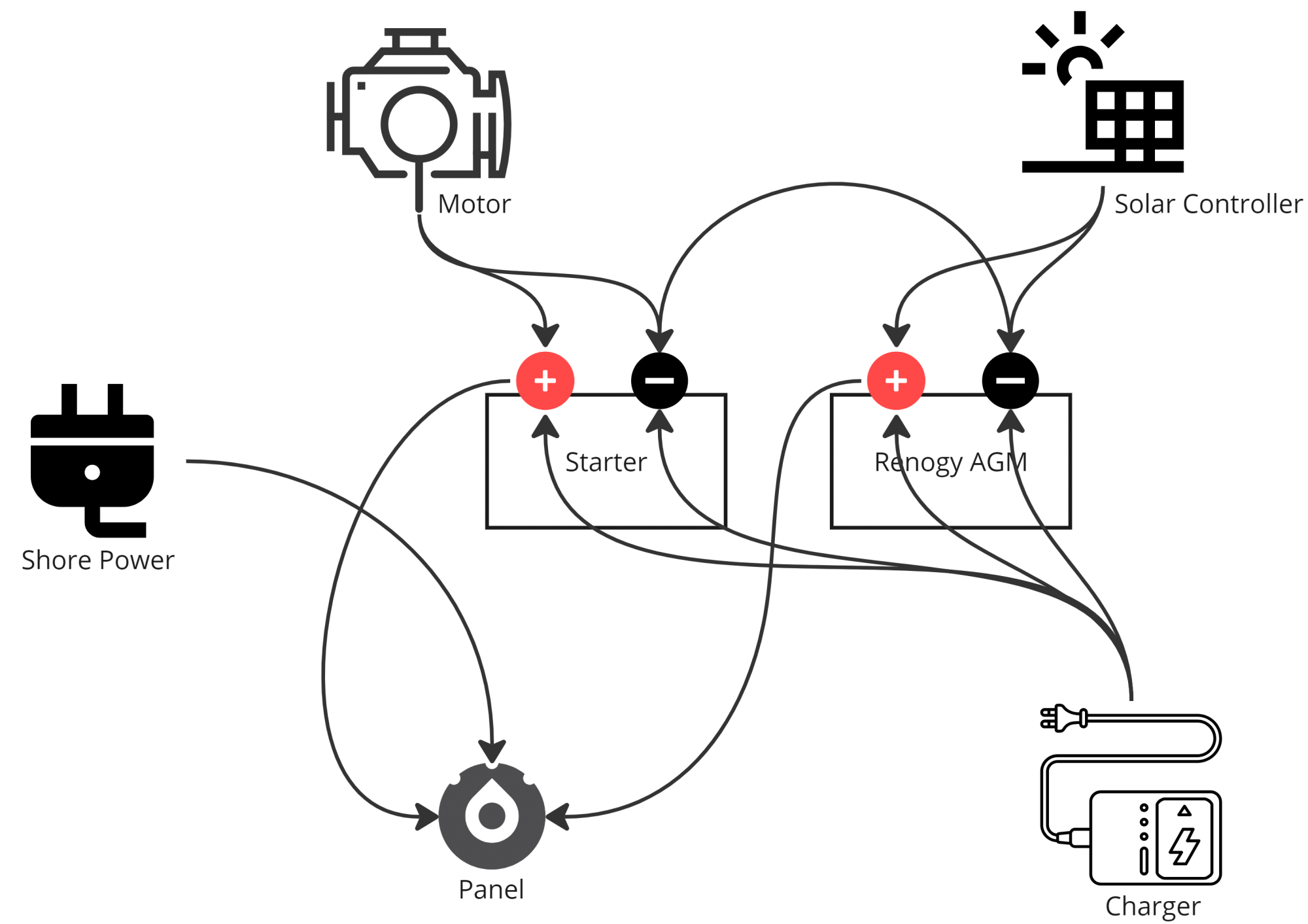

Here is a bit more information about what is going on in my diagram.
* The motor (outboard) is connected directly to the starter battery. I don't need to switch anything on for it to start.
* The charger is connected directly to both batteries independently. The charger is not connected to the panel or shore power system. It must be plugged in separately.
* I do need to use the 1/2/All switch to use the house lights and various accessories.
* Shore power works for the 110 outlets when plugged in.
* The solar controller (for 10watt trickle charger) is connected directly to the house battery. This is the only piece of this system installed by me.

I guess I'm looking for a couple of pieces of feedback: 1) do you see any immediate major problems with this configuration that I should be concerned about, and 2) are there any straight-forward changes I should make that would be an improvement. I realize that in this setup my trickle charger is only charging the house battery.
Here is a description of the current state of things as shown in the diagram:
* The charger is connected directly to both batteries independently. The charger is not connected to the panel or shore power system. It must be plugged in separately. (for now I'm thinking that I will plug this into an outlet so I can use the shore power plug for charging when needed)

I would like to recommend that you get rid of this current diagram and draw a DC diagram to the various points of connection as others have suggested. Should help you separate DC voltages from AC voltages and their source of connections also you might take a glance Mainsails advice galvanic corrosion and grounding.

I see your battery peeking out ...

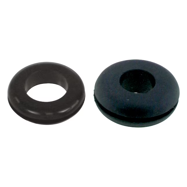

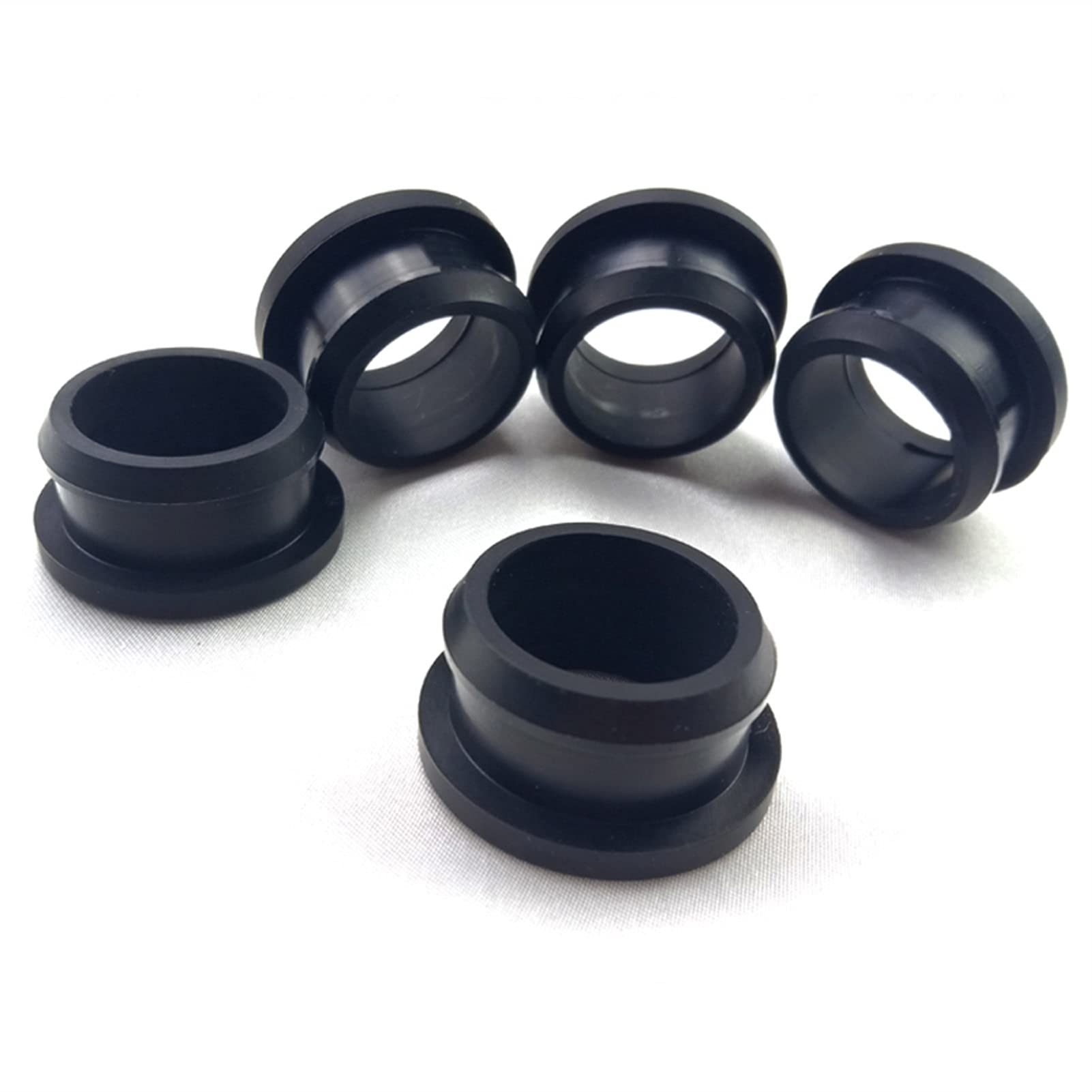

You could route the wires through some holes to clean that area up (Like I mocked up in this pic). If you do, put some bungs on the holes so the figerglass edges don't eat up the insulation on your wires. You can buy these at Lowes in the "hard to find parts" drawer in the hardware section (the pictures are hot links)
or like everything else, they are available on Amazon...

I am far from an electrical expert, especially 110 shore power so I might be misinterpreting something here. First remember that it can kill you.
Your diagram has shore power (110 AC) and your batteries (12V DC) both going to one panel. Do you have a combined panel?
I assume the switch and breaker labeled “battery charger” you said were there are in the AC panel (or at least the AC side of a combined panel). In the short run, it sounds like what you want to do, in effect, is cut off the plug to your charger and hard wire it to the switch and breaker labeled “battery charger”. That sounds like it should be pretty straight forward after reading Don Casey's book referenced by rgranger.
Do keep in mind that the manual for your charger says "7.) A marine (boat) battery must be removed and charged on shore. To charge it on board requires equipment specially designed for marine use." I don't know why they tout the fact that it is an "on board" charger and then put that in the manual. Maybe only the lawyers talking but it is there.
