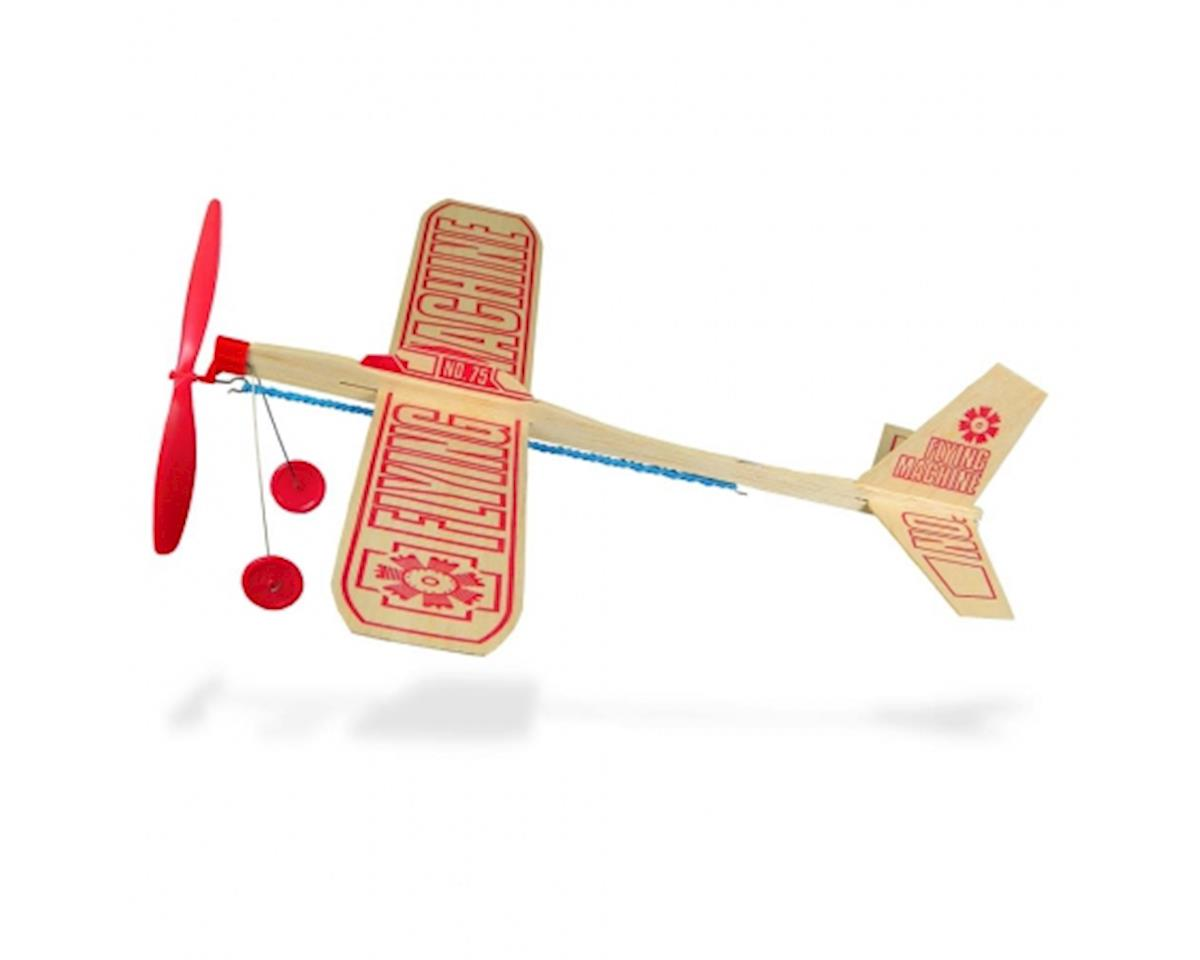

Maybe the propeller winds a spring and the spring drives the vehicle. If the prop is as efficient at winding the spring as pushing against the wind, similar performance parameters should be achievable in any direction. Like a self winding watch. When the wind blows, the spring gets tighter, when the car's going, the spring drives the car. Both could even happen at the same time.
